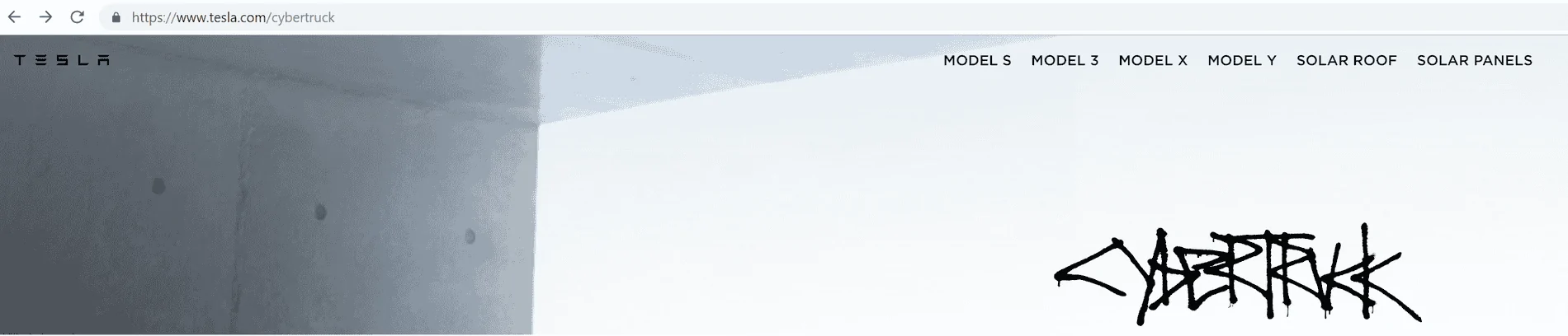

Anyone else go to Tesla.com recently and cant find the CT link in the top? but if you type it in the page is still there? I tried it out to see if any news about the motors there, no update.
Discussed lots. Use menu icon (3 horizontal lines) in top right corner. Still there.
