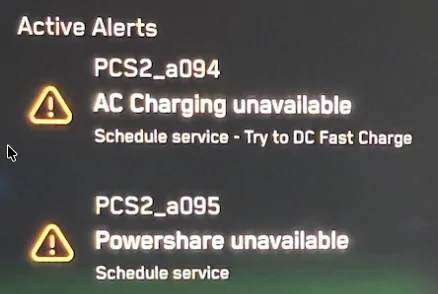

Mine just faulted as well (May 22, ~10:30am). Service scheduled for May 29th at noon. Free supercharging until then. Foundation, AWD, VIN ~8500.

I got a notification that the interior outlets were disabled. I thought maybe a PCS failure at first.
Turns out, there was an Anker powerbrick in the backseat floor that had redbull spilled on it without me knowing and smelled like burning plastic. I'm glad Teslas don't use cheap blade fuses like ICE vehicles and the GFCI is able to be reset by a control circuit. I guess that's why you never hear of Teslas catching fire randomly. Unlike many GM, Ram and Ford trucks parked. They often issue warnings to not park their trucks in your garage. 🤣

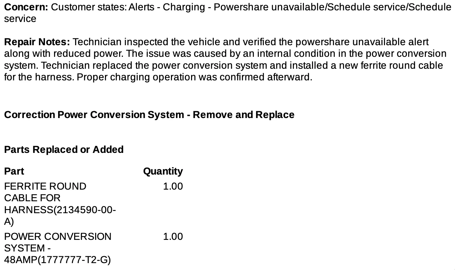

Update on 2026 06 01: Dropped the truck off at Centennial Colorado Service Center on May 29th and got a Model X loaner. Fix completed on Monday, June 1st, and I picked it up around 1:15pm.
Description of work from invoice below ($0.00 charge):
Tesla Cybertruck My bed outlets just shut down 1780345696510-g
