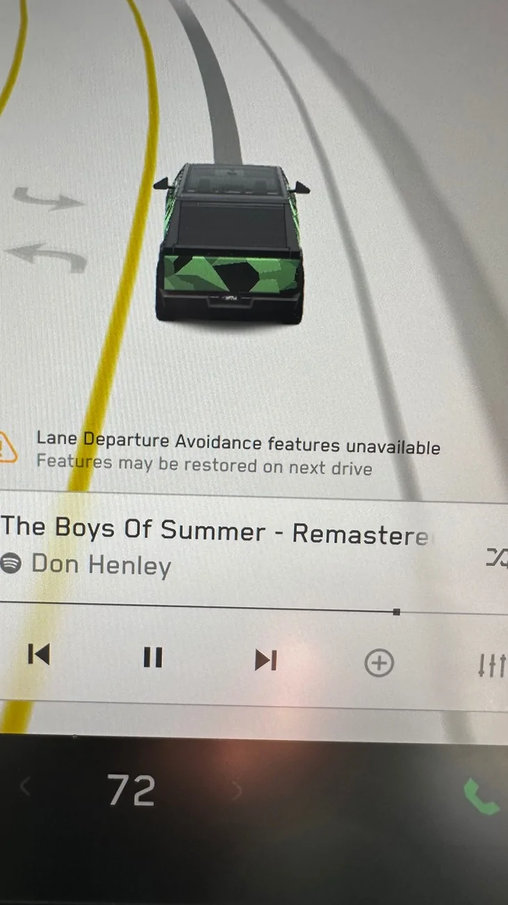

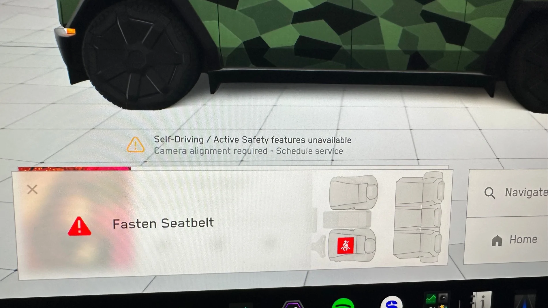

It happened to me 2 weeks ago cleared cameras 3 time, and das this is my screen. Sti no luck.
Camera previews all look ok?
Fronts aren't showing an unusual amount of glare sheild?
By DAS you meant the service mode DAS reset?

Yes, it all happened when I was sandwiched in by 2 lifted pickup trucks. The screen went red and emergency flashers came on. Like it freaked out!
