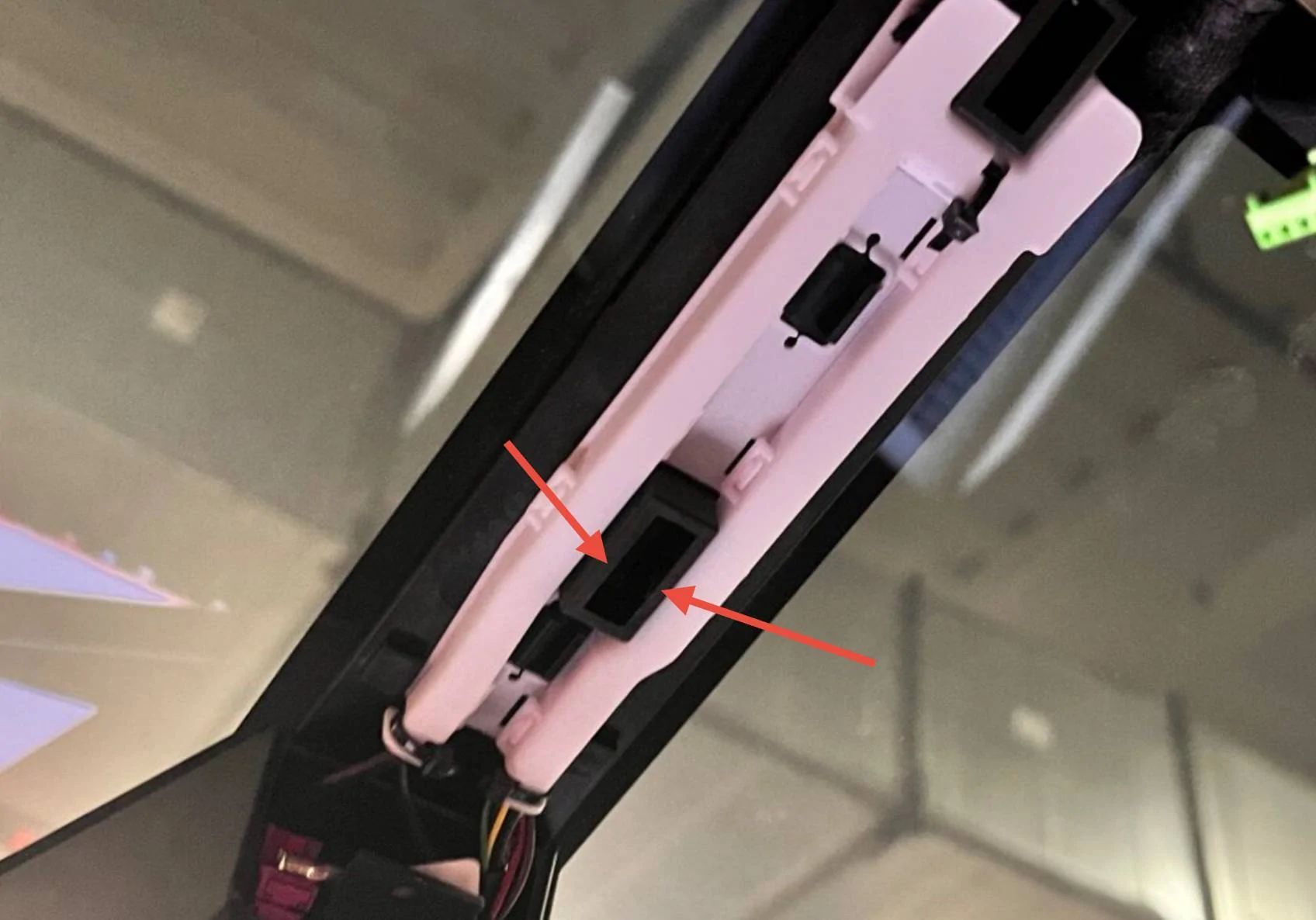

Take a look at the dimensions of the lower receiver, you may find that it is spread apart which is allowing for loose fitment. I just had mine down the other day and that’s what I found. (See attached photo)
Now if I can figure out what that part is and how it is attached to the windshield.
