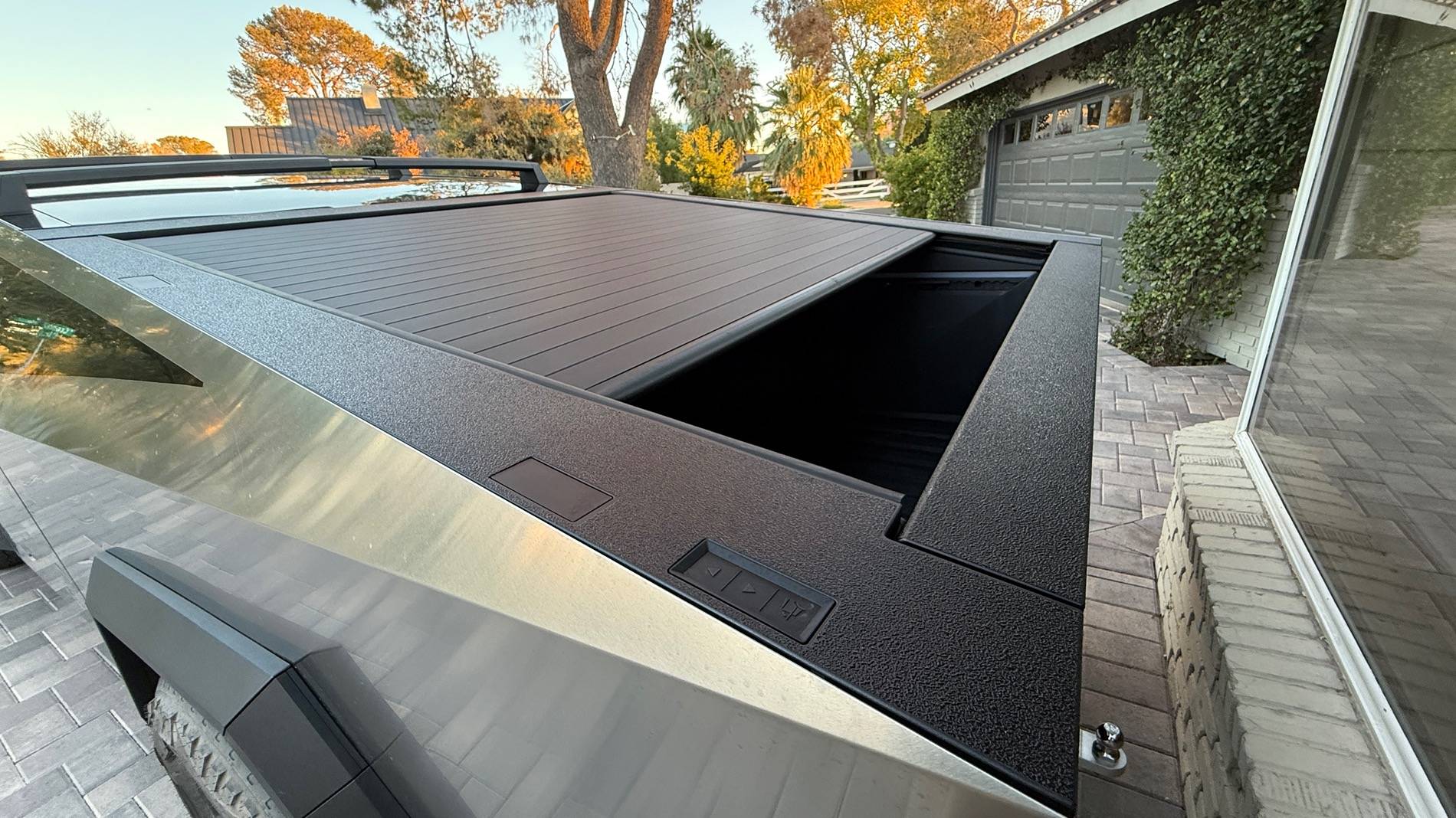

My Cybertruck vault tonneau cover healed itself by recalibrating!
ViewyHippo
Sep 25, 2024
NY state
Cybertruck, Model 3 LR

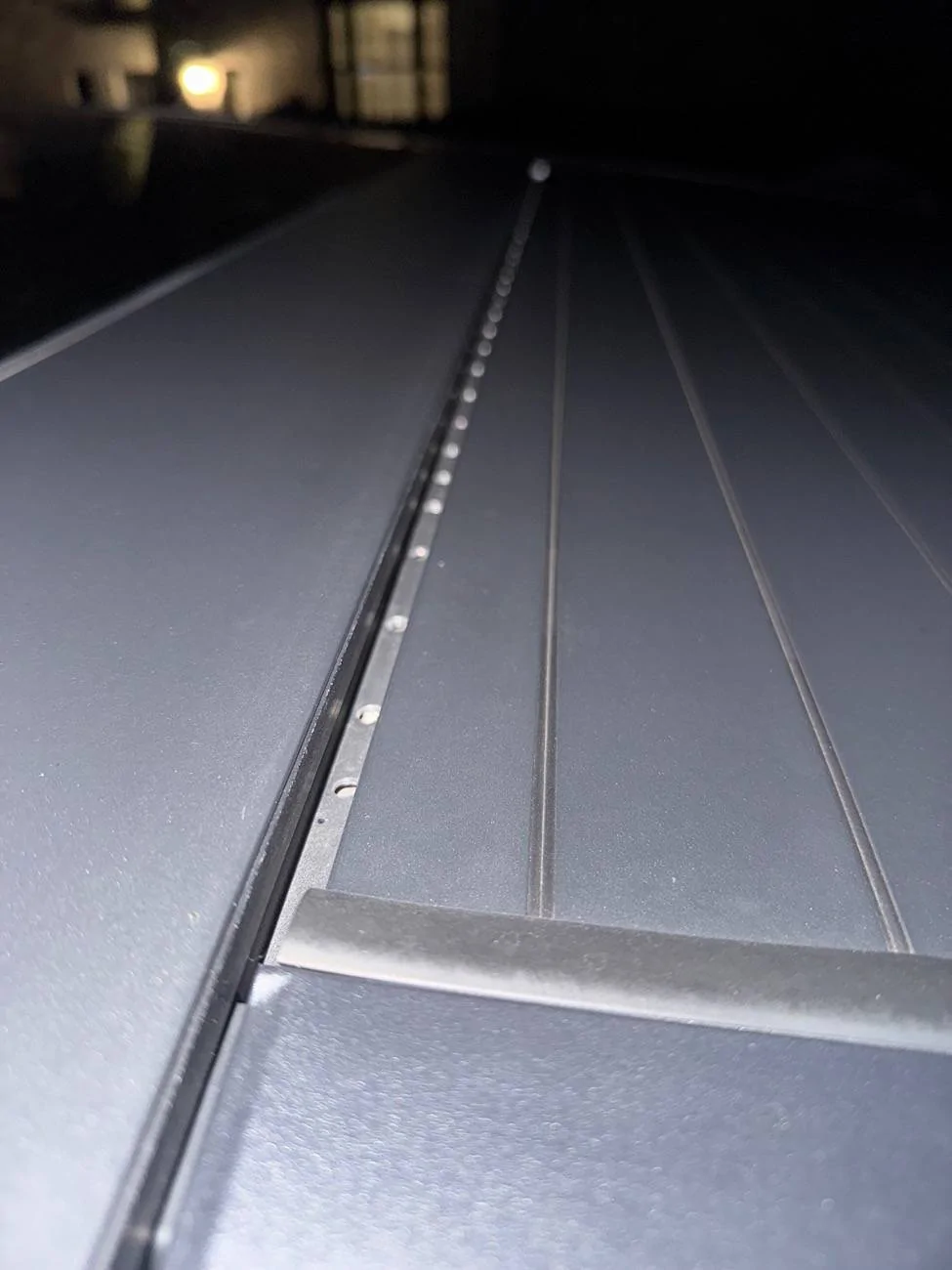

What do the rivets look like? Mine looks like this. Would adding a slat solve a leak?

Yeah, I don't recall seeing the rivets at delivery. I noted them some time later and thought "hey how did I miss that". I need more slats apparently...

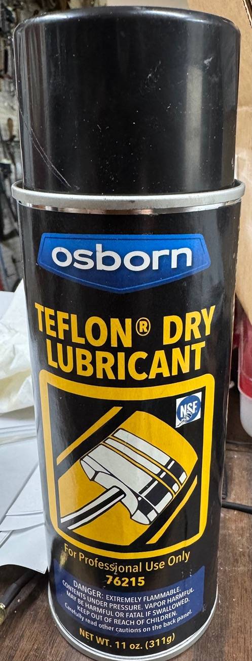

Fixed mine with Teflon dry lubricant. We’ll see how long it lasts. My problem is that I live on a farm and just hauled 2500 pounds of dirt.
after delivering the dirt, I hit the entire town track area with compressed air. However, during spring it’s extremely dusty here and more dust got in the track area. The Teflon lubricant definitely helped the cover, not activate the pinch sensor.
This is for the Tesla design team: I hypothesis that adding a brush inside the tonneau cover which brushes out the dust from the track every time it is activated well resolve the problem of too much resistance.
