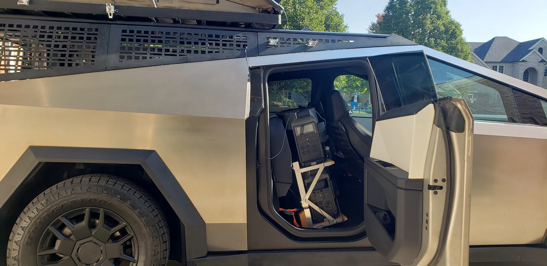

Here's another shot of the dual Delta Pros installed and operating in the rear seat area of the cabin.
Tesla Cybertruck My EcoFlow Power Station Range Extender Solution CT Delta Pros
As mentioned earlier, the Delta Pros are normally kept fully charged from a 750W DC input from my 420W solar system which has its own 2.5 kWh 24V LFP battery. As long as the solar battery's SoC is above 50% the Renogy Rover charge controller will connect the solar battery to the XT60i DC inputs on the Delta Pros to charge them.
The fridge and Starlink are powered directly from the Delta Pros' 12V DC outputs. The electric blanket and BougeRV A/C are powered directly from the 24V solar battery. At the end of each day, the solar battery will have at least 50% charge to power blanket or the A/C overnight. If that's not case (poor solar production for a couple of days), I can power the blanket or A/C from the 120V AC outlets on the Delta Pros or CT.
Solar production averages between 1.7 and 2.0 kWh daily in the fall and spring in Arizona, which is normally enough to supply power for our camping accessories independently of the CT.
