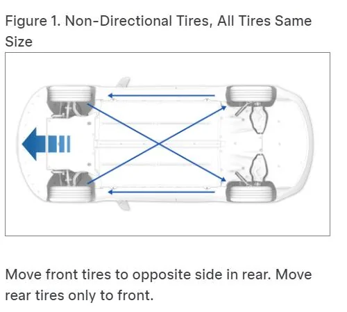

Was an X-Pattern rotation the right call or should I have done a forward cross? Anything else I did wrong?

Forward cross is generally how I have always done it. Just a point to note, if you are only doing an x-pattern, you only need 2 jack stands. Put the stands in the cross opposite sides and use the Jack to stabilize the truck from teetering.

Nice thanks for the tip! I think I'll do the forward cross on the next round.
