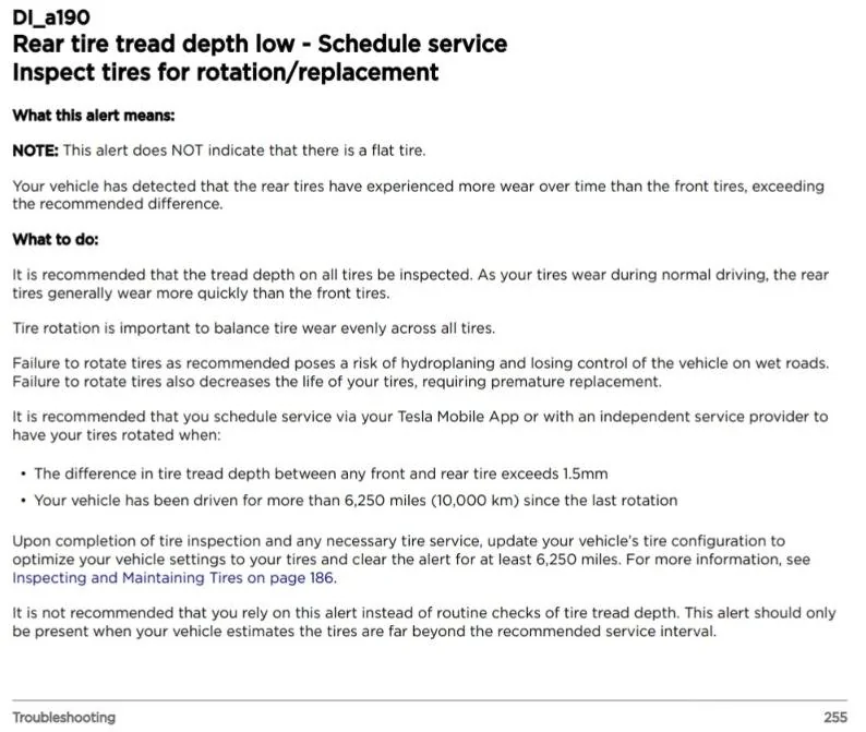

I looked in the manual but didn't see any recommendations so I guess they want you to go with the tire manufacturers recommendations (eg directional or not making the big diff).
Found this interesting warning message that mentions rotation. Likely track the rotation speed diff / delta between the front and rear.

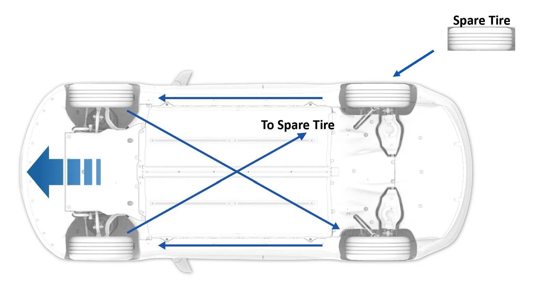

Rearward cross with a spare.
With a spare tire, one could rotate tires like this.
The good news, it is easy to do with only one jack (if you do it yourself) and theoretically you can get 25% more tire life.
The big question is when you need new tires, do you buy 5 and keep a spare that can be rotated in or just buy 4 and stop rotating the spare in all together?

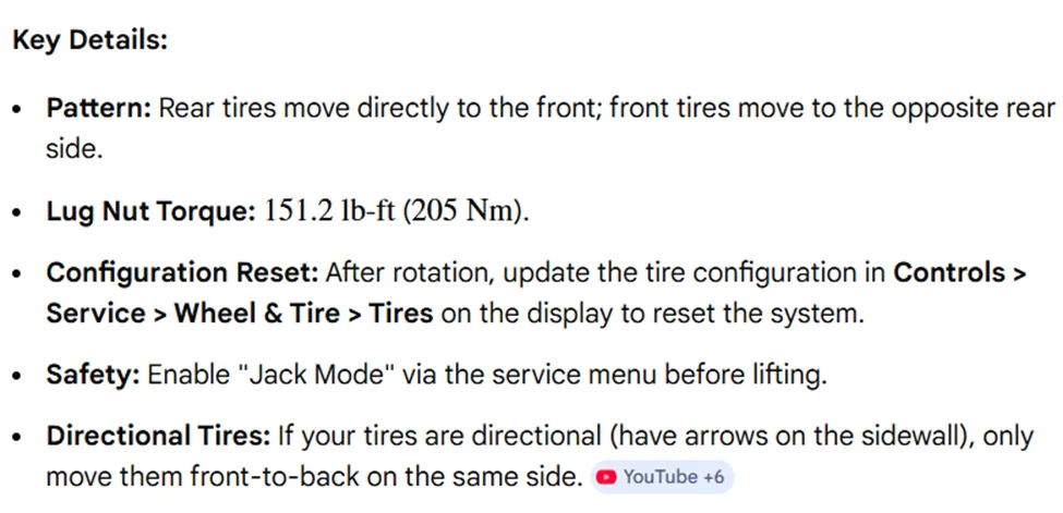

Here's what I've come up with, first picture directly from Tesla
Tesla Cybertruck What is the ideal tire rotation pattern for the CyberTruck (AWD/RearStear) 1773296432009-kz
FASTEST SIMPLEST WAY TO ROTATE TIRES:
Place Jack Stands on 2 rear tires, and remove both tires.
Then jack up front left side (drivers), and remove tire. Place left rear on front left side
Place removed tire on right rear tire (passengers side)
Move jack to front right side (passenger), and remove tire. Place right rear on front right side
Place removed tire on left rear tire (drivers side)
