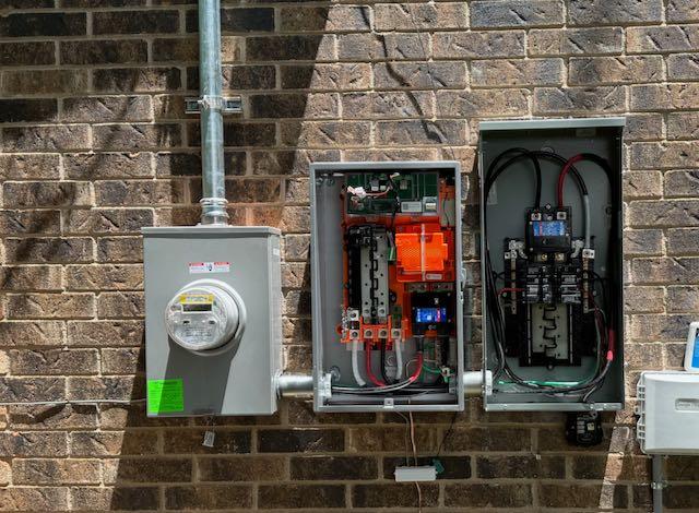

I recently completed my PowerShare installation, after a few months of waiting (the delay was due to the utility company).
The work was by Smart Charge America, and they did a great job. My cost was $7,700 but that included whole new electrical service, since my 80's-vintage equipment was inadequate.
Tesla Cybertruck My PowerShare Experience IMG_0107

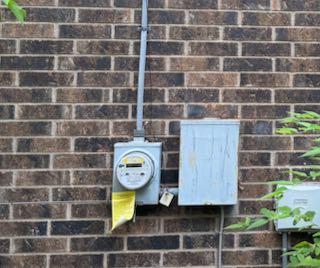

Everything outside is all-new:
Tesla Cybertruck My PowerShare Experience IMG_0115

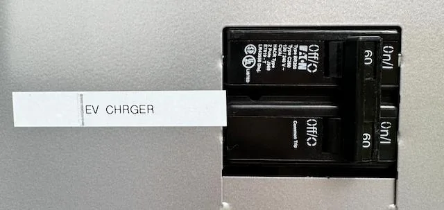

Tesla Cybertruck My PowerShare Experience IMG_0186
I guess they did save me a little money in lettering by leaving the "A" out of "CHARGER".

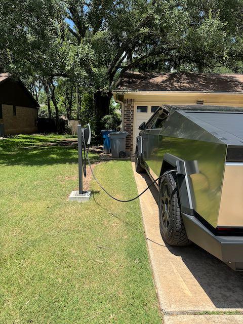

Tesla Cybertruck My PowerShare Experience IMG_0133
The finished product!

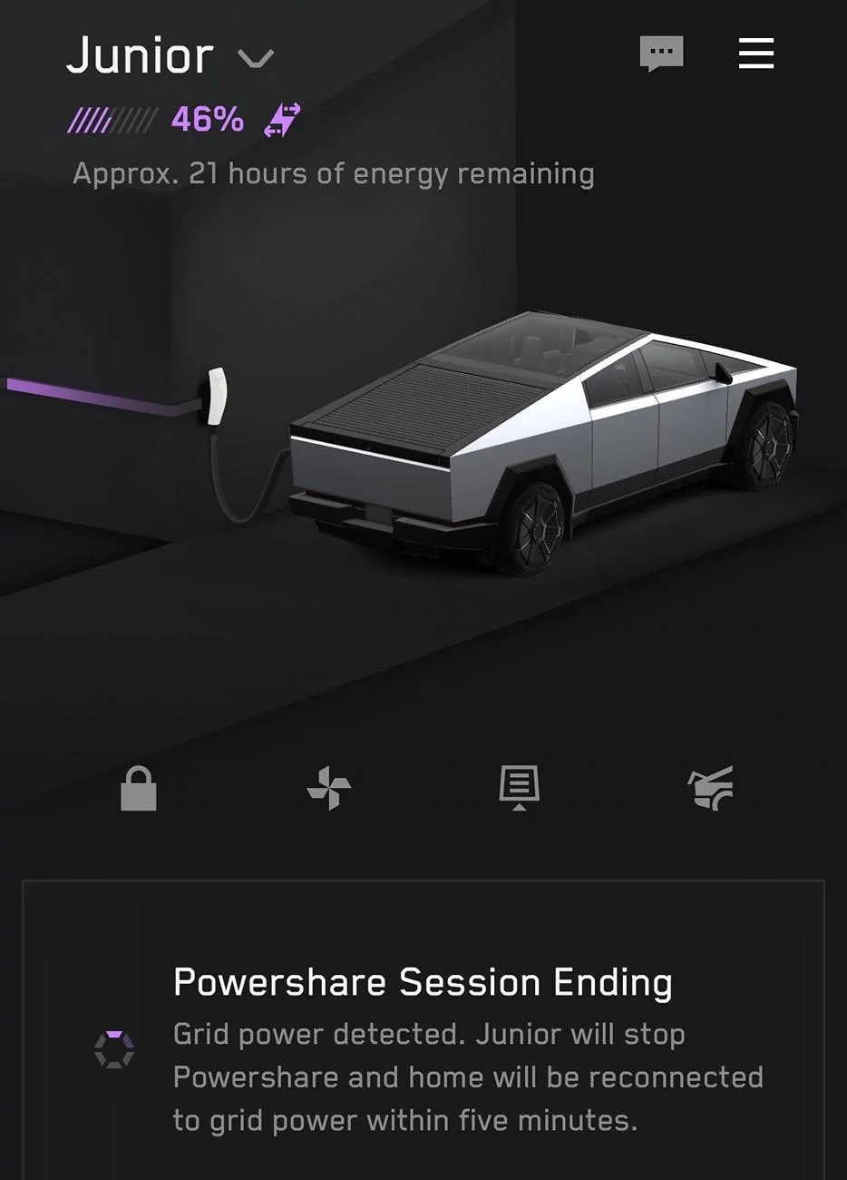

I thought Hurricane Beryl would give me a good PowerShare test, but in Austin we didn't even get rain. Therefore, I performed my own test:
The switchover took just a few seconds. Note it initially quoted 8 hours of runtime, but that was with the AC running and only 30% SoC available. With the AC off, the time extended to over 20 hours:
Tesla Cybertruck My PowerShare Experience IMG_0194
and if the truck was charged to 80%, those numbers would be double.
PowerShare waits for 5 minutes after power is restored, but that switchover was NOT seamless and the power was briefly interrupted again, so don't bother resetting your clocks until you're back on grid power.
All in all, a successful test!
