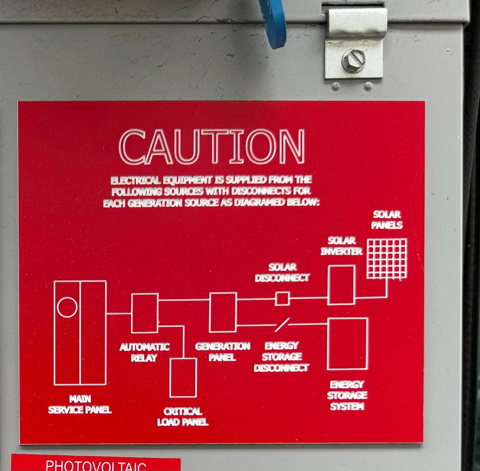

Can someone tell me if I need anything else to PowerShare with my house, battery backup and solar system? This is the installed diagram of what I have with the system I had installed last July. I guess I need direction.
Tesla Cybertruck Powershare Gateway Install Experience and Explainer IMG_7035
