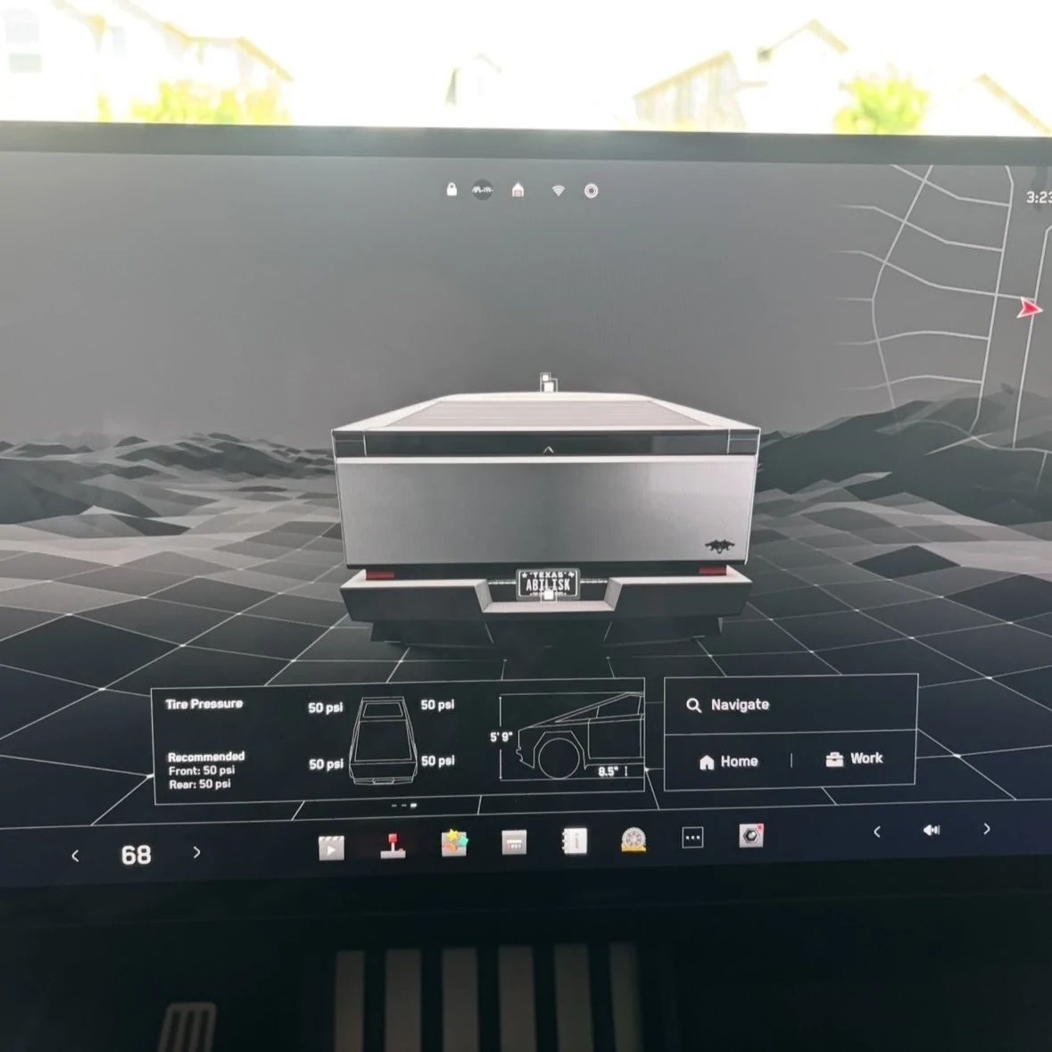

Hopefully the service center airs up the tires lol
I would interject that all my tires were still 49psi but the cold of winter changed it to 43/44. Its important to consider that as if you air them up to 50 in the cold they will be well over when the temp rises
Ivessm
Stew
Jun 28, 2024
152
228
PA, USA
2022 MYP, 2024 MX LR, 2024 CT Foundation Ser
I believe the engineers take into account the added pressure of the tire when going from "room temperature" to on-the-road inflation pressure increase when they recommend the COLD inflation tire pressure. As long as my tires have been idle for a few hours I target the recommended COLD inflation pressure regardless of outside air temps.
I'm always willing to learn from others so chime in with your comments. I don't bruise easily :cool: .
Just my observations from living in Canada 😆
Yah, and so you need to let air out as needed when the weather warms up.

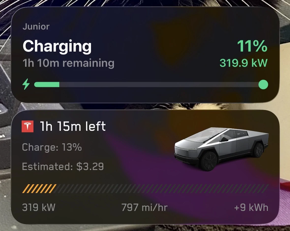

On the plus side, I think my PCS is good
V4 #FTW
CyberGus I believe the PCS doesn't come into play during DC fast charging like from a supercharger but rather from an AC charger like your wall connector. I believe you have 2 of these PCS units in the CT, one for each side (L1 & L2) of the 240 AC circuit. When one fails you are generally limited to 1/2 the max amps you normally pull from your wall connector for charging such as 24a on a 48a charge circuit. The failed PCS has no affect on the DC fast charging from SuperChargers.
Please correct me if I'm wrong.
10,236
33,889
The PCS (“Power Conversion System”) includes a pair of 24A AC-DC converters, which are the most common failure. But, that’s not all the PCS does, so theoretically a malfunction could prevent DCFC.
May 27, 2024
4,520
5,496
Going full nerd here. (before coffee)
DC fast charging bypasses the PCS entirely and is controlled by the High Voltage Controller.
However, the HVC should require positive verification of PCS and ACJB states before enabling fast charging as well as HV isolation.
However, those checks likely mirror the ones needed for engaging the HV system for driving.
So, if one managed to drive to a Supercharger without a 48V or HV warning, any active PCS failures likely wouldn't prevent charging.
