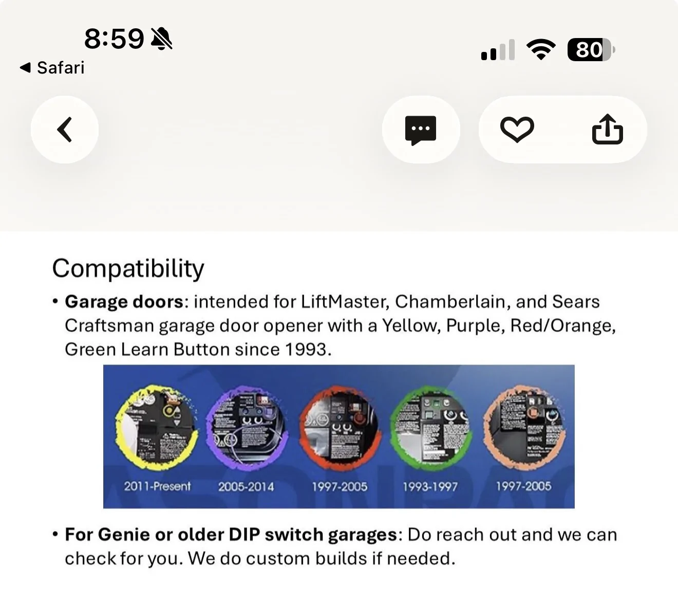

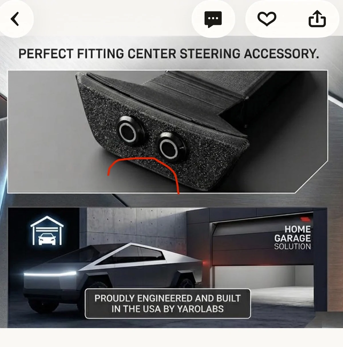

In the interest of helping to provide constructive solutions though, here are a couple suggestions. I didn’t buy one of these so I can’t really give an impression of it, but I saw this on Etsy which looks rather interesting.
https://www.etsy.com/listing/449360...ated-garage-door?ref=share_ios_native_control
I wouldn’t have chosen round buttons there but the mount location is pretty cool.
also, if you have an auxbeam or similar like I do for controlling other stuff off the frunk powerfeed, those switches can be set individually to momentary so if you were to hardwire one to your garage remotes to the Auxbeam controller and plant it next to the buck converter or Auxbeam brain under the frunk tub, you’d have a fairly slick button solution from within the cabin.

Yeah, really good design … right up until those circular buttons. Why would I want my steering wheel staring at and judging me all day? 🤣😂🤣😂
Tesla Cybertruck MyQ is terrible, does no one have the guts to tell Elon IMG_3745
Unintentional anthropomorphism aside, this is a very clever solution and looks like they can customize for compatibility to suit your needs. Great find!
