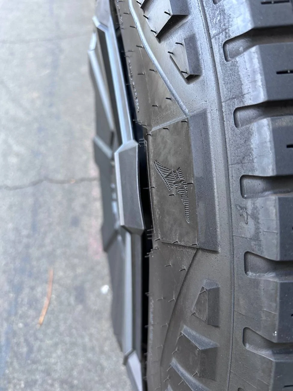

I checked pressures early morning ? and don't do towing. I presume towing would add weight to rear wheels. The rubbing occured on the right front wheel. The 4 wear spots were tabs next to each other.
The rubbing only occurred on the right front wheel? And all four wear spots were adjacent to each other? It sounds like that wheel cover either had a manufacturing defect or it was installed incorrectly, as well as being under-inflated. Often times problems like this are caused by the "stacking" of multiple smaller issues, each of which is thought to be insignificant in itself. Others are reporting no problems, so you have to ask yourself, what is different about yours vs. all the people with the same product but different results.
I mentioned towing because towing increases the side loads on the tires, which naturally increases the side displacement of the sidewalls (and far too many people don't run the recommended towing air pressures when towing).

Given the tight clearance (although 1/2ā€ does not look tight in non motion) when the wheel and tire flex during a sever compression event (bad pothole for example) the gap goes to less than zero, the wheel cover jams into the tire. Given the damaged area is localized, four sprockets, i would think it was a severe pothole type of event. Keep in mind i am not blaming the driver, this type event is going to happen no matter how ā€˜good’ of a driver you are, no matter how ā€˜good’ the roads are, reality is the cover, tire, wheel, suspension system has to be robust and withstand these types of events as this type of event is common albeit may not be everyday, every week, or even every month the probability is too high to not design that type event into the system. Not to mention this is a truck and is going to be prone to be in difficult terrain, it might be a monthly, weekly or even a daily event.
The visual showing the divot formed in the tire wall should scare the hell out of everyone as sidewalls are one of the weakest points in a tire and are prone to blowout which can be catastrophic at speed.
in my opinion these covers should be removed immediately due to safety concerns and a redesign or alteration be put in place immediately. It is not worth a fender bender much less someone’s life especially over a wheel cover.

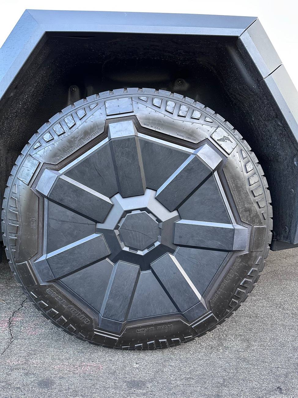

Hope these photos help.
thanks! Stopped by a delivery center a couple weeks ago on a completely unrelated matter and casually asked when I would get the covers and they kindly checked and saw they had an extra set! Put them on myself and super easy to do but the spokes look like they go up further than yours. Same gap between the rim and the cover but worried they gave me an old one?
Those covers do seem a little closer to the tires and slightly higher up.

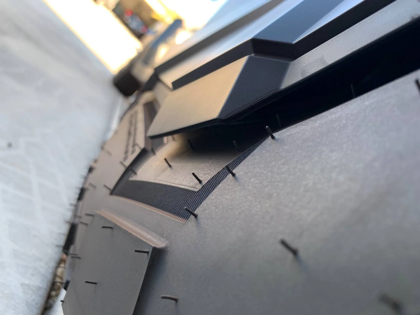

This picture is of the best case scenario. The top of the tire is where there's at least amount of load and the tire will be flexing less. The wear is going to happen at the bottom where the tire is compressed and bulging outwards. I'm not saying that yours touch at the bottom I'm just saying that's where they're most likely to touch.
Here is a picture of the same wheel taken from the lowest position of the tire looking up. The clearance is still pretty good.

I wonder if a piece of foam tape on the back of each nub would solve it by distributing whatever force occurs over a larger surface area on the tire. Eventually, with enough force the hard rubber nubs will eat through the foam, but maybe running the tires at +2psi plus adding the foam strips could manage it.

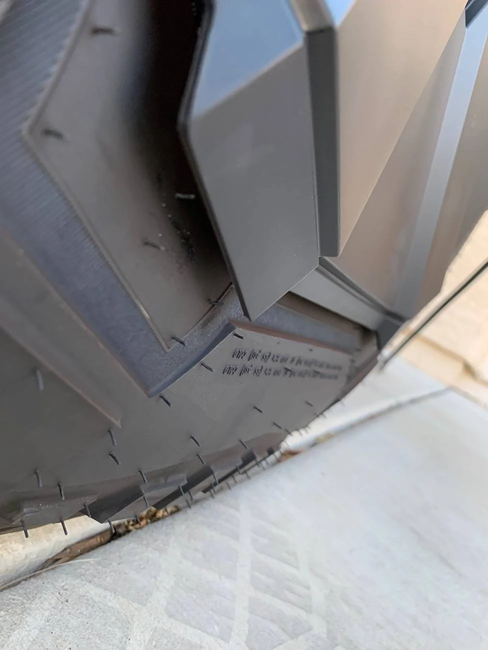

I have 575 miles on my Cyberbeast. It was the first delivered (8/19/24) in Raleigh SC that they had seen that had the new wheel covers installed for delivery.
I removed them today to adjust my AT tire pressure for colder weather. I was surprised to see that they also are rubbing the surface of the tires. The picture shows what has happened so far with just 575 miles on my truck.
Updated with more info:
Tire pressure was 47 on two tires, 48 on two others before adding air to bring it up to 50 on all tires. The wear was present on right front tire. The others seem to be ok, so it may be that some of the covers are defective. I have done no launches or even put it in beast mode and have done around town driving and one trip to a cabin I have on a forest service road. Tire pressures have never been low on any tires.
