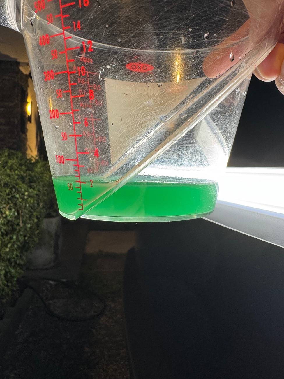

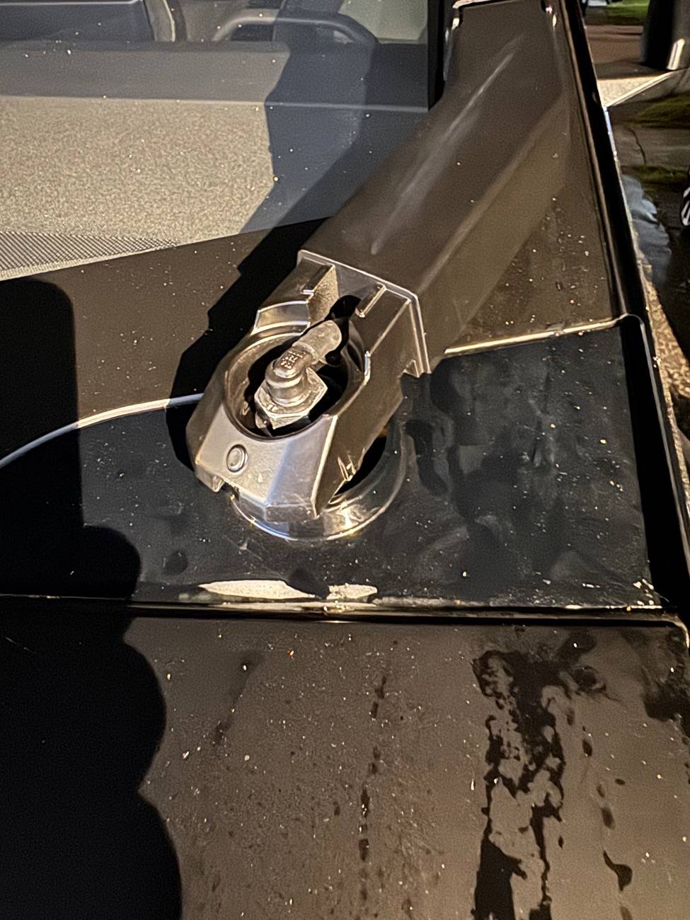

Ended up taking off the elbow connection at the arm base. While connected a flexible tube to it and running wiper on wash, this is how much water sprayed from two swipes.
In my case there is no pressure at the nozzles and it kind of leaking out rather than sprays.
If anyone wants to do the same and measure pressure or amount of washing fluid, just take off the cap from base of wiper arm and connect any flexible tube with fittings diameter.

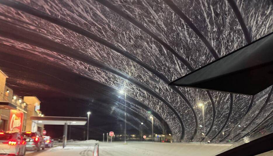

But that looks like a decent amount. Are you happy with the wash, or does it leave streaks? like:
Tesla Cybertruck No washer fluid at the blade - solved 1737574762835-kw

Does this look bad? It looks better than mine. Have you seen a video of that washing activity that looks better? Is there a "works correctly" reference?
