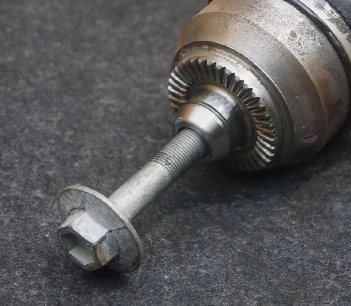

I hope so lol. All kidding aside. There have been lots of reports of them breaking with mainly stripped teeth to the hub. Instead of the conventional design where the teeth go through inside the hub.
Tesla Cybertruck Please Help - Front Suspention Noise (Service center won't help) ( SOLVED New Half Shaft ) Screenshot 2025-02-04 at 3.36.21 PM
On the cybertruck the teeth sit on the side and the bolt holds it all together Look bellow. ( its a bad design in my opinion since the minute the bolt comes lose it will strip the axel and hub)
TBF, there are plenty of disasters that a triggered by a single loose bolt :LOL:

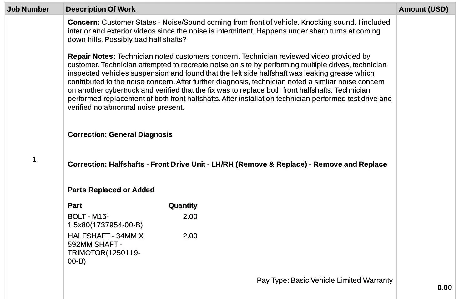

Update: I picked up the truck and the noise is gone. Tesla has an official fix they have an all-new beef-up new Tri-motor Half Shaft that will be used for both AWD and CYBERBEAST, they have confirmed that most of the leaks happen to AWDs (weaker Part) and this part is a lot more robust than what was used on both models.
Tech said my truck was the first to get it at that location Yay talk about timing!
The part number is listed below.
Tesla Cybertruck Please Help - Front Suspention Noise (Service center won't help) ( SOLVED New Half Shaft ) Screenshot 2025-02-05 at 1.17.47 PM
Thank you All for the Help!!!!

It really does, and most of the time the truck just sits in the parking lot they don't put the effort in to find the problem. It took a patient tech to actually research the problem and inspect the suspension to find the issue.
Shout-out to @Horizonvangogh for pointing me to the right direction.
