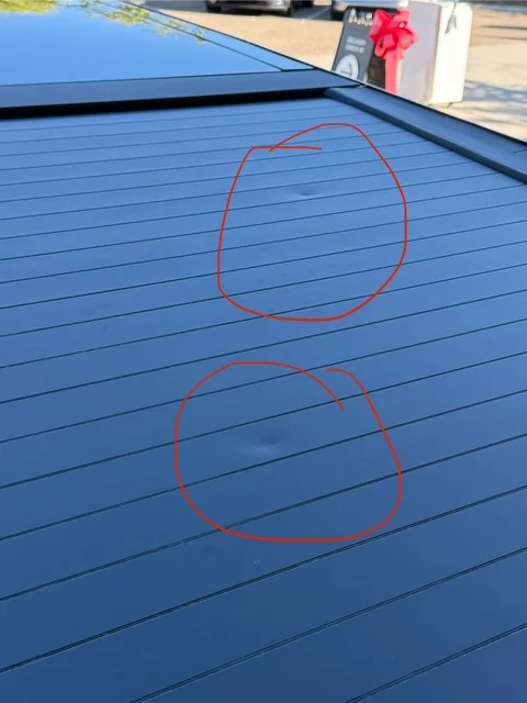

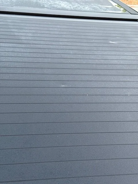

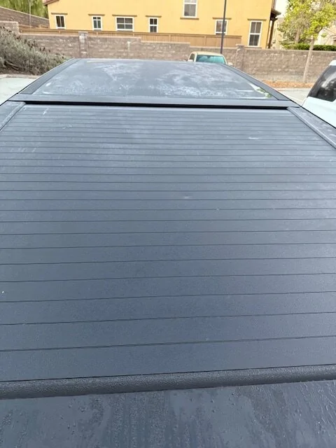

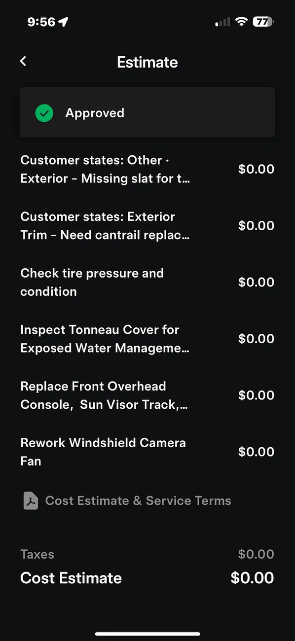

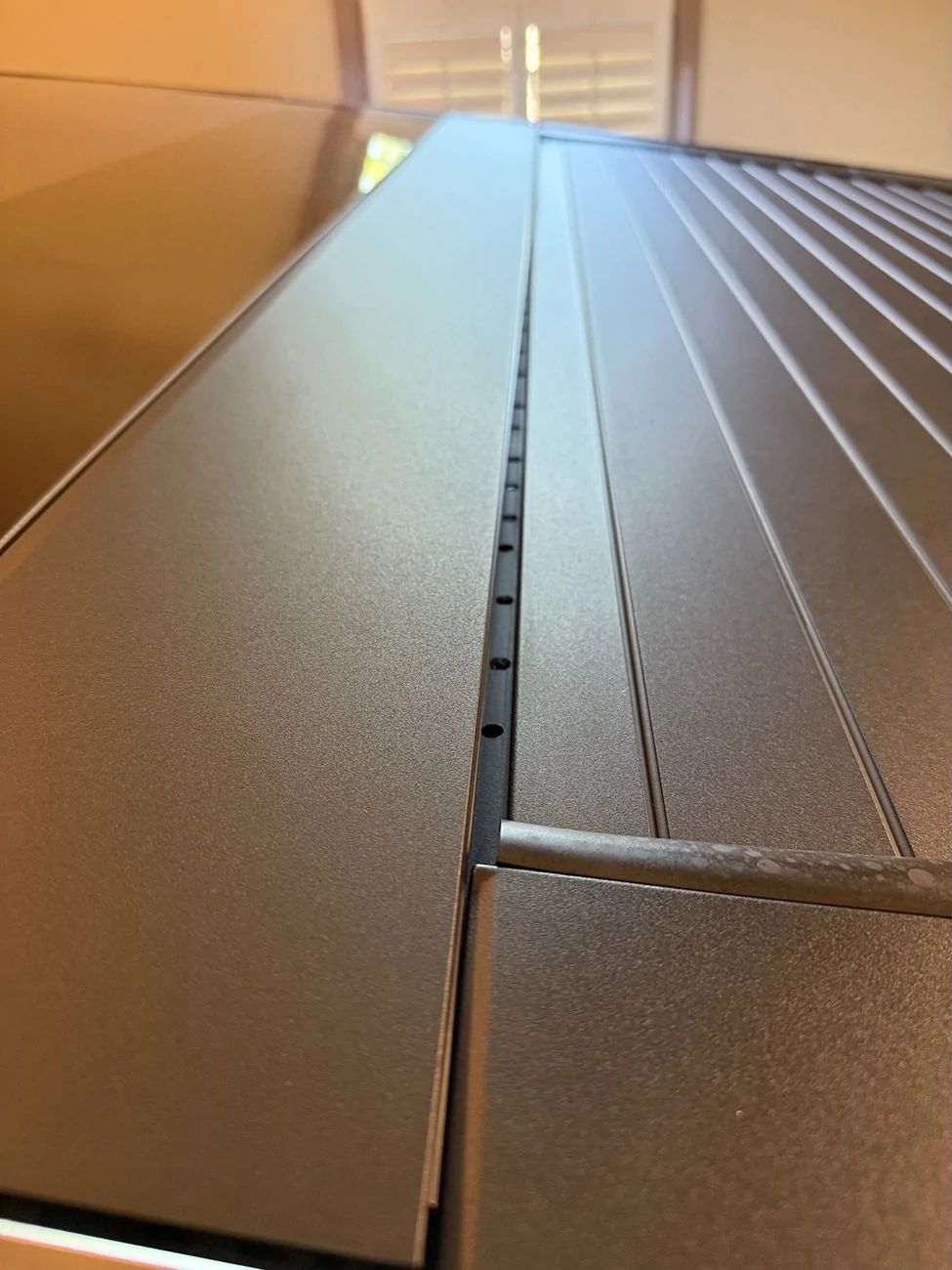

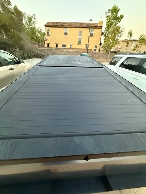

Well, I decided to go through with the repair, documented the truck prior with a short video. End result is, I don't have any complaints. They kept the truck for 1.5 days, didn't touch it the first day and seemed to start and complete the repairs in just a couple hours. The entire tonneau was replaced from what I can tell, removing the dented panels and adding the extra panel. I don't see the "bar" in the rear window when the cover is down but the additional slat is clearly there so that is nice. I have not tested for water leakage.

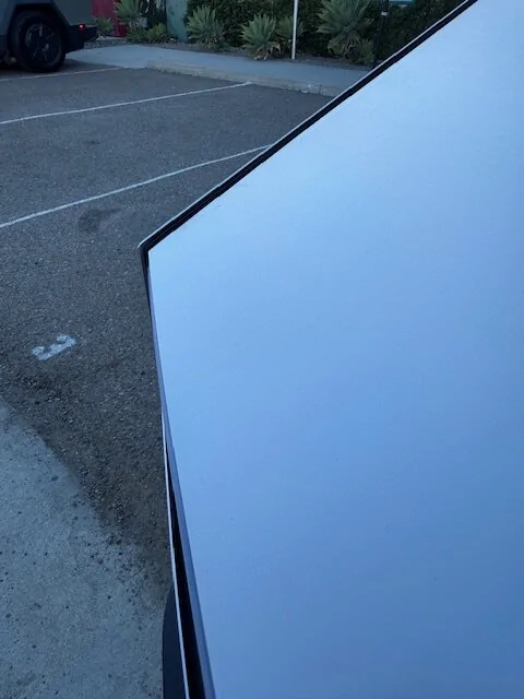

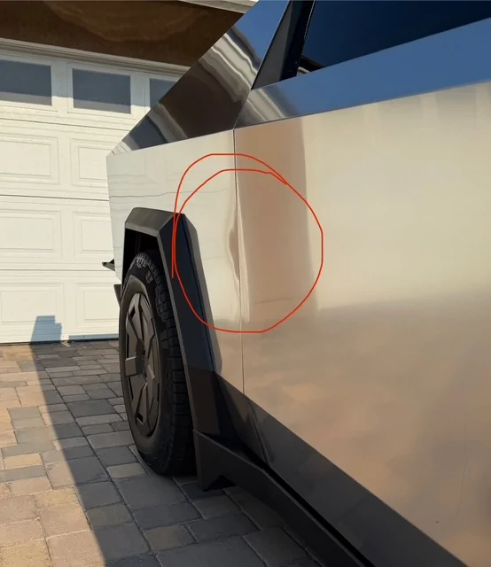

They also repaired my left front fender that came "unclipped" or was sticking out almost an inch. Although I initially requested to have the body panels looked at and repaired/replaced due to waviness, I changed my mind. I explicitly asked them to disregard my request to look at the body panels due to just too many nightmare stories online. I have noticed just about every CT I see on the roads where I live have some sort of panel issues. All my lines are good.
