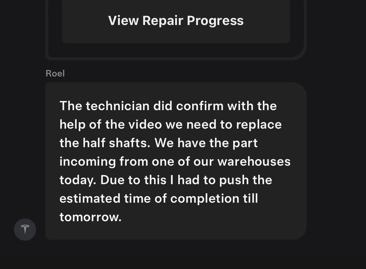

I heard that noise for the 1st time 2 days ago, driving out of a parking lot making a sharp left turn and pitching down a hill. Never heard it before and haven’t heard it since. Will have them check on my next appointment.

Yes the tech did drive with me, but we could'nt raplicate it. Service center location is pretty flat and it happens more under regen going down a hill. Truck is going in tmw hopes it gets solved.

I am aware of this brake wiping feature, but this is very diferent for me at least. Truck is goin in tomorrow and its gonna be easier now that i was able to capture in video from interior and exterior of the truck.

I'm disappointed with the service center the Truck has been sitting at the service lot since i dropped it off on friday morning, i just messaged them and they apologized for the delay. they claim they will have the truck in the shop tomorrow.
