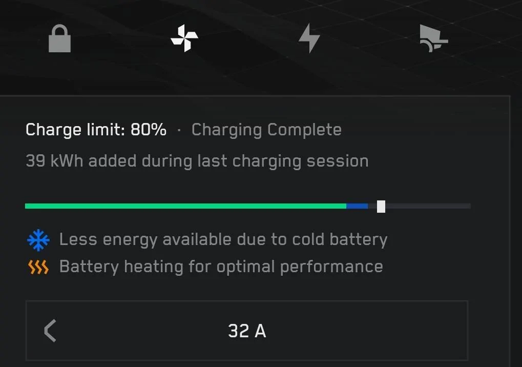

Turned on climate control. Shows battery heating in app.
Currently 43F outside, was below freezing last night.
Turned off a few minutes later. Neither increasing cabin temp nor Max Defrost resulted in battery heating message reappearing. Nor did starting a charge cycle. Nor did sending a route to a local 250kW Supercharger.
