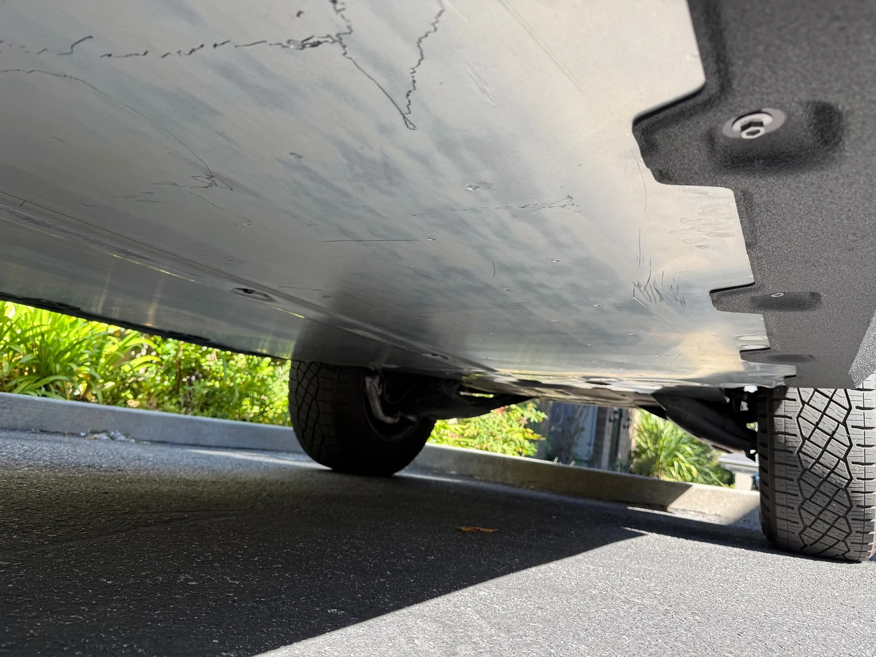

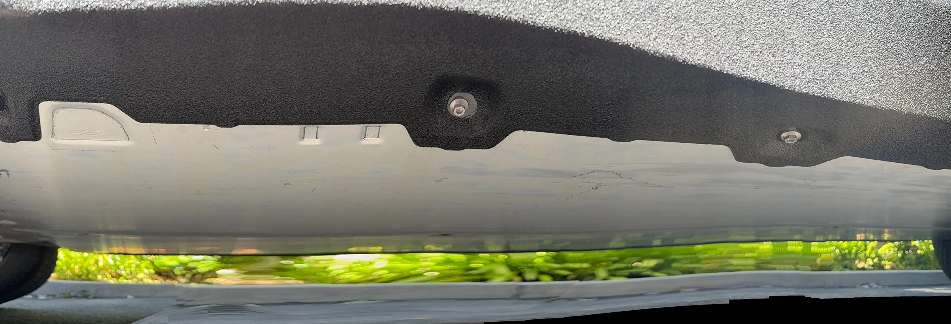

Well got the truck all washed after getting it back yesterday. Then installed the Rival front skid plate and front lower control arm plates. Looks pretty good can’t wait for next weekend trip to test it all out. Pics included, thoughts?
Nice, man!
Are the non-OEM plates just plug-and-play? Do they fit with the OEM Terrestrial Armor without any modifications?

Yeah the Rival kit was plug and play. Didn’t take long at all to install. Took the stock skid plate off, then the aero covers on the lower control arms. The only issue I had with the Tesla terrestrial package with the Rival plate is I had to loosen the two bolts where the skid plate mounts by the battery pack so I could slide the skid plate in, this made it easier. It would have been better if the terrestrial package was installed after the Rival skid plate but both ways are easily done. Absolutely no modifications were needed.
