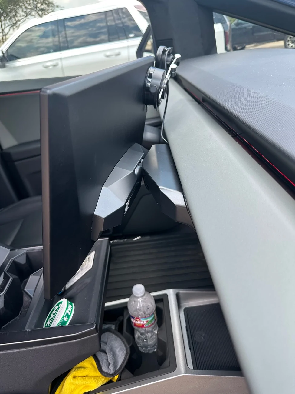

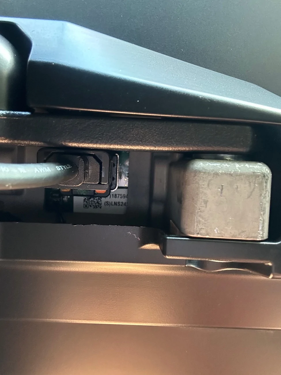

Yea I like it and think it’s worth it. Mine fits a little better than other but I may slip a washer in there to raise it a little bit off the connector though. Here are some more pictures

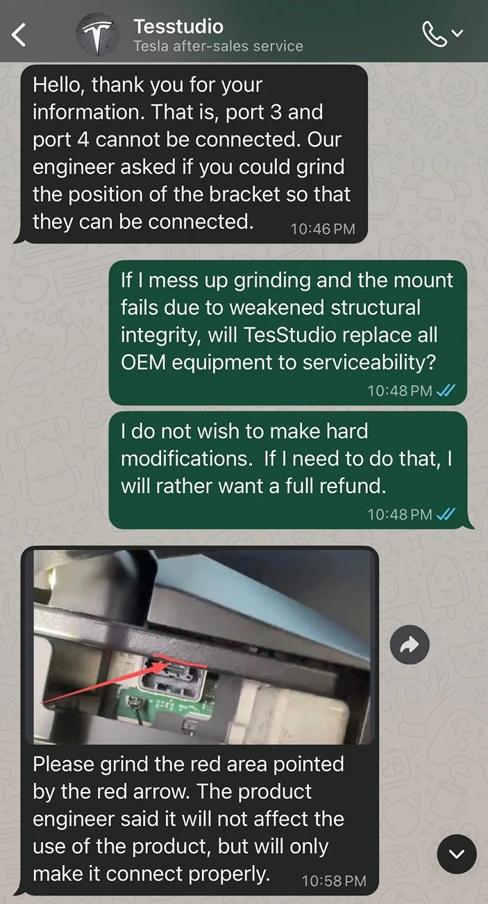

The aftersales service team wants me to grind/shave the metal mount to make the screen connector fit.
I didn’t buy this to make hard modifications to make it fit. That is not my job to do. That is an issue the product engineer needs to fix for a redesign of the product.

I just added a washer to the left side to give the cable a little wiggle room. It’s not much but better than nothing. They definitely need to redesign this.

On the bottom of my other post I mentioned this, unfortunately I didn't take a pic of it. I forgot and had mounted the screen back on at that point. I had to remove about 2mm of plastic from the shell (on the top side of where the bracket goes) because when I added the washer it raised it up and when I would tighten down the bolts it would pop the plastic shell off because it was hitting so I had to make clearance for that too. if you do it bench top you'll see where its hitting and where to cut. I'd rather sacrifice metal and plastic from the swivel kit any day over damaging the screen.
Yikes.. so my hack job is the "official" fix I guess. Thats not comforting.

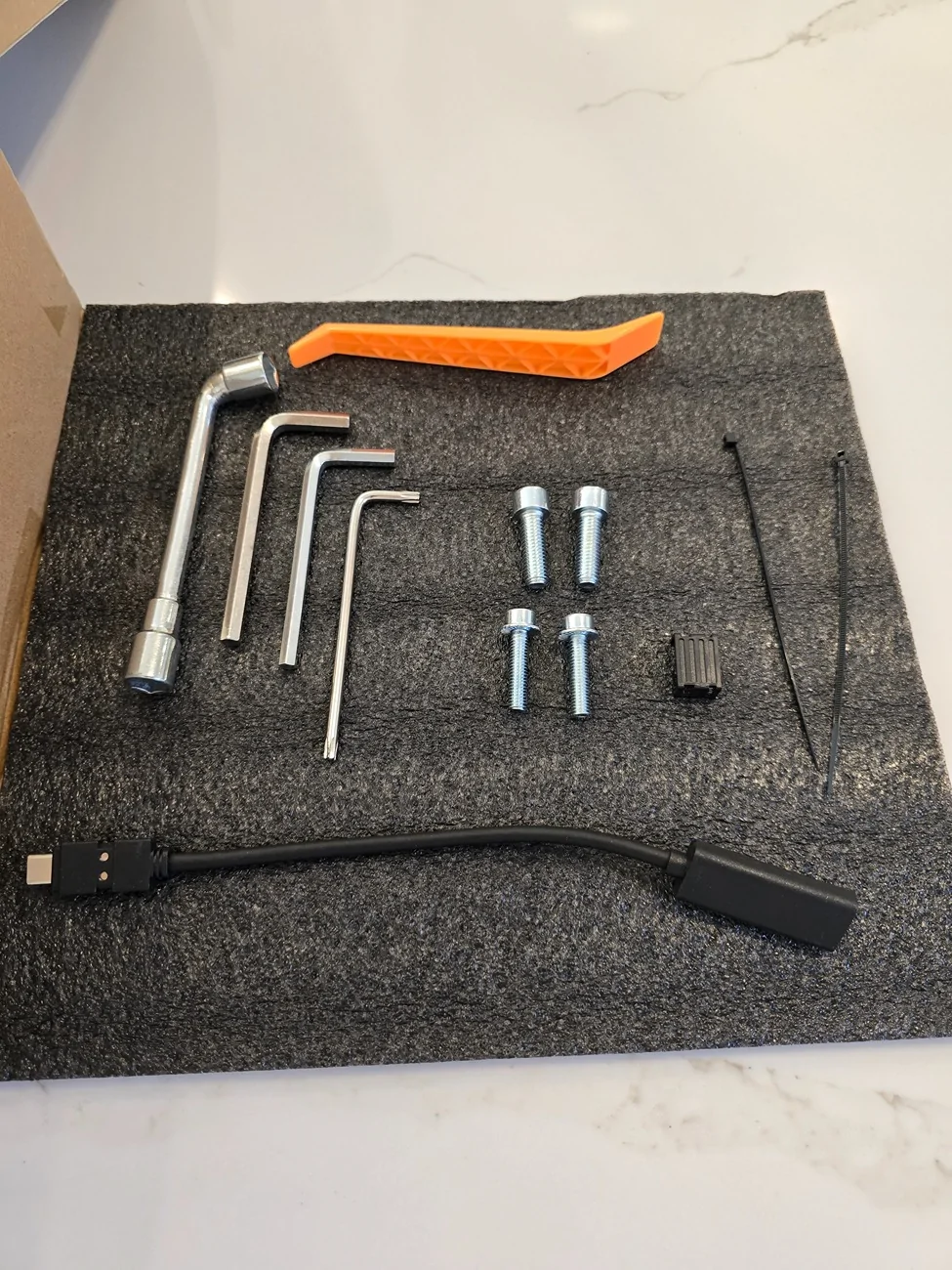

"Tool-Free"
Also...tools :) not that I expected it to be actually Tool-Free. Though maybe they meant free tools and it was mistranslated 😂
Will see how accurate 3 mins is on my FSCB

Im surprised they redesigned the bracket and didnt address this actually. Seems like a pretty simple fix. Id assume that the bracket is either milled or laser cut, just design and mill a relief cutout for the cable, same way I did just not sloppy with a dremel. Oh they can also send the royalty check directly to my account.
lol no way this is milled or laser cut, that would cost money!
These are cast, you can see some of the flashing on the images of the bracket up close. Cheapest way of making these parts.
I'm gonna wait until this is redesigned to v3 or they drop the price significantly to make up for the fact that I will have to modify the product myself to make it work.
