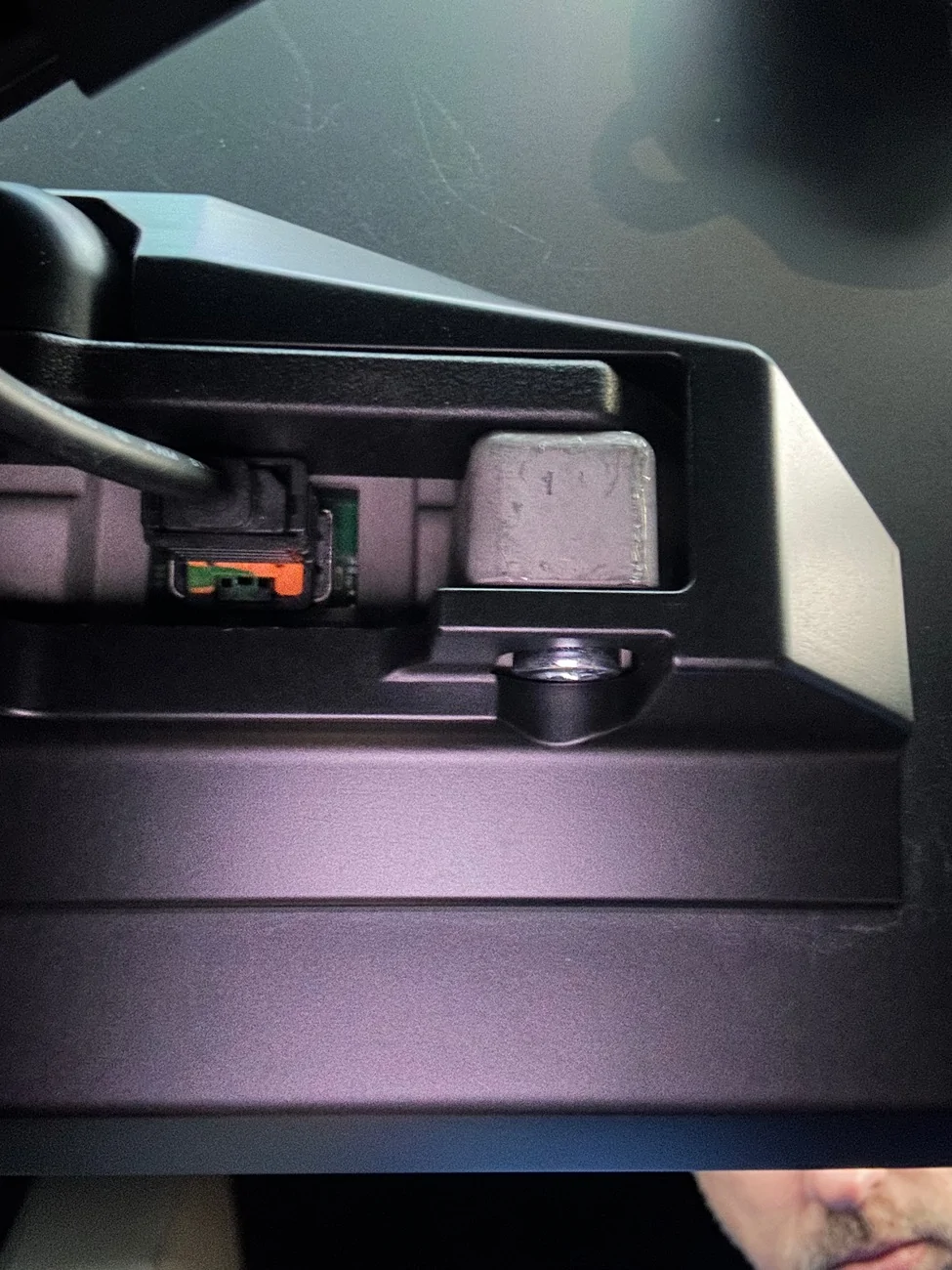

I noticed the spacers you installed in addition to the grinding. I just received this so i want to go through customer service first.
Keep me posted and let me know how it goes, I'm curious but not expecting much. They might have you remove the safety clip from the USB cable as a solution (one which I would not accept under any circumstance) it prevents the cable from unplugging and as you know, the screen is pretty much your whole truck.
I added the spacer to sort of split the difference, I didn't want to remove too much metal from the bracket but the space had to come from somewhere.

I have actually tried that in order to drive this morning to run errands, but it still won’t fit. So yeah. I am about to just ask for a full refund as it is design fault.
To me it appears that you need washers or a spacer on top of the arm assembly.. has anyone successfully installed this 2nd version?

So ive thought about doing that. But if I do that, the new plastic trim doesn’t fit on the screen side. I will need more than the current existing gap to fit the display connector without straining the connection.
If you go the washer route, you can just trim the plastic part for more clearance, that's easy enough and its not going to be visible, but if you plan on returning it like you mentioned then I wouldn't do that.

I will need about 5mm in washers/spacers or roughly 1/4 inch which is insane. Half that if I want to risk it with just the USB-c without the connection locking mechanism attached.
Yeah your situation is exactly the same as mine, I had about 1/4 in too, which is why I couldn't go strictly the washer route and had to remove metal to make it work. If you put that many washers then the bolts don't engage the mount properly. You could get longer bolts I suppose. It's a lot of leg work for a new product that should fit out of the box. It shouldn't require what I had to do.

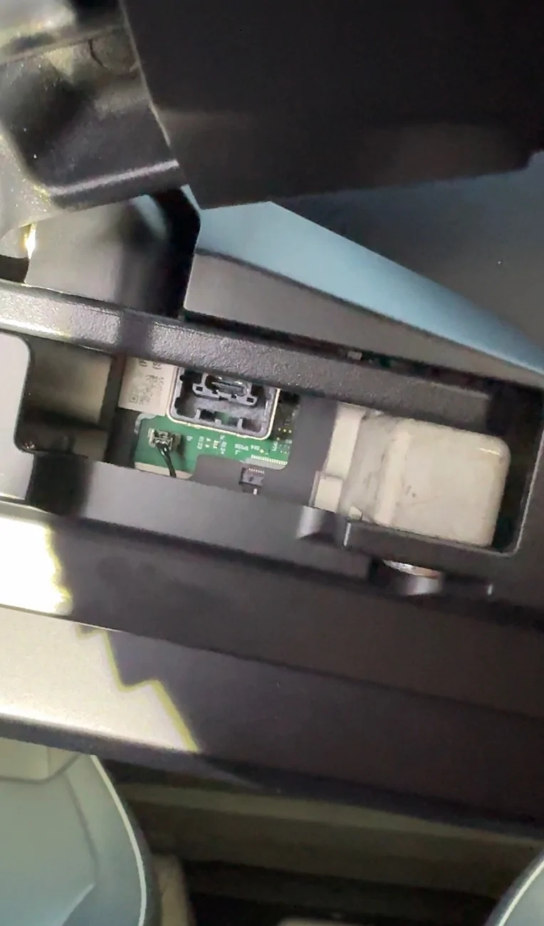

Yea I like it and think it’s worth it. Mine fits a little better than other but I may slip a washer in there to raise it a little bit off the connector though. Here are some more pictures
