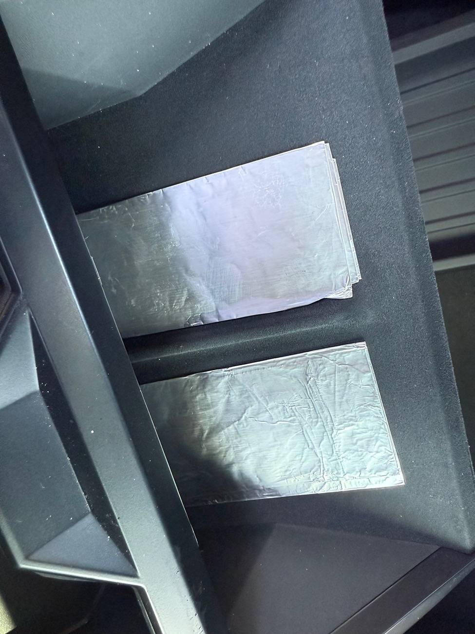

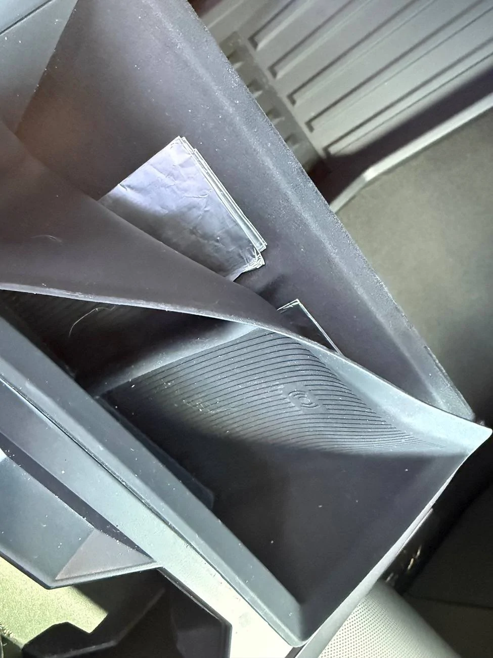

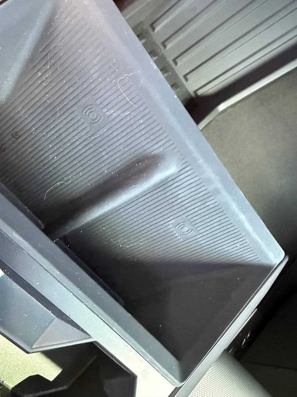

Get a silicone insert for the wireless charger and fold a little aluminum foil between the silicone insert and the charger. This will essentially disable the wireless charger. Don’t make the aluminum too wide on the driver side and the key card will still work when needed. I wish there was a better way but at least this allows you to drop a phone in without it getting overheated. Better off getting a magsafe charger for the display.
Tesla Cybertruck Phone gets sooo hot with wireless charging IMG_4295
Tesla Cybertruck Phone gets sooo hot with wireless charging IMG_4296
Tesla Cybertruck Phone gets sooo hot with wireless charging IMG_4294

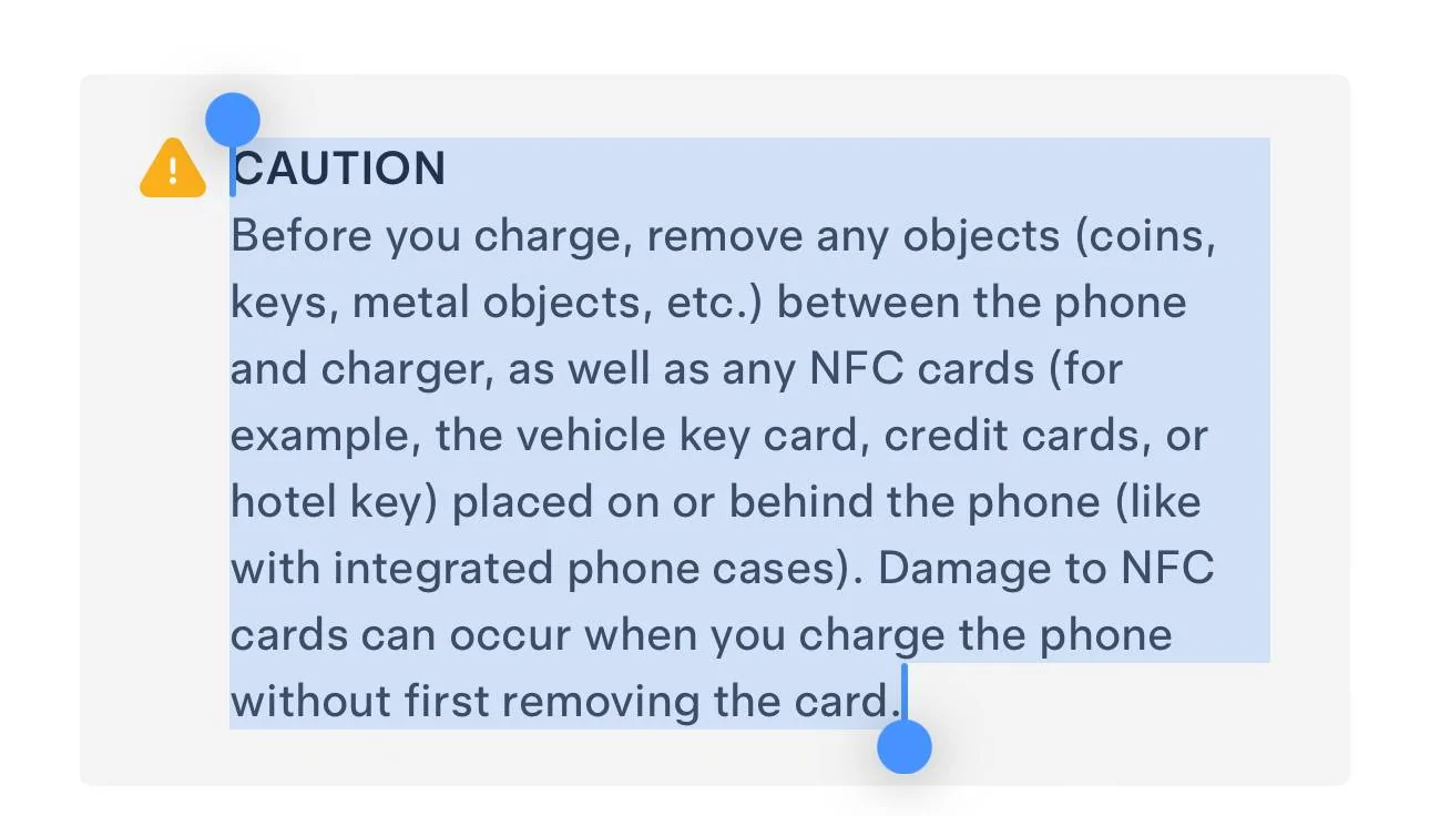

The other day, my wife's Pixel 7 got so hot that her Tesla keycard stored inside the phone case melted and fused within the case. She could not get her card out and I almost had to pry the case open to get the card out. It burnt a hole in the plastic portion of the keycard where it stores the chip. This is crazy.
the manual says not to store any RFID cards between the charger and the phone for that very reason….
