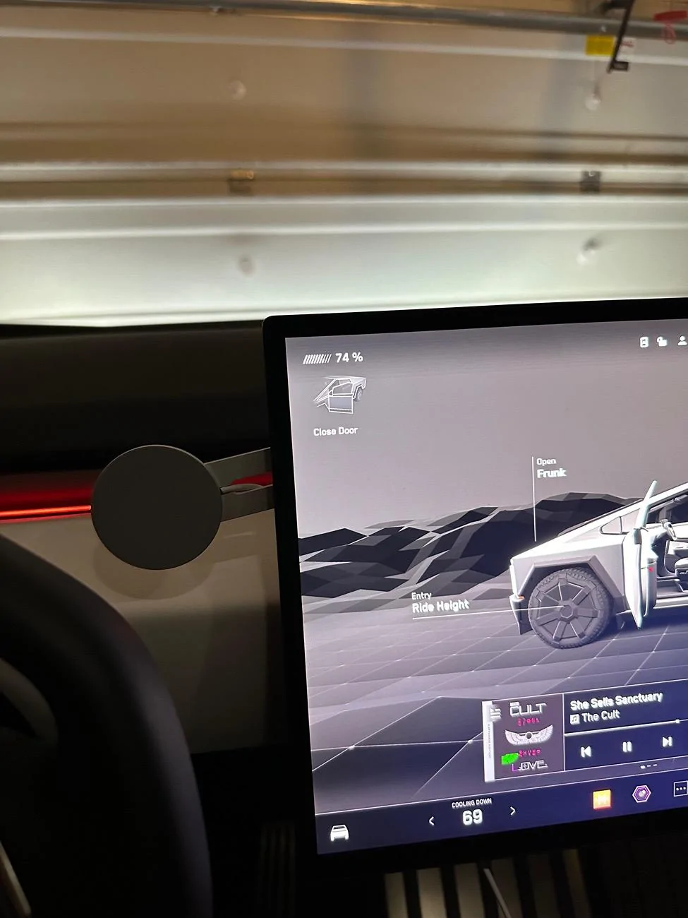

I put two magbak chargers on my display. The added benefit is the phone is now in clear view since we aren’t blessed with CarPlay.
Can you share a link to what you have?
