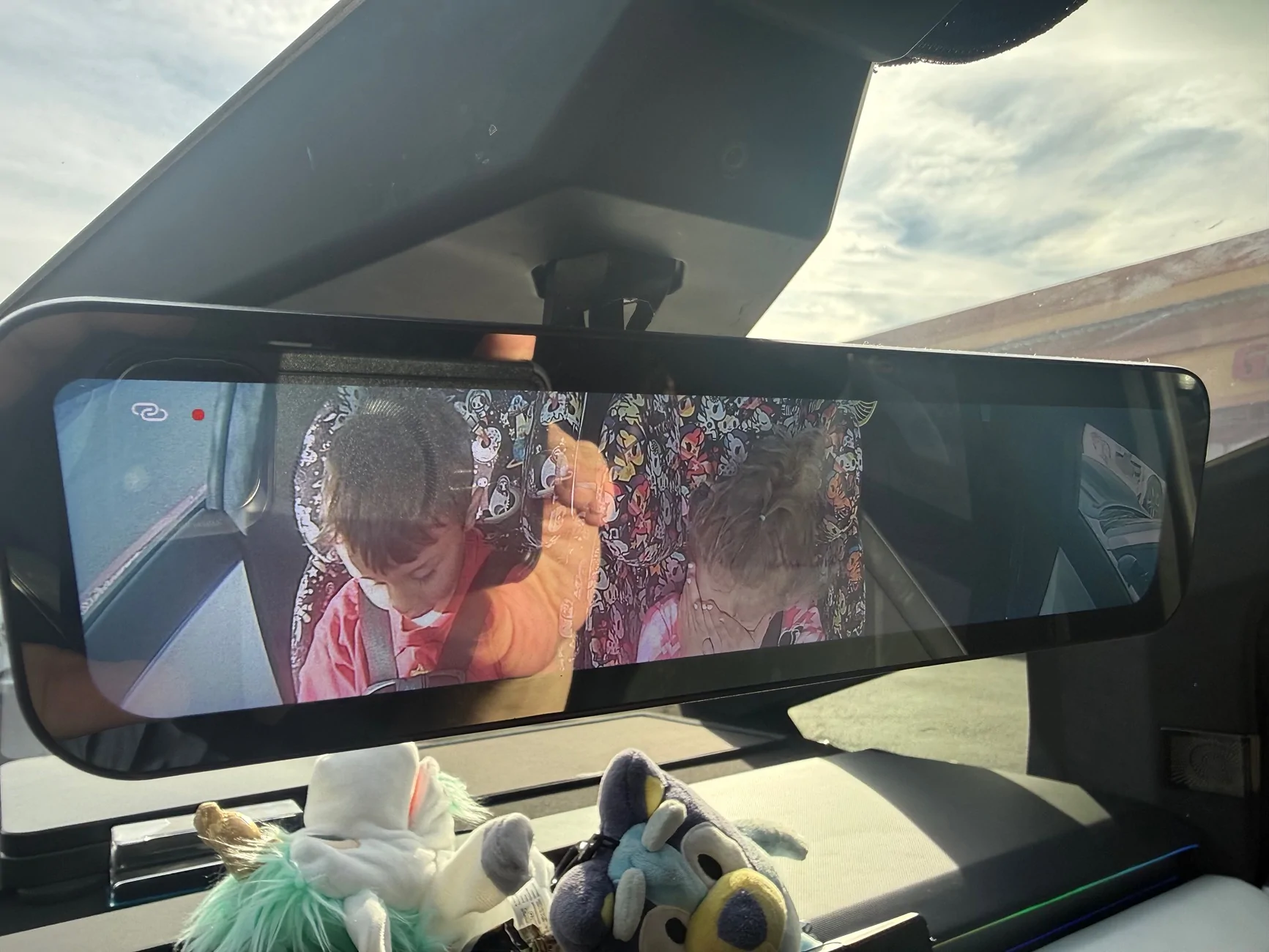

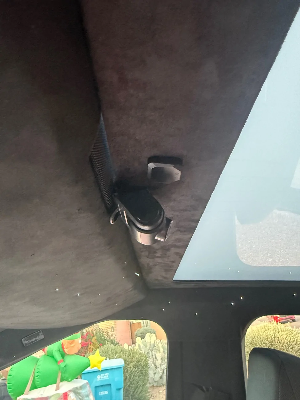

One of the reasons I like the s92 and there are several, is that the front cam is a separate small unit rather than mounted to the mirror like some of the others. There is in my opinion zero point in adding a second dash cam to Tesla’s, but I have found another use for that cam. Mine is mounted facing rearward in the front of the roof glass and functions as a back seat cam. This means I can either have a high res nice picture of my kids or a split screen view with them and the vault/back of the car.
significantly more useful in my opinion.
