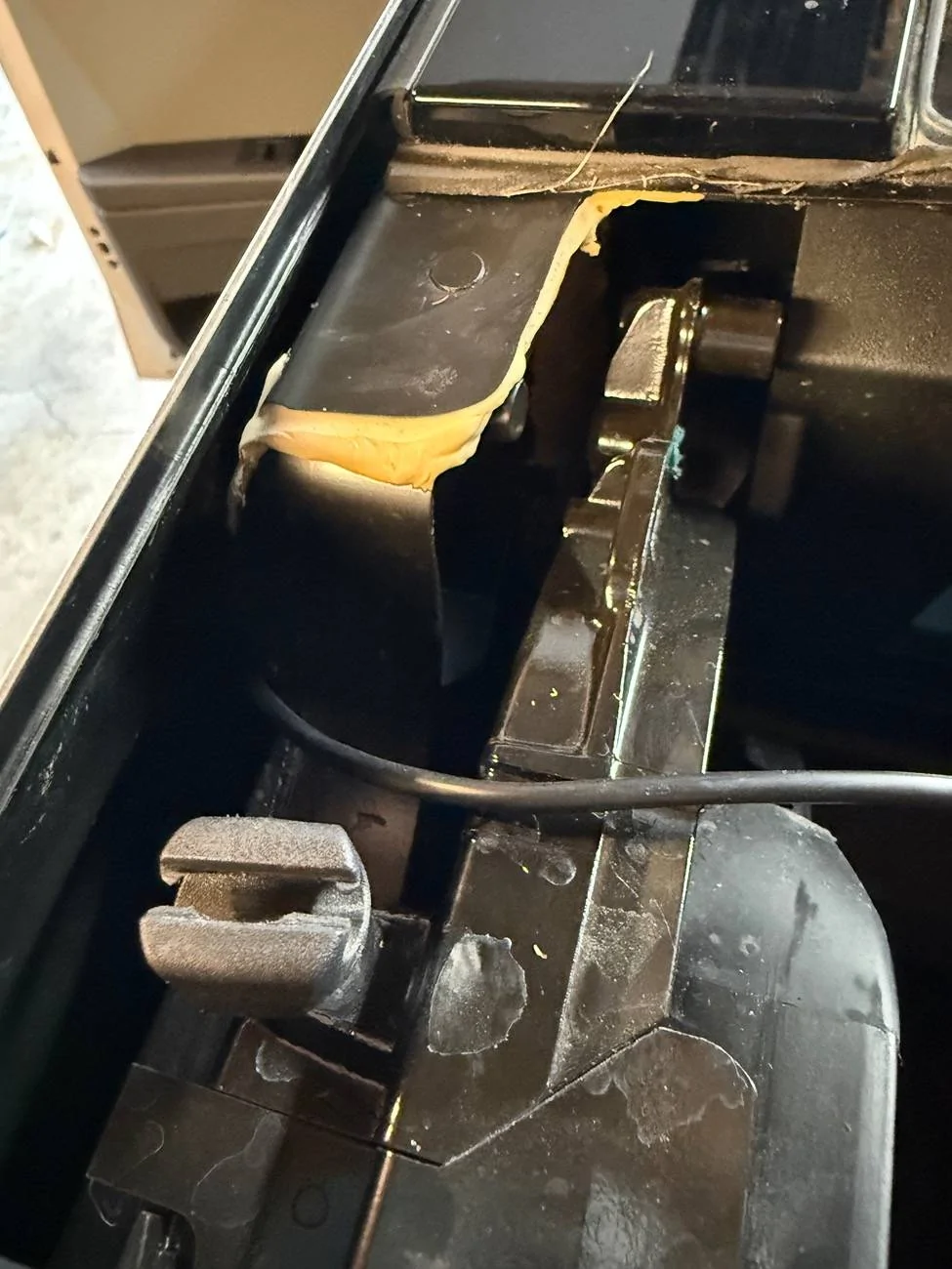

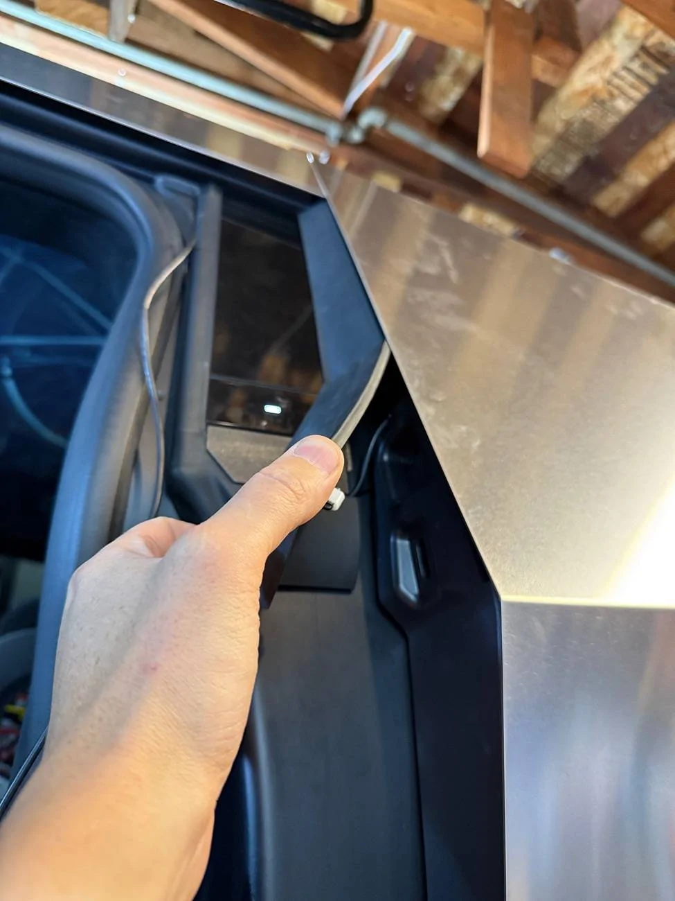

Ty Fury! With your videos and pics I was able to complete this today and super happy.
For the folks having trouble, I pushed the coat hanger through sections..then taped the connector on and gently pulled back. For the trickiest part(bed to door) I didn’t have to pull any trim pieces off, just snake carefully(see two pics where I went in and came out
