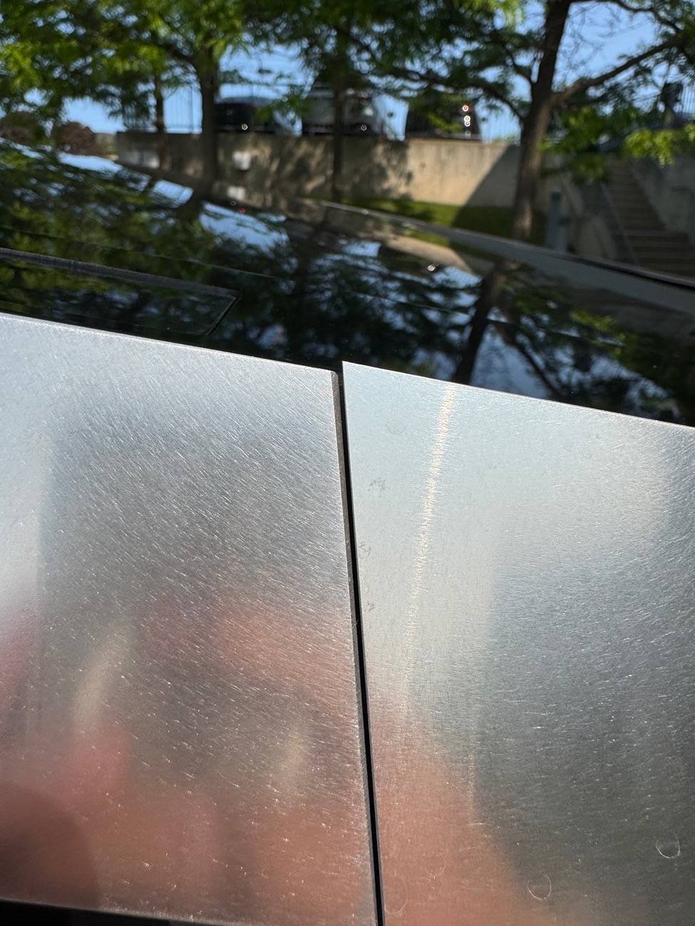

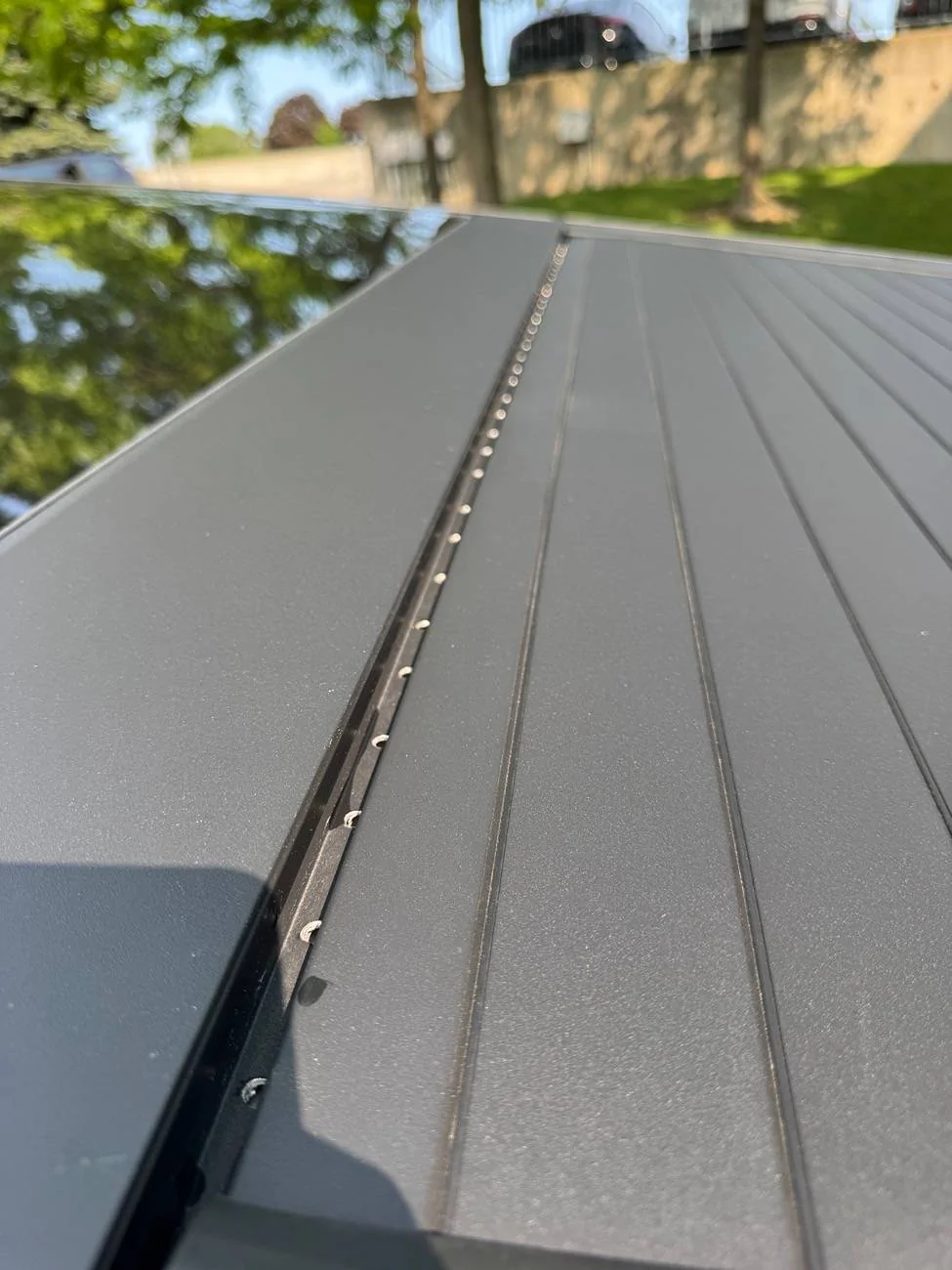

Here now
only two things I noticed
no rattle or loose panels after pulling with fingers
the trunk has a slight wobble when I tap/hit it
thoughts?

Pic #1:
The tonneau is missing a slat (all CTs coming out of the factory come this way). Service will add a slat if you ask for it (the how-to procedure is in the Cybertruck Service Manual; if you Google it, you'll find the manual).
There is no functional difference of having the extra slat or not. I had it added to mine just because I read about it on these forums.
Pic #2:
That's a common slight misaligned cantrail where it meets the rear quarter panel. I have it on both sides of mine. It's cosmetic, some ppl care about it, some don't. This may get fixed since you'll most likely need to cantrail recall applied to your vehicle.
For reference, mine is a 52xxx VIN built on Nov 15, 2024.
