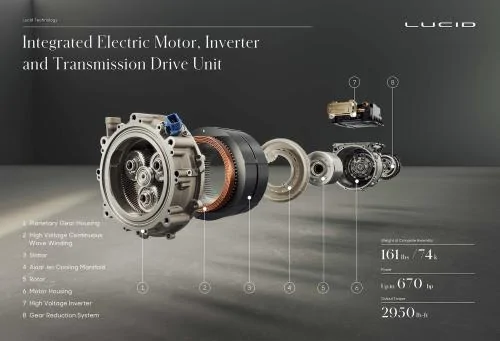

A planetary gear provides much greater ratios than a single gear gearbox can, and is ideal for compact high rpm motors (like the plaid) being used in high torque vehicles like the semi. This is also because it has three times the gear tooth area, meaning that individual gears can be smaller and lighter than a comparable single gear. Lucid Air drivetrain employs these in such a way, to make a super compact drivetrain, and the CT might even use them on the QM.
