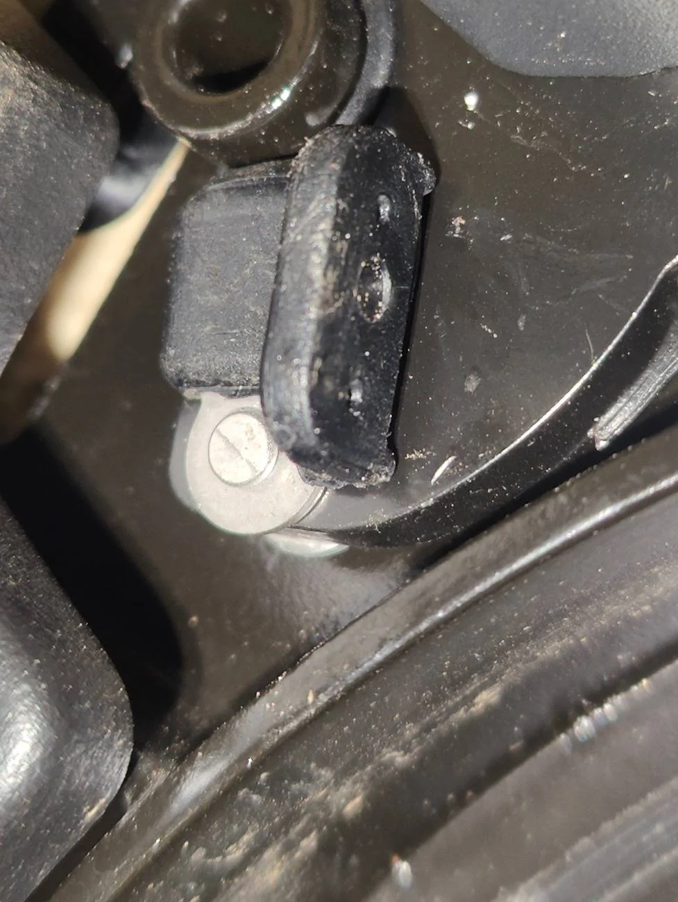

Thanks for your reply. The bolt looks like it has been sheared off, but both sides are identical. I just went out there and felt it and it is completely flat. Also, my Cybertruck has a black plastic lever in this area that other CTs do not have. I can move the lever a little bit but it appears to do nothing.
I took a more zoomed in photo.

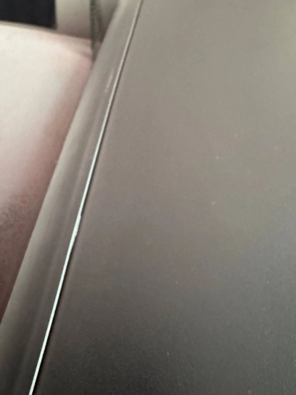

I had a slight leak on the right corner. I tried the youtube fix worked for a while but subsequenlty leaked. Best option I found is this rubber window seal someone recommended on face book. No need to remove the appliqué. Try this it’s cheap fix from Amazon. Align the adhesive part along the glass portion. Use the adhesive cure swab for good adhesion. Water will flow over the seal. Looks great if aligned properly.

Hi Dan,
You have the updated version, that's a flip/ lever lock, no T30 driver needed.

I think I understand what you want to do - you want to take the lateral piece off that goes from left side to right side.
if that’s the case - reference your last photo. Pull the top of the black plastic button aft and lift the trim. That will release that side. The tent install basically makes the trim piece - quick release. No tools needed.
