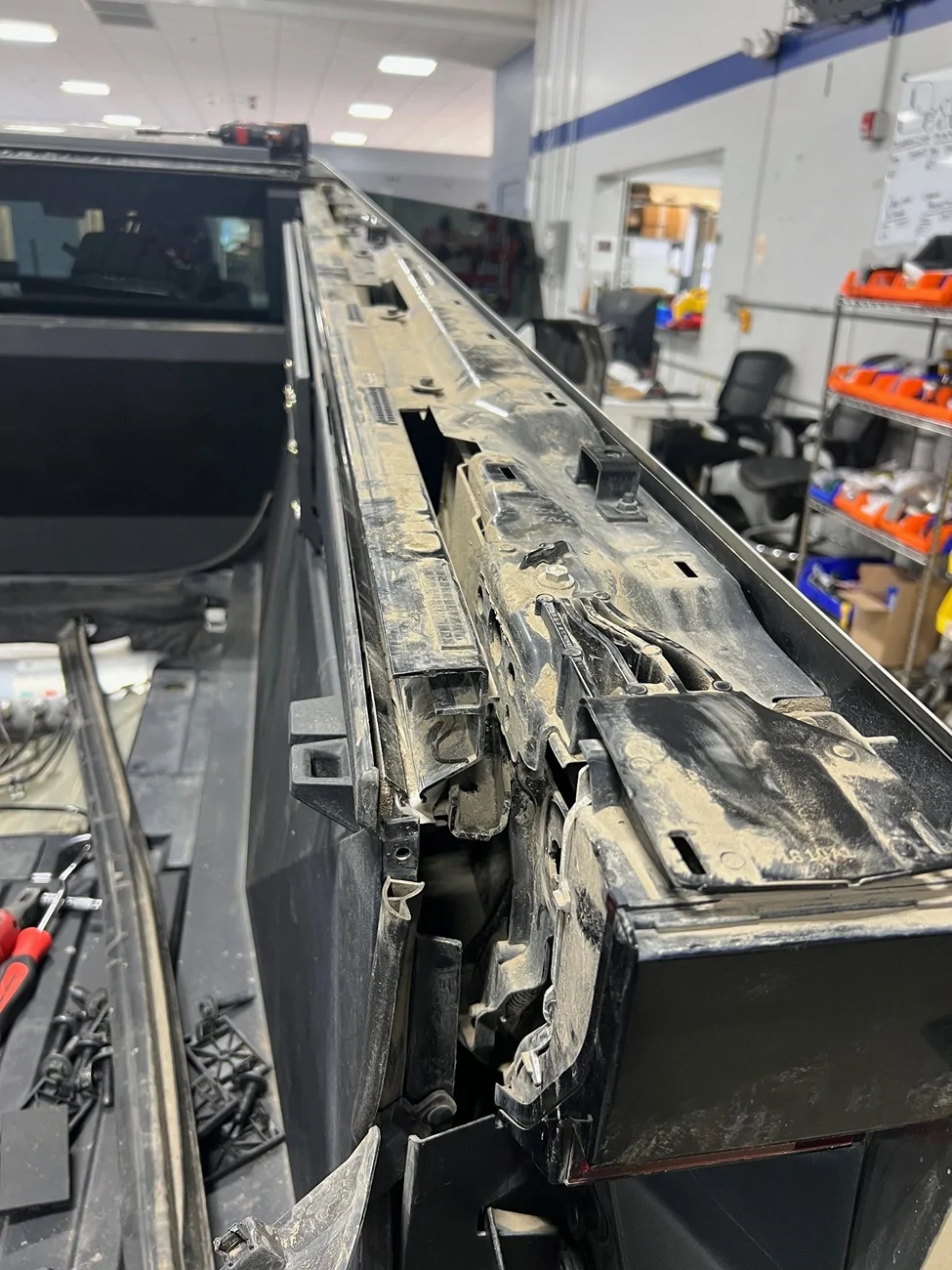

Tesla Service found copious amounts of dust beneath the sail appliques when replacing my damaged tonneau cover:
Tesla Cybertruck Overland to Arctic Ocean Ruined My Tonneau Cover (Due to Dust) Right Sail Dust 1

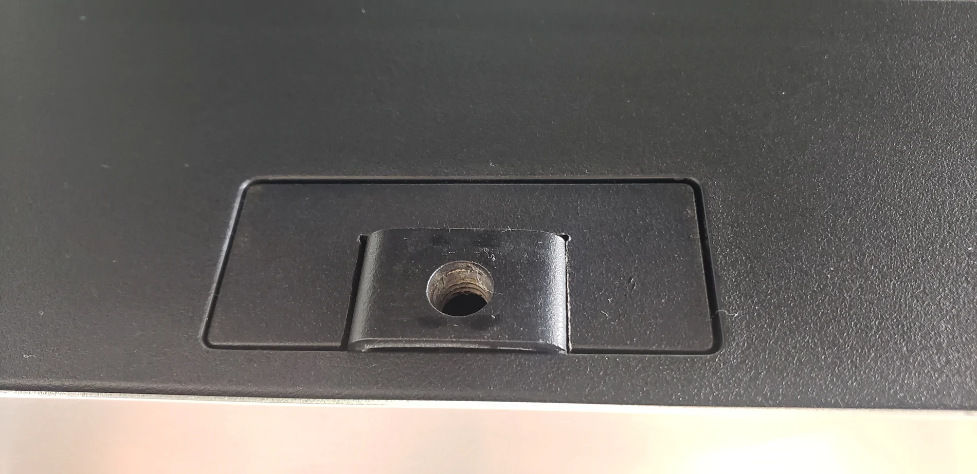

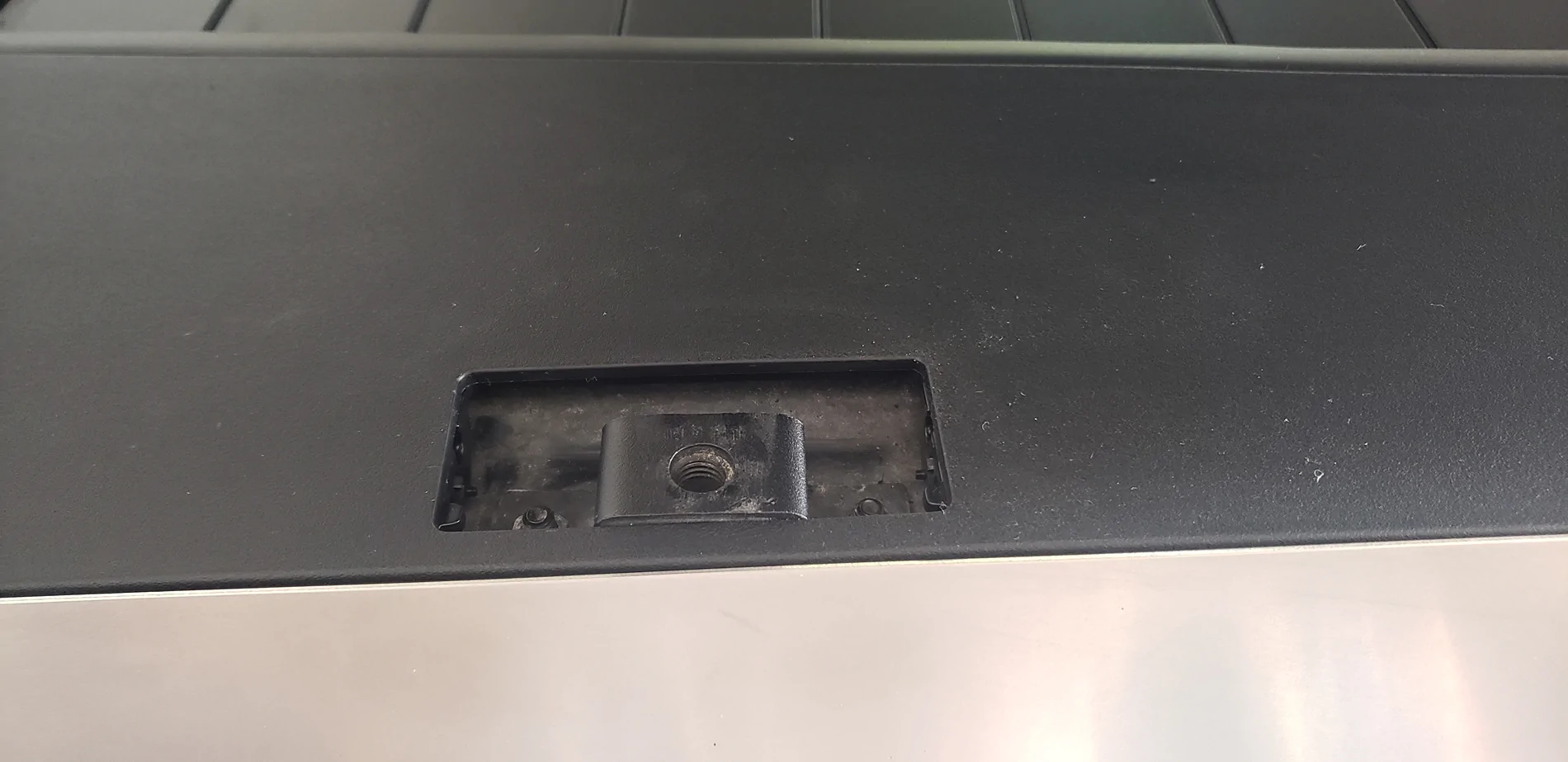

It occurred to me that when I installed the Urander bed rack at the 8 mounting points on the top of the truck, removing the hinged plastic doors covering these mount points enabled dust to find its way into these spaces.
Tesla Cybertruck Overland to Arctic Ocean Ruined My Tonneau Cover (Due to Dust) Mount Point Open
By cutting out a rectangular piece of the plastic door to match the Urander mount bracket and reinstalling the door, the gap that allows dust to get into the space beneath the sail appliques is closed off.
I might also apply a piece of black tape over the mount point to completely seal the opening from dust penetration.
Thoughts?

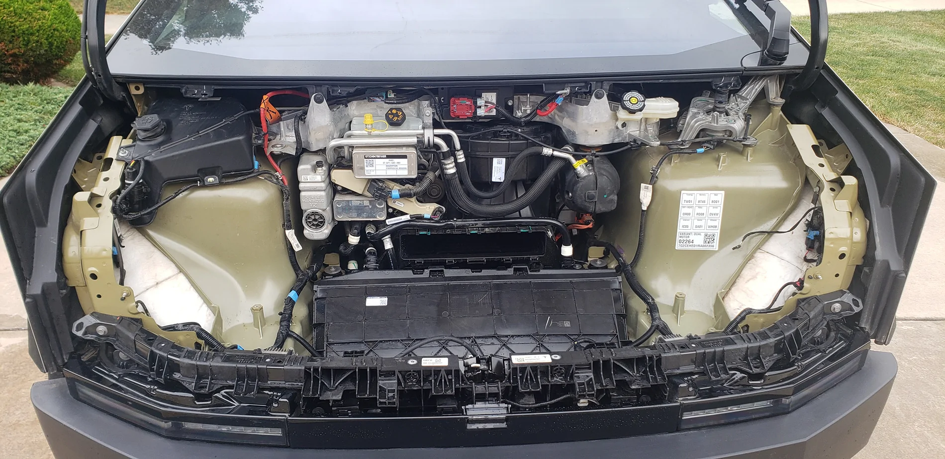

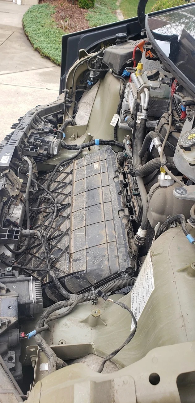

When you say frunk did you open the front frunk area . I suspect that will also be clogged up with dust ( saw another thread regarding front frunk area )

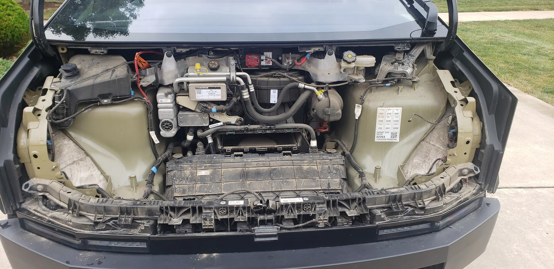

Yes, there was dust under the frunk shell, as well, but not as much as toward the rear of the vehicle:
Tesla Cybertruck Overland to Arctic Ocean Ruined My Tonneau Cover (Due to Dust) Under Frunk Dust 1
Tesla Cybertruck Overland to Arctic Ocean Ruined My Tonneau Cover (Due to Dust) Under Frunk Dust 2
The cabin filter will have to be replaced ($100+tax). After powering off the truck (Service>Power Off), I used compressed air to blow out as much dust as possible, then I used a wet microfiber cloth to clean the stubborn deposits. I was reluctant to hose down this space, but did so in a couple of places where street water can normally get in. After cleaning (cabin filter removed):
Tesla Cybertruck Overland to Arctic Ocean Ruined My Tonneau Cover (Due to Dust) Under Frunk Cleaned

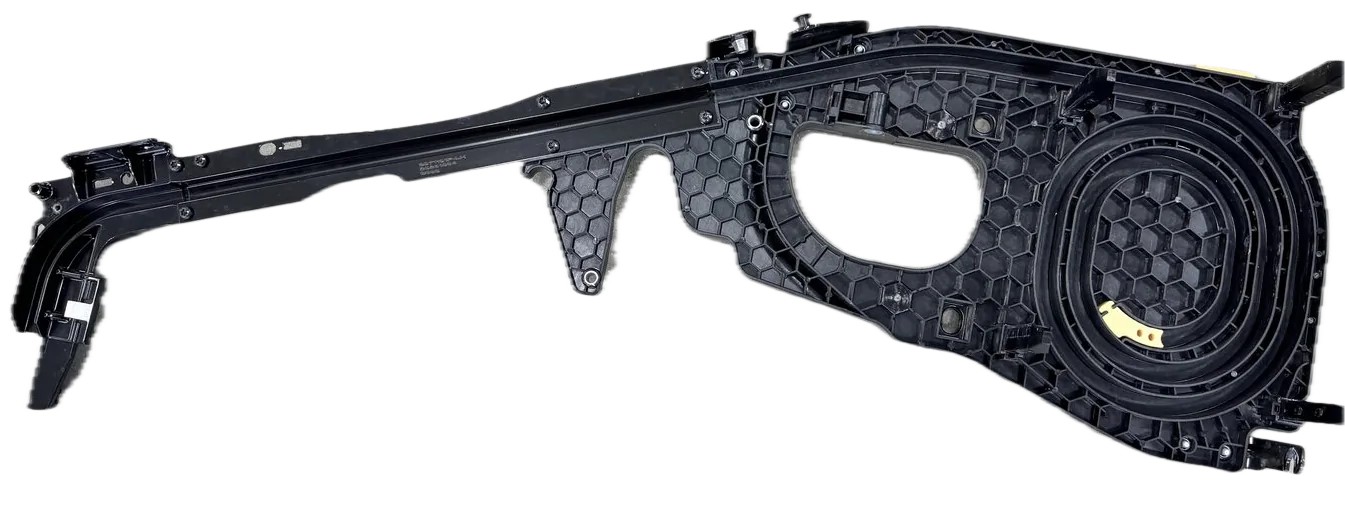

The entire tonneau track, including the cassette, is entirely self-contained:
Tesla Cybertruck Overland to Arctic Ocean Ruined My Tonneau Cover (Due to Dust) GUID-528455CE-43B4-4F08-87B1-A03C2F8BA5A0-online-en-US
Nowhere do I see any openings, weep-holes or other egresses for debris (other than the end of the track at the tailgate).
Of course, any opening would also be a path for debris to enter the track, as well as a potential escape hatch for the bearings. It's not easy to get stuff in there, but when contaminated it's not clear how best to get it out.
That said, I think @Cybergirl was definitely testing the extreme-use case :LOL:
The entire surface you are looking at is open, that is an egress. Especially given the draft angle that usually accompanies injection modeling.
Rollers are snap locked onto their axles, I think.
