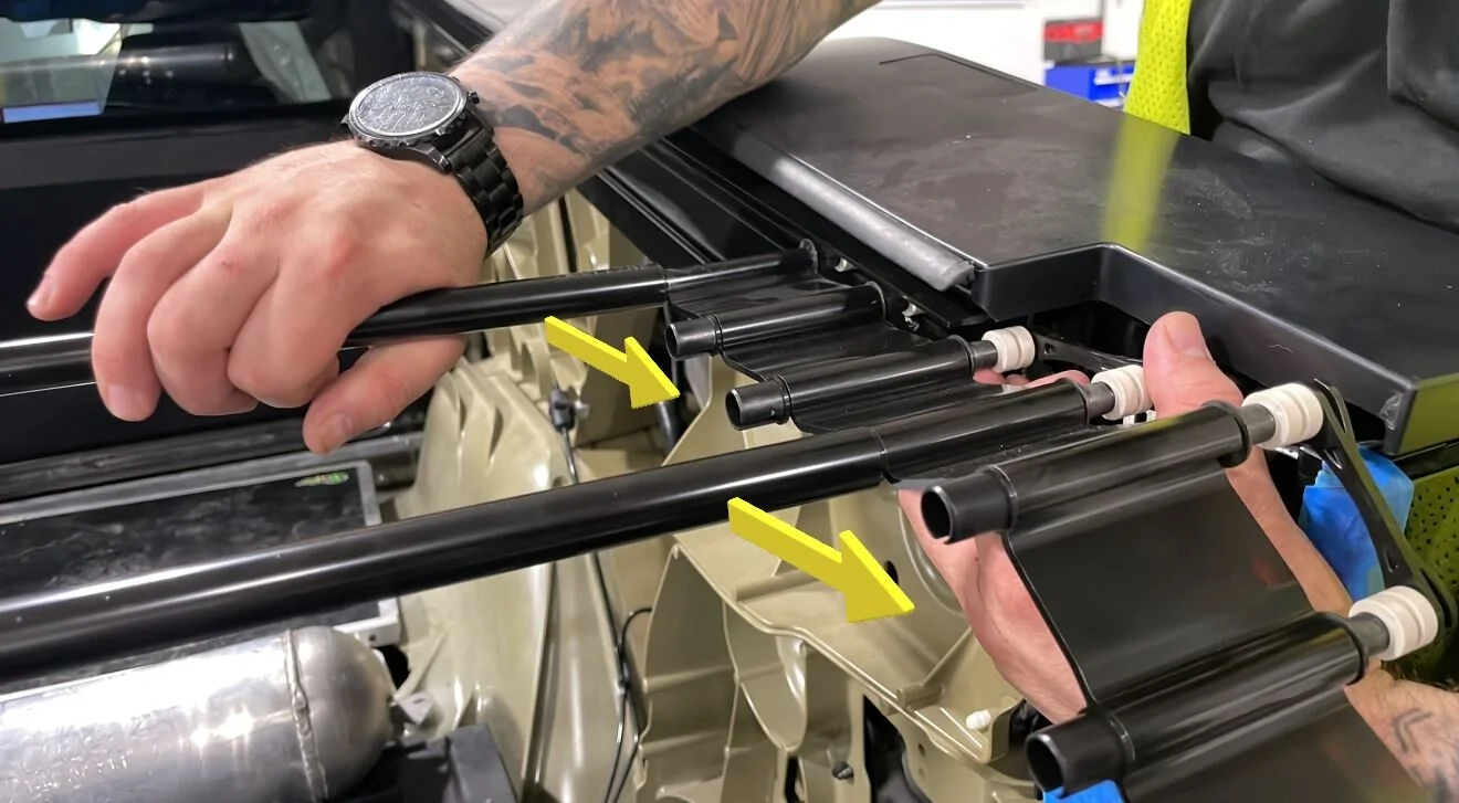

The entire surface you are looking at is open, that is an egress. Especially given the draft angle that usually accompanies injection modeling.
Rollers are snap locked onto their axles, I think.
Right, any part of the track that is not actively holding the tonneau bearings is open.
However, if something ends up in the track between the bearings, there isn't much of an escape route.
Why not from between the bearings? There is a lot of space there.
In this image, the tonneau assembly is partially disassembled. Ordinarily, the bearings are not visible from the top. The bearings are less constrained once they transit beyond the rubber seal of the rail assembly, at the back window.
