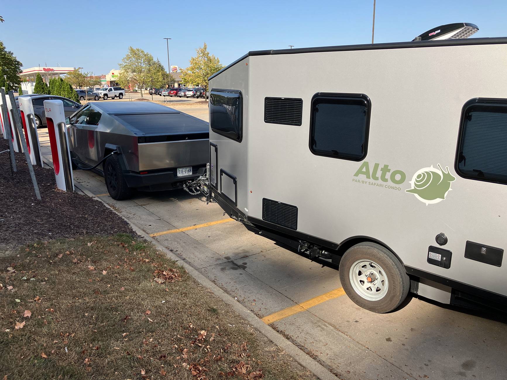

I’d love to know how this combo would do on the same trip. We had considered the Polydrop, especially for the range and shape, but ended up with Future + Retro look.
So we almost bought a Rivet but the cost was just so high. What is your WPM Watts per mile?
This is us now. We have gone over 6,000 miles and stay right around 600 WPM This charge stop was in Dubuque Iowa after our John Deere Factory Tour on our way back to Virginia from the Grand Tetons and Yellowstone.
Tesla Cybertruck Polydrop P19 Micro Camping! (Photos & Trip Data) IMG_1170.JPG
Tollak
Nov 18, 2024
San Diego, CA
www.youtube.com
Tesla Model Y
Content Creator
500 mile trip from Townsend TN north to Toledo Ohio. I have made this trip empty and with 3 separate campers now. Cruise set at 72 mph.
Truck only with cargo, vault closed. Cat scales 8460 total weight.
424 wh/mi
Truck and the Polydrop, same cargo and truck weight. 72 mph.
520 wh/mi
Truck and Nucamp Tag XL, same cargo and 72 mph.
696 wh/mi
Truck with 21’ Mallard. Full size camper. Towed beautifully but took a day and half with charging stops.
1150 wh/mi
Things to note, live usage increases by 4% per mile, north of Lima Ohio. The land is flat but the fields open up and the wind takes over.
For reference this is the nucamp we rented and my “parachute”. When we take the big one we call it the 2024 Supercharger Tour.
