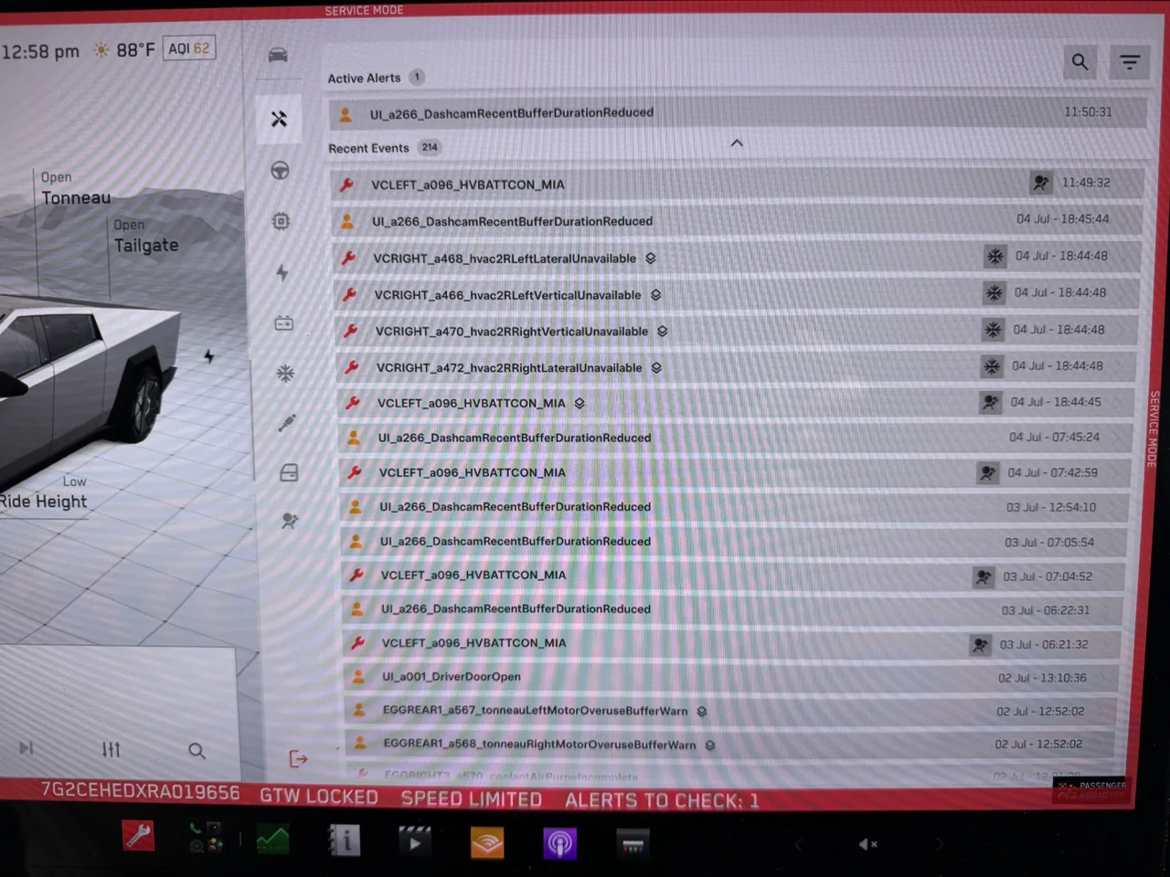

The 30-minute drive home was uneventful. As soon as I parked I went into Service Mode. This event happened on 7/5/26 at approximately 12:25pm. There was a VCLEFT_a096_HVBATTCON_MIA error, but its timestamp was roughly 35 minutes before the event. And its related icon suggested an airbag issue, if there was any issue at all (most Service Mode alerts are transient/spurious). So I concluded that whatever had happened was probably related to the restraint system in that front passenger seat, notwithstanding that that single _a096 error had occurred prior to the bang/smoke (if anything, that error may have presaged whatever ultimately caused the bang/smoke event).
Plugging in, the truck again received its L2 charge exactly as expected.
Service Mode ~35 Minutes After Event
Tesla Cybertruck Post PCS2 Replacement - Smoke Gets in My Eyes Cybertruck_Service_Mode_2026_07_05_30_Minutes_After_Event Larg

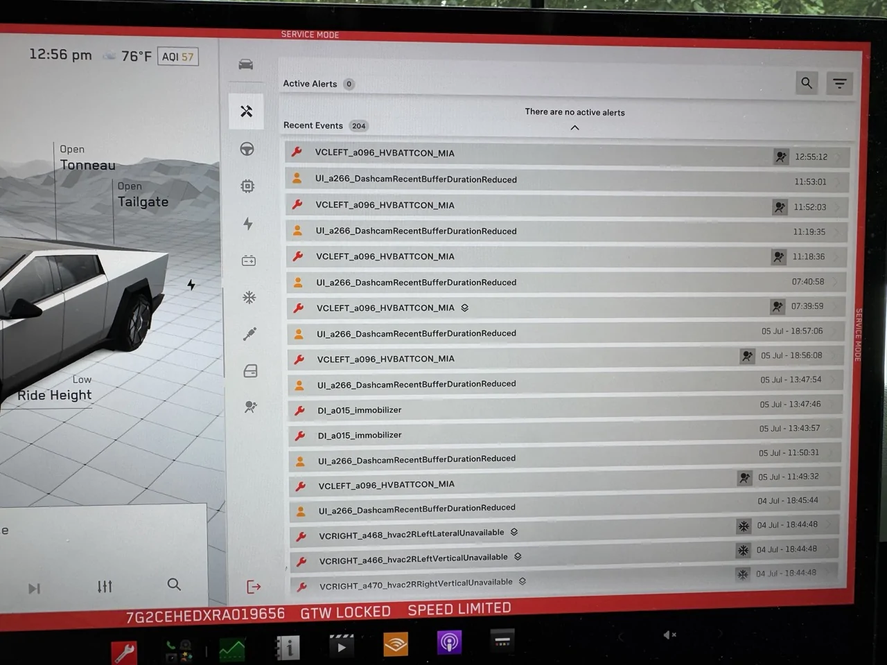

A day and a half later, on 7/7/26, not having driven the vehicle since the event, I again went into Service Mode. There were a bunch more _a096 faults.
Service Mode Two Days After Event
Tesla Cybertruck Post PCS2 Replacement - Smoke Gets in My Eyes Cybertruck_Service_Mode_2026_07_07 Larg

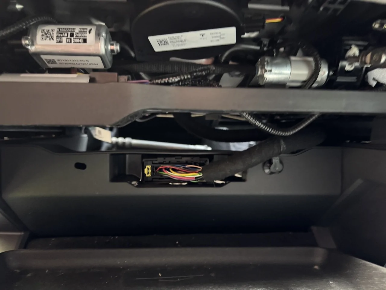

This time, though, I peered under the front of the front passenger seat (looking for scorch marks or other evidence) and found that there are, indeed, a number of electrical components under that seat.
Beneath Front Passenger Seat
Tesla Cybertruck Post PCS2 Replacement - Smoke Gets in My Eyes Cybertruck_Front_Passenger_Seat Larg

Does your passenger seat belt attachment at the bottom look different than the driver's side?
Pretensioner could make the noise you heard and wouldn't be obvious like an airbag.

I have never paid any attention to the seat belt attachments, @mongo. I'll check that this morning.

When I got home I went into Service Mode again and found that those VCLEFT_a096_HVBATTCON_MIA faults went back well before the PCS2 replacement a week ago. I'm increasingly inclined to think my little explosive event was unrelated to the PCS2 replacement.
