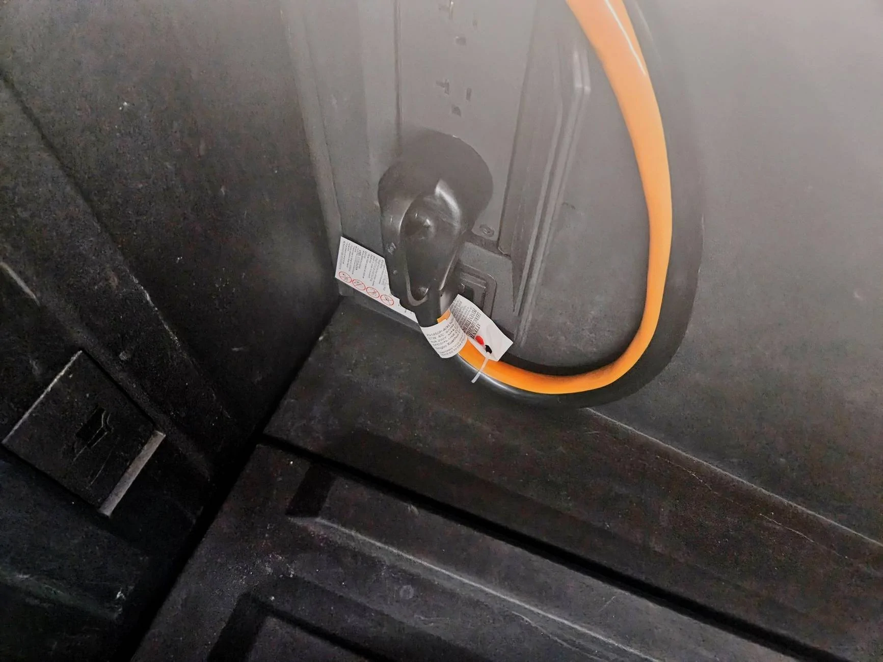

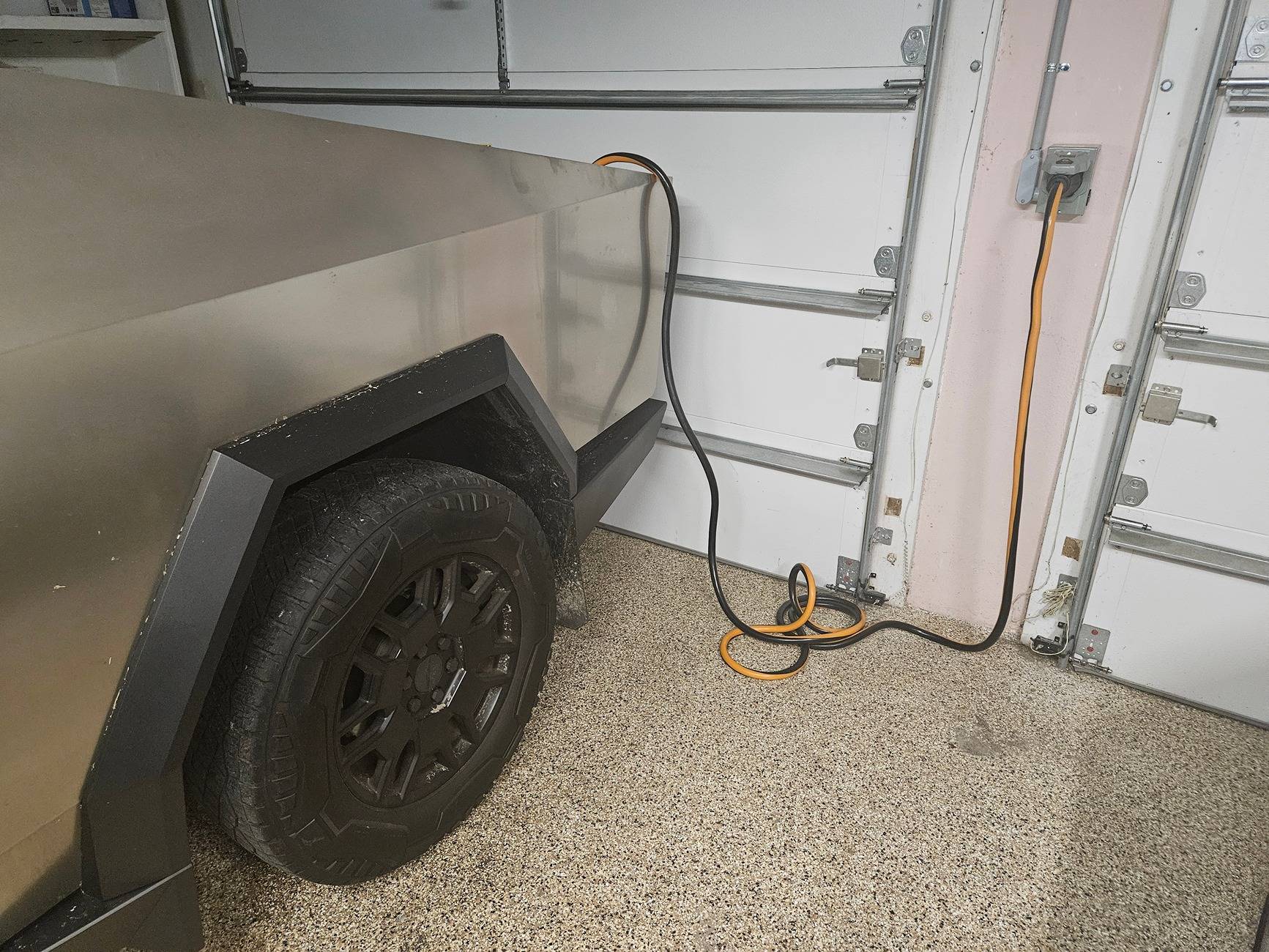

You can do this. You can use your nema 14-50 plug and make your own cord with two nema 14-50 male plugs. The key thing is to turn off your main breaker and make sure no one turns it on as you will fry everything if you leave it on or someone turns it on while your powering your house. (hence why you get the main circuit panel cutoff switch lockout) Guy in florida said the CT powered his house for 3 days easily if not using the electric oven...
