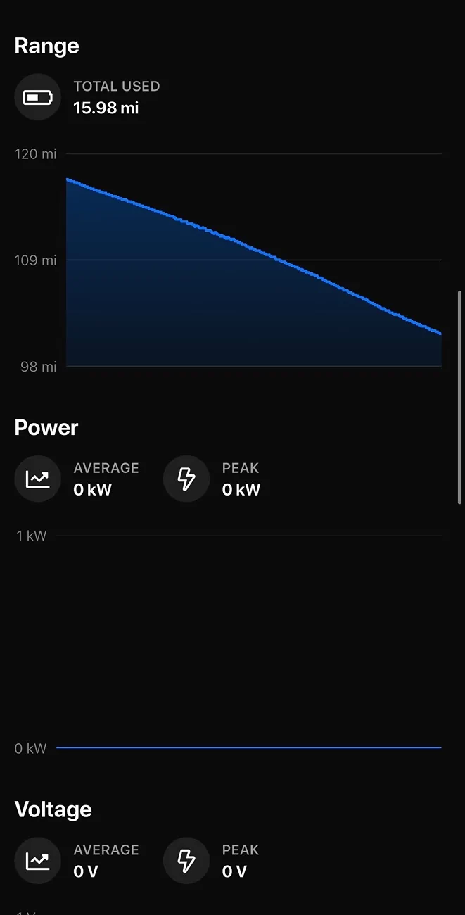

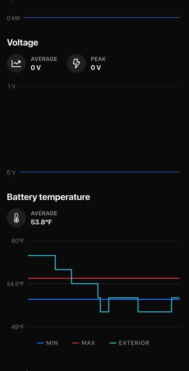

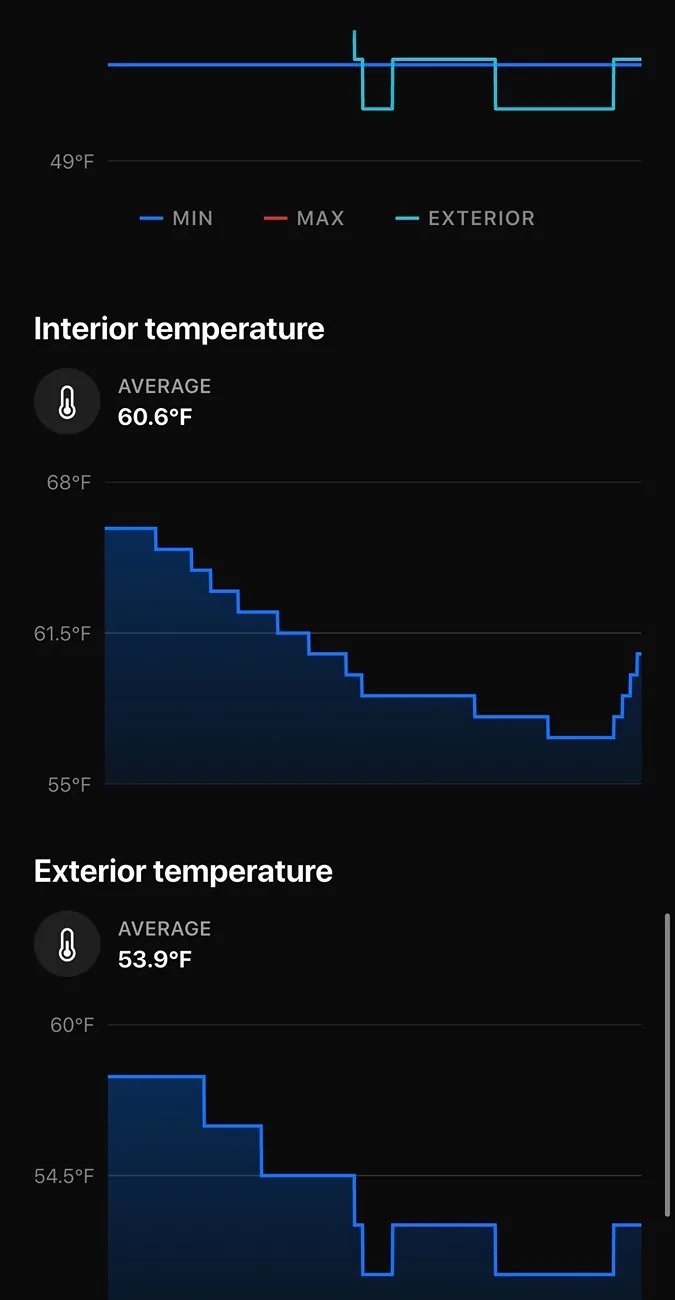

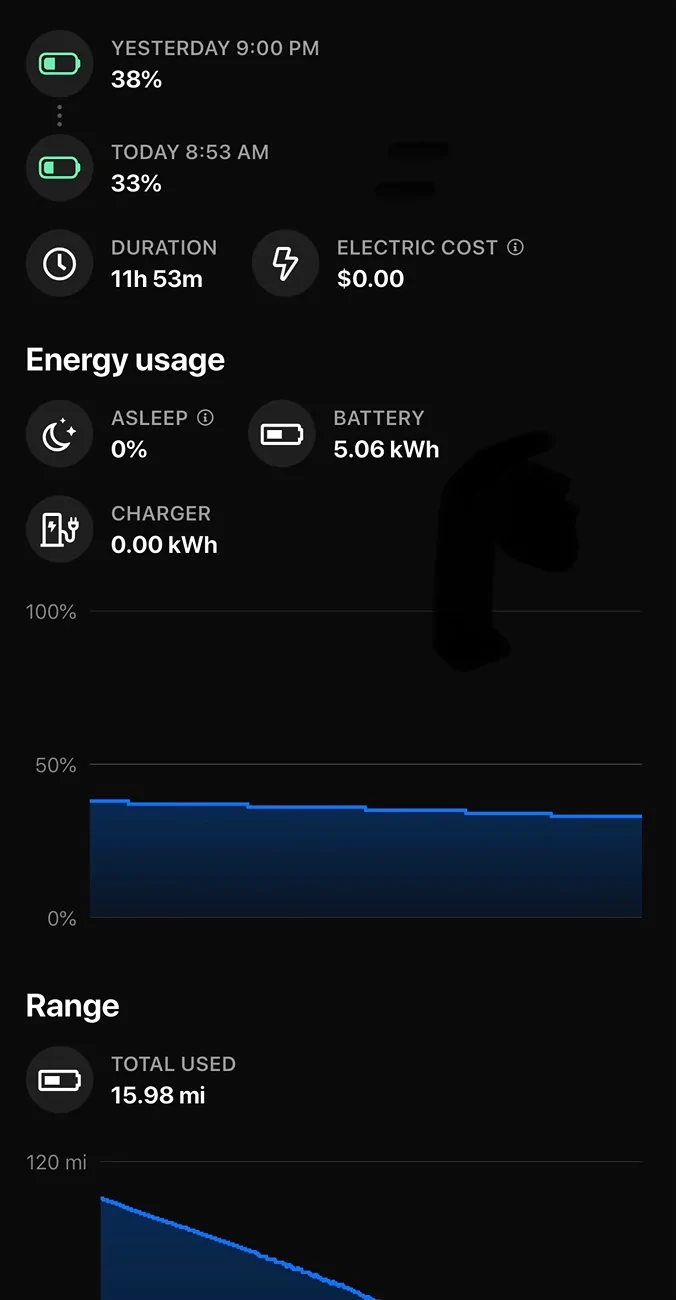

Tessie will track an “idle”. Not sure exactly what data you are looking for, a live watt meter is on the screen while outlets are on

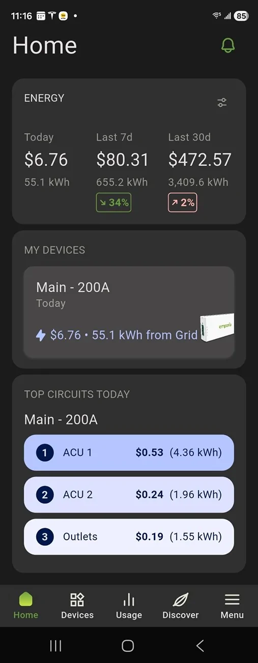

I started with Sense for my house about three years ago, and what they did is pretty amazing in terms of mapping usage patterns to appliances and things that draw power in general. It takes at least a month (back then) to accurately map devices to power curves and ramps, etc.
However, I took a chance and tried Emporia with a 16-sensor unit on my main panel, then added two more for my two subpanels in my house, and have never looked back. In terms of accuracy, both Sense and Emporia are identical. Emporia lets you meter any individual circuit in the panel (up to 16), plus whatever mains you have coming in. Any circuits you don't monitor get mapped to "Other", so the aggregate draw is the same as the mains. They also express all metrics in 7 different ways, i.e., Watts, Amps, Currency, C02, Trees, etc. I only use Amps, Watts, and Currency really.
One more thing: Emporia allows you to stack or sub-meter if you have multiple panels, so you can "roll up" the results or view them totally separately. They also support solar input and net metering.
Attached is a live screenshot of my dashboard. Installation is easy if you know a few basics about power; otherwise, call someone who does know how to install it/them.
