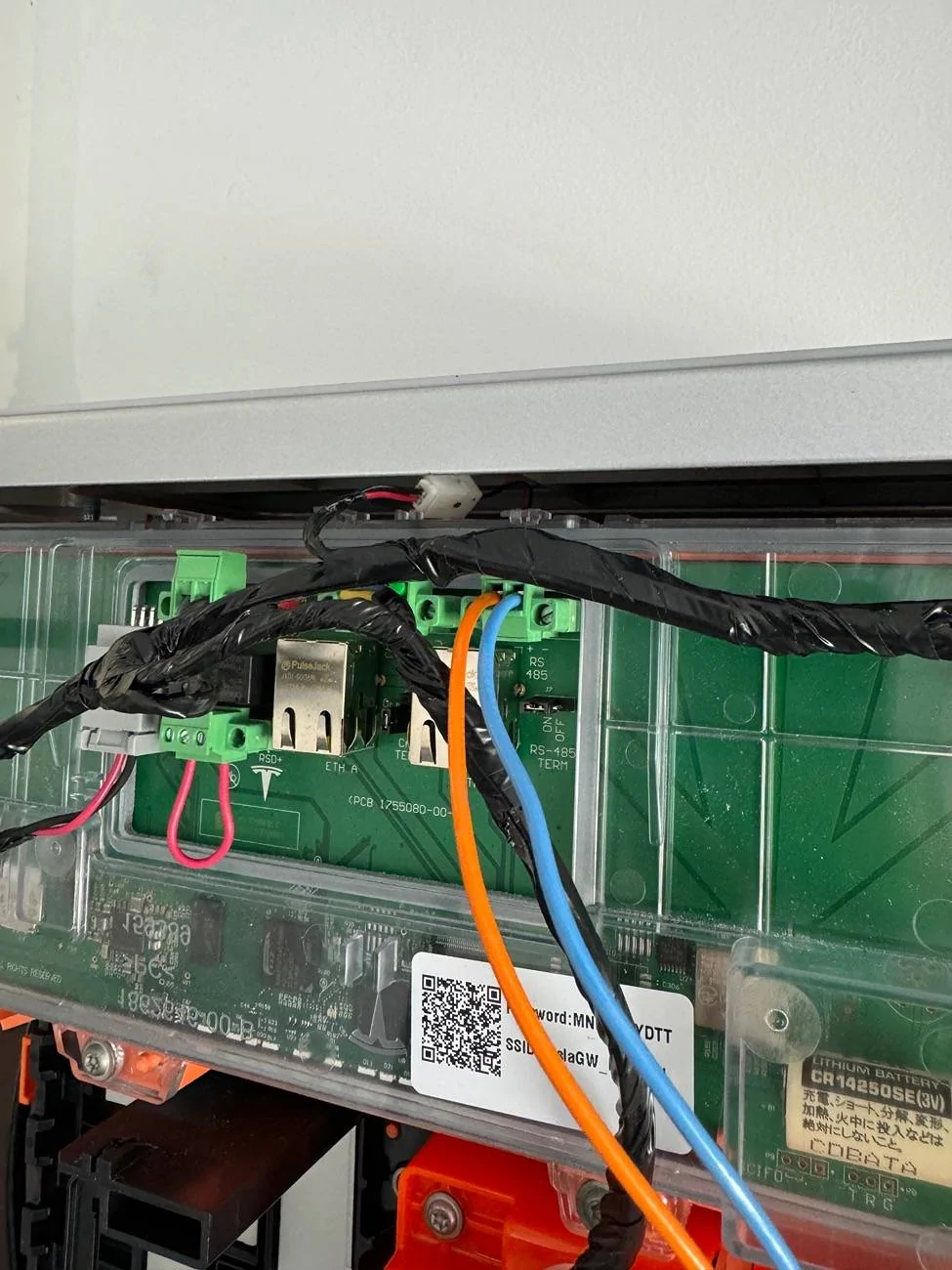

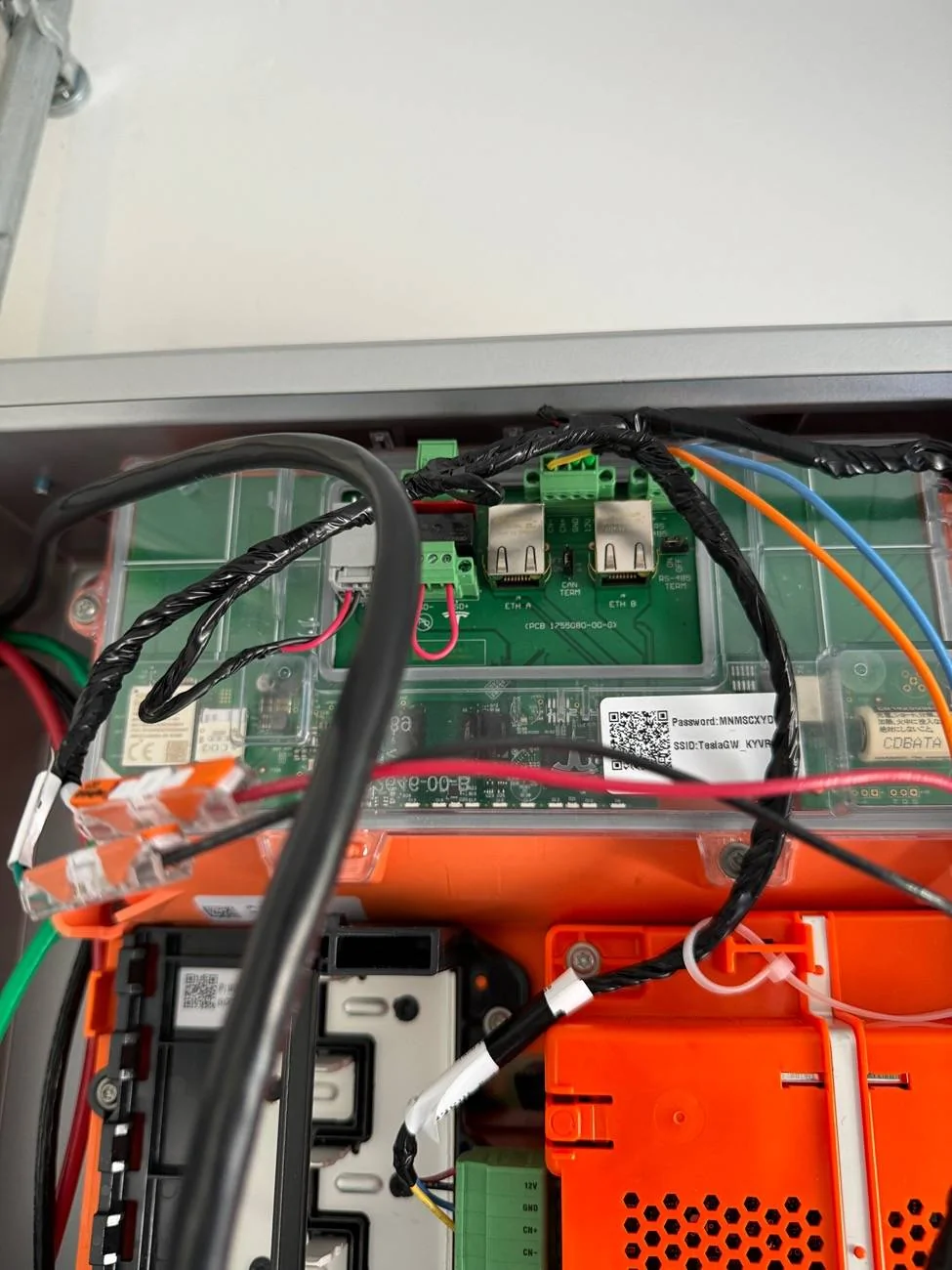

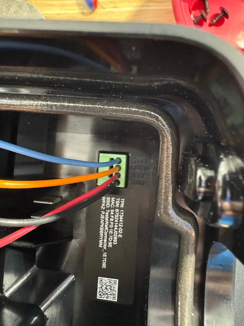

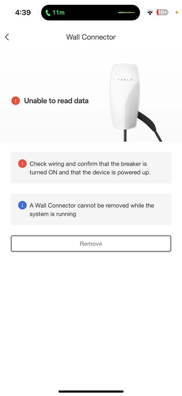

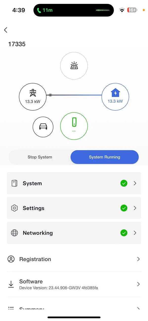

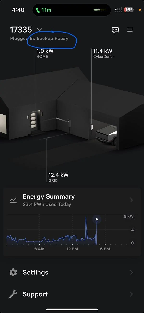

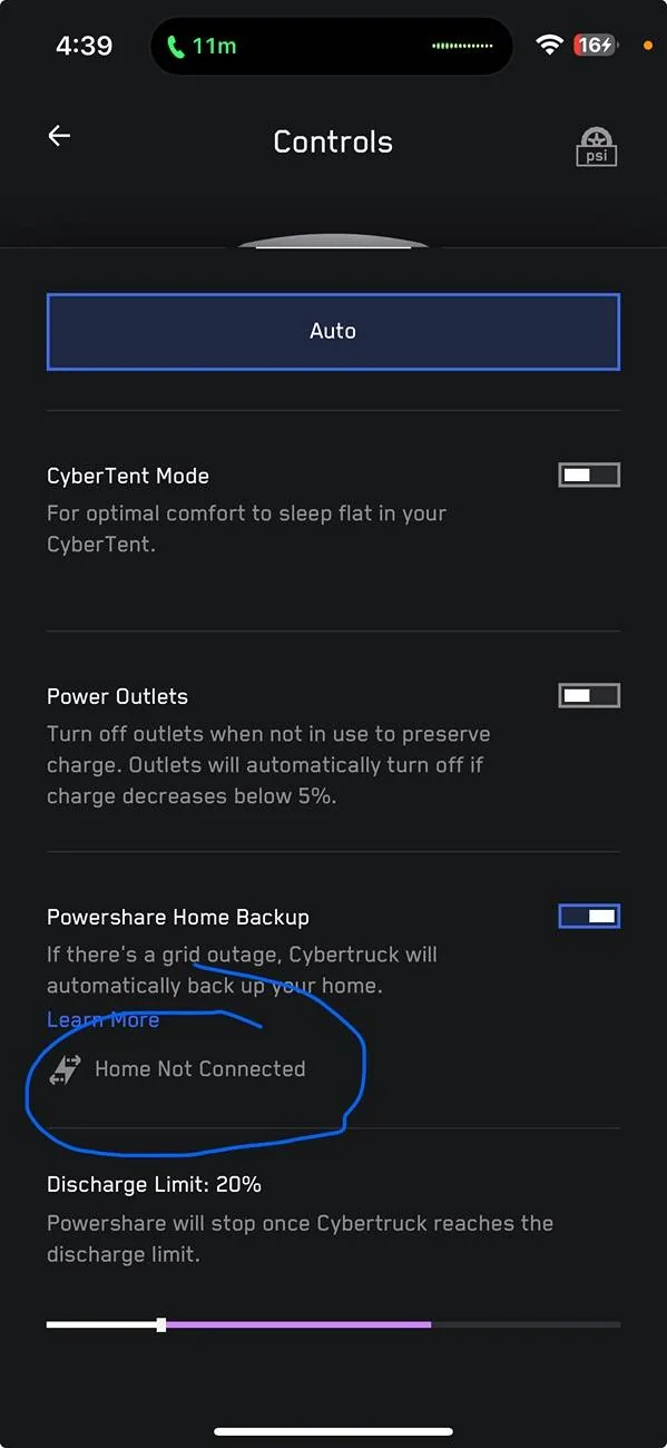

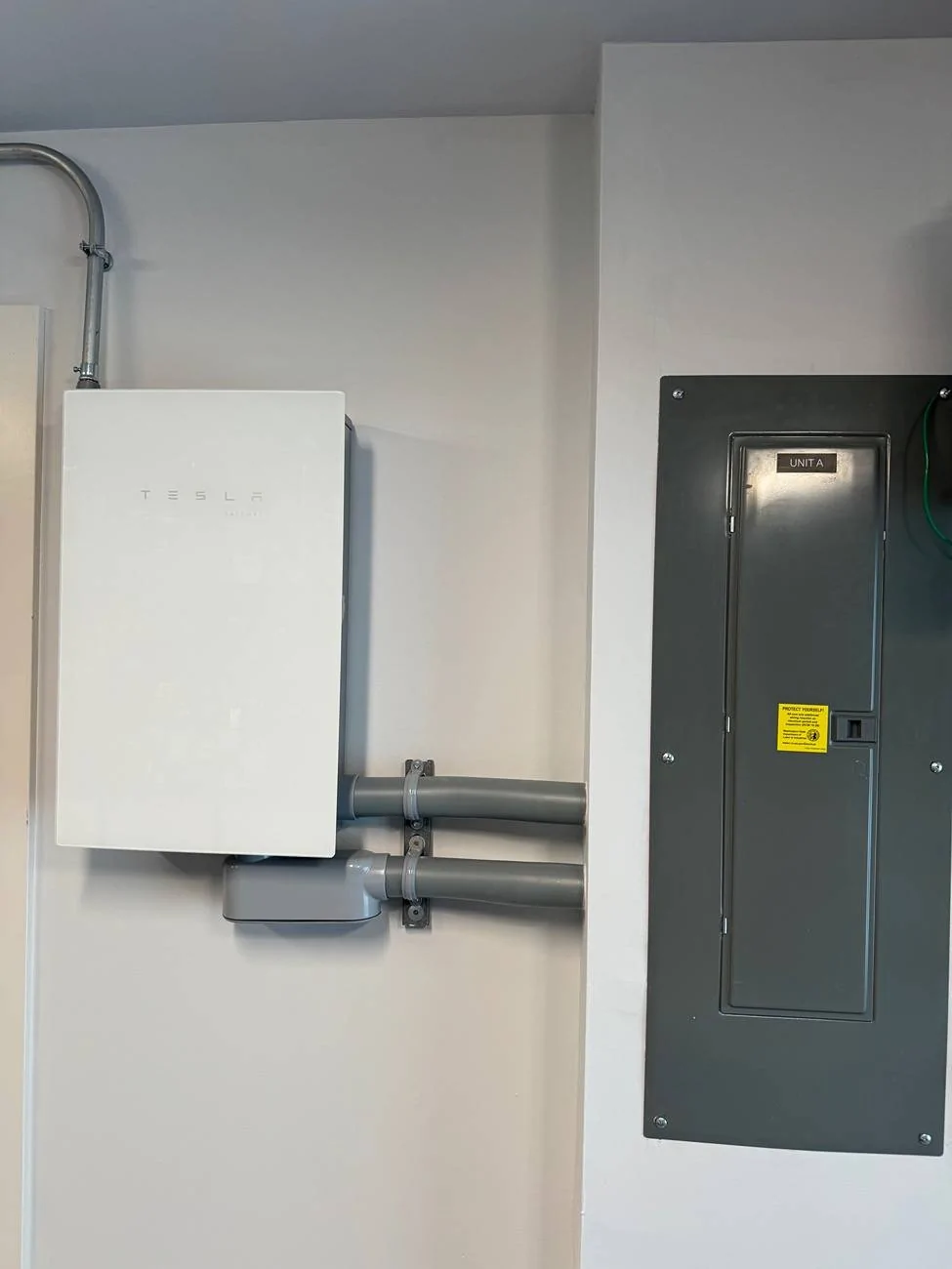

Had the electrician over for a callback to verify the low voltage signal wire. Tried running a new one outside the conduit and still having issues.

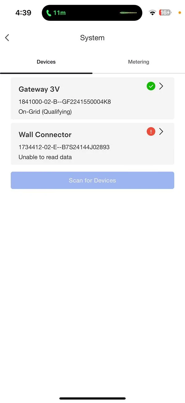

basically the truck doesn’t see the home, and there seems to be an issue with the gateway-UWC connection reporting “unable to read data”

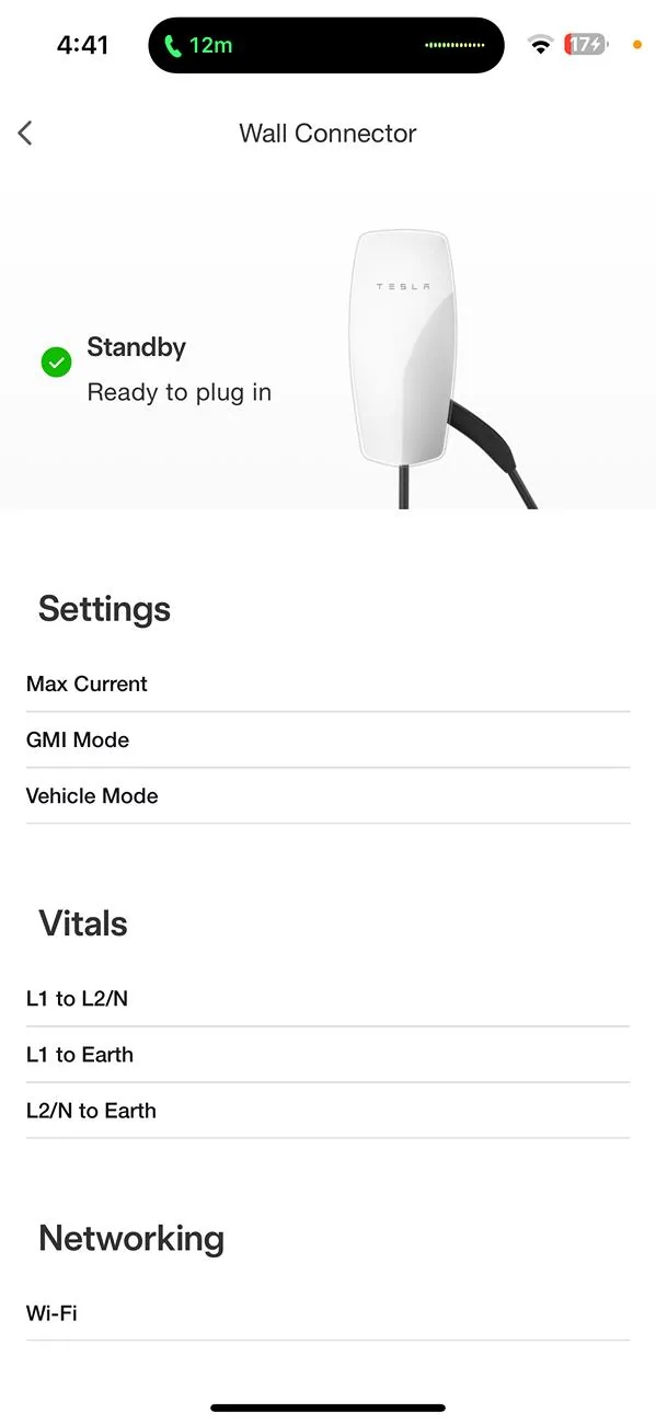

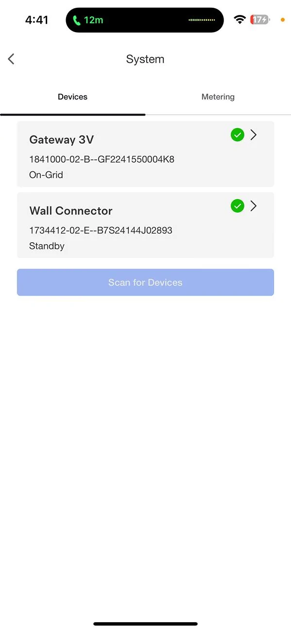

Removing the wall connector through the Tesla one app and adding it back is fine, the gateway is able to detect it through the signal wire.
so far Tesla phone support hasn’t been able to figure it out. Escalated to tier 2.
Any ideas? Have been in communication with the installer and they’re going to let Qmerit know. So far this sucks and I know it’s on Tesla and not the installer.
