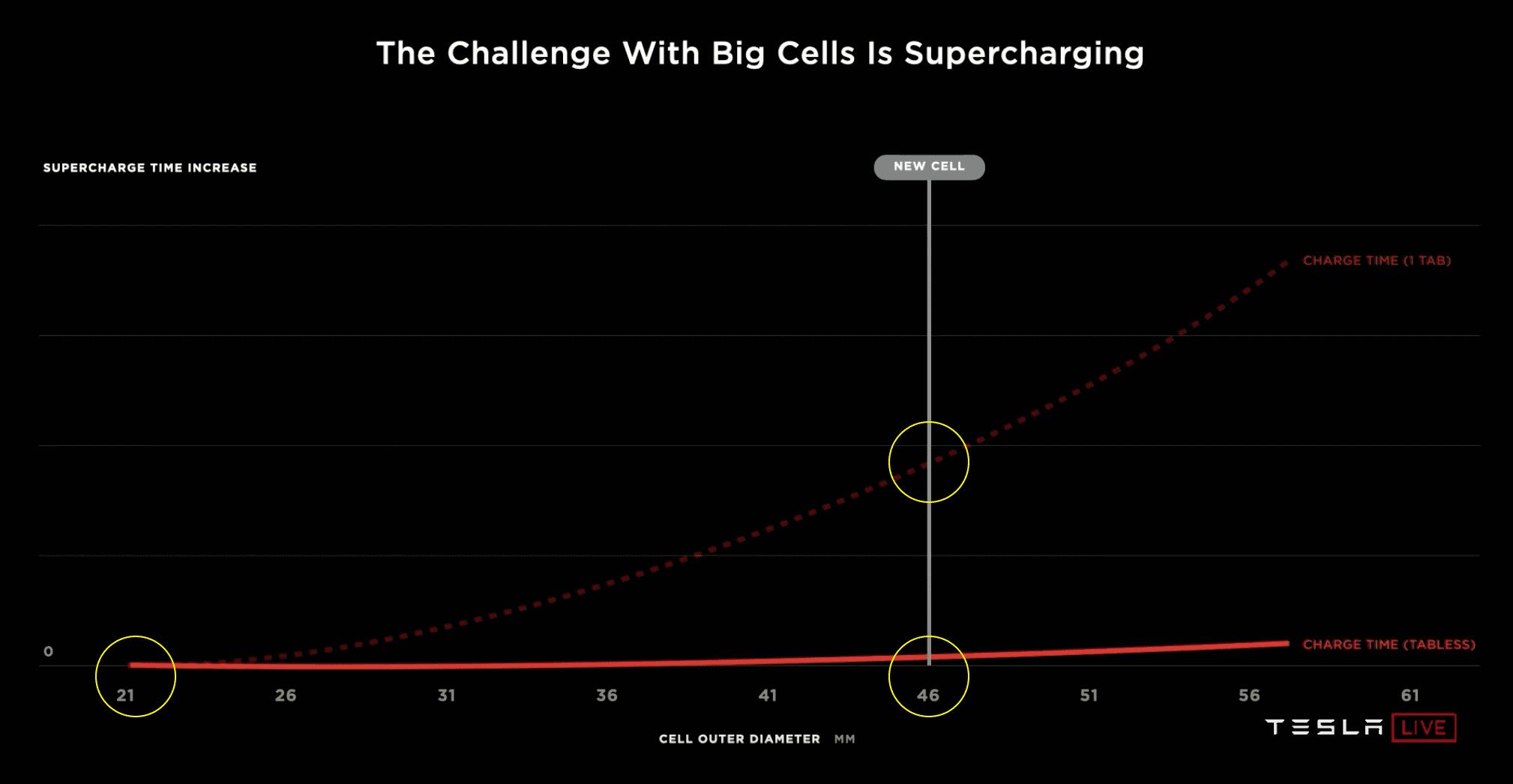

The chart was illustrating a relative relationship between charging time and diameter (with and without the tabless design feature). It's not an absolute graph with numbers, even the charge time of 2170 cells is not fixed, it has steadily improved as the format has been updated with chemistry and construction tweaks. The 4680 cell will improve too.
The chart is useful without numbers to illustrate Tesla's expectation for the tabless design in a 4680 format when the format is mature...
.... The chart makes it clear the tabless 4680 was expected to charge slightly slower than a single tab 2170... I was shouted down by people who had not used this very chart to inform themselves better.
I see that chart as more "dubious" than "useful". My gripe is about the chart being meaningful. RVAC and JBee are dead on about the chart. It doesn't say anything because no one can say if the Y-axis peak value is 10 minutes or 3 hours. That could be in 'cricket chirps' for all we know. There's no way to tell the actual degree of any of the infections, because you can't interpolate a single piece of data from it. Like I said, at best it says "Kinda Sorta Like This".
But that aside, Tesla is scraping every bit of real world charging data returned from the 4680 Y's, and they need to get the right chemistry for the 4680 format. Until then, Tesla's going to be super conservative with their existing 4680 charge rates. On top of that, I wouldn't expect the current batch of 4680 Ys to get much better because they may be hard-capped by the battery's construction and chemistry. The last thing they want is a "battery issue" in the news.
I totally agree with your sentiment regarding gen2 and gen3 4680s reaping the benefits of the format. I think the 4680 is a solid 5 years from maturity. Then we'll start to see the true potential unleashed. I said a while back I only plan on keeping my CT for 5 years max because it's 1st generation. The CT they build 4-5 years from now will be the ONE. The competition still working on their formats are way behind.

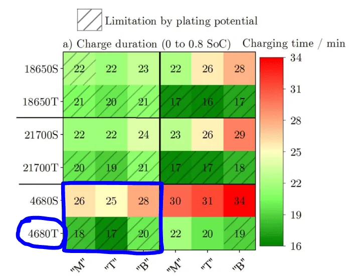

I'm the author of some of the graphs John used in his video
I recommend reading these two papers, the amount of ohmic losses heat generated inside the cells due to the tabless electrode is greatly reduced to almost nothing
Also as shown there, the most likely explanation with all the data we have is that Tesla is being extremely conservative with the 4680 charging curve and I tried to do some speculation/calculations oh how much it could improve

Geez guys, I take a day to sleep and play D&D and you're arguing about an almost three year old chart. I think my DM might let me do a Fey Blood Charisma build Druid Multiclass.
  • The "tab-less" design enables the 4680 to generate almost as little heat as the single tab 2170.
  • The chart is labeled, but unhelpfully.
  • The 4680 is worse than the 2170 - but only slightly.
  • The chart does show that the 4680 is a tiny amount worse but only slightly. The number of pixels is easily visible.
  • The 4680 Model Y also has about 10-20% fewer cells than its theoretical maximum, which is also not helping its charge curve.
  • Yes, Tesla is being conservative with their charge curves of the 4680 Model Y.
  • We have no confirmation of the charge curve or the layout of the "Cyber-cell" 4680 vehicles.

I expect the 4680 cells will allow faster charging due to less heat being generated during the charging process. I know my S ramps down really quickly once the cooling fans start to scream. The lower internal resistance of the 4680 cells could help.
RVAC
Aug 11, 2021
864
1,291
The graph is not really representative of much without charge time values, and shouldn't be considered evidence of the 4680 being slower at charging.
There are two factors here, one is that the max charge rate is limited by cell temperature, because making the cells hot causes irreparable degradation, and two; cell temperature whilst charging is created through a combination of conductor and chemical heating that is commonly expressed as battery resistance.
The graph is representative, just not quantifiable. Whether the difference shown is meaningful is a different matter. I only brought this up because of the often repeated claim that the tabless 4680 charges faster, relative to a 2170.
Thank you for proving my point! Charge time for a tabless cell increases negligibly as diameter increases from 21mm to 46mm.
You're missing the point. You can't say it's negligible without any scale on the y-axis. What we can say for sure is that a tabless 4680 does not charge faster than a 2170, which was your claim and what prompted my reply in the first place.
Note the dashed red line, representing a tabbed cell, increases significantly over that same span.
Don't see the point of noting that when I've stated as much, more than once.
In essence, the larger cell volume is offset by the reduced overall heat generated and better dissipation from the tabless design.
See my first reply to you:
It's a bit of a misconception, the tabless design does reduce internal resistance but it is negated by the increase in cell diameter. This graph from battery day actually shows a slight supercharge time increase, although it's hard to quantify given the y axis is not labeled.

Yeah, because it's more effective, the second paper goes into detail on the why, and also recommend this video that is a summary of the paper
But the TLDR is, while cooling the bottom seems more effective because the thermal path is shorter, the performance is worse due to the smaller surface area
You have to think about not only about thermal transfer, but also electrical insulation. I have no data to back this up, but I imagine if you could have a finned stack attached to the bottom of the cell, or being the bottom of the cell with coolant flowing through it, bottom cooling would be the most effective one
But when you consider that whatever you are using to cool the cell has to be electrically insulate, and that usually goes against thermal conductivity, it's better to go to the longer thermal path but allowing more surface area to make up for the worse conductivity between the cell and the cooling ribbons
From worse to best according to the paper it goes:
Bottom cooling (B) < side cooling (M) < top and bottom cooling (T)
Top and bottom is way too complex for a high volume manufacturing, take a look at the image bellow, I highlighted the most interesting part, these are shortest charge times for the 4680 with the tabless electrode on the last row, from page 8 of the second paper, keep in mind as the author says, these are theoretical times that likely won't be achieve on real life
Cooling from the side 18 minutes, from the top and bottom 17 minutes and from the bottom 20 minutes, it's clear that there is a diminishing return point
