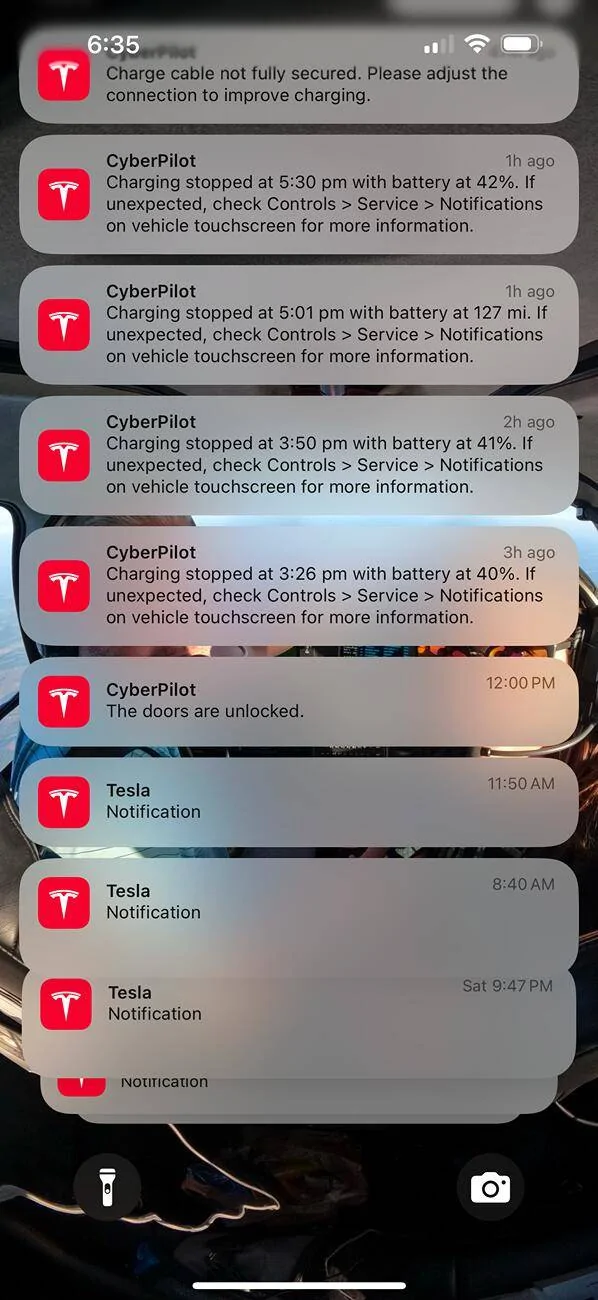

@CyberGus @getsometom @mongo
Thanks for the replies.
Attached is a screenshot of an alert I received
, and also a video of him plugging it in. He has moved to other spaces, and I believe he also drove down the road to another SC. I’m headed to meet him to get the truck back, but unfortunately he’ll be arriving to the SC at 2%.

Unfortunately, looks like this is going to be something for the service center. Maybe something hinky with your high-voltage system?
You said you’ve been charging normally at home, maybe you can find a destination charger instead of a supercharger and see if that works if you can’t get it all the way to your house. Or tow home (or maybe directly to the service center) w/ AAA?
Tesla Cybertruck Charging issues - Please help {filename}
I'm going to go out on a limb and guess there is either a loose connection in the HV charge path, or the internal Supercharging (charger bypass) contactor(s) are bad.

I assume the “charge cable not secured” message is an anomaly from repeated plug/unplug attempts. There were multiple “charging stopped” messages prior, without mention of the cable.
Regardless, this seems like a repair situation if multiple SC stalls produced the same result.
