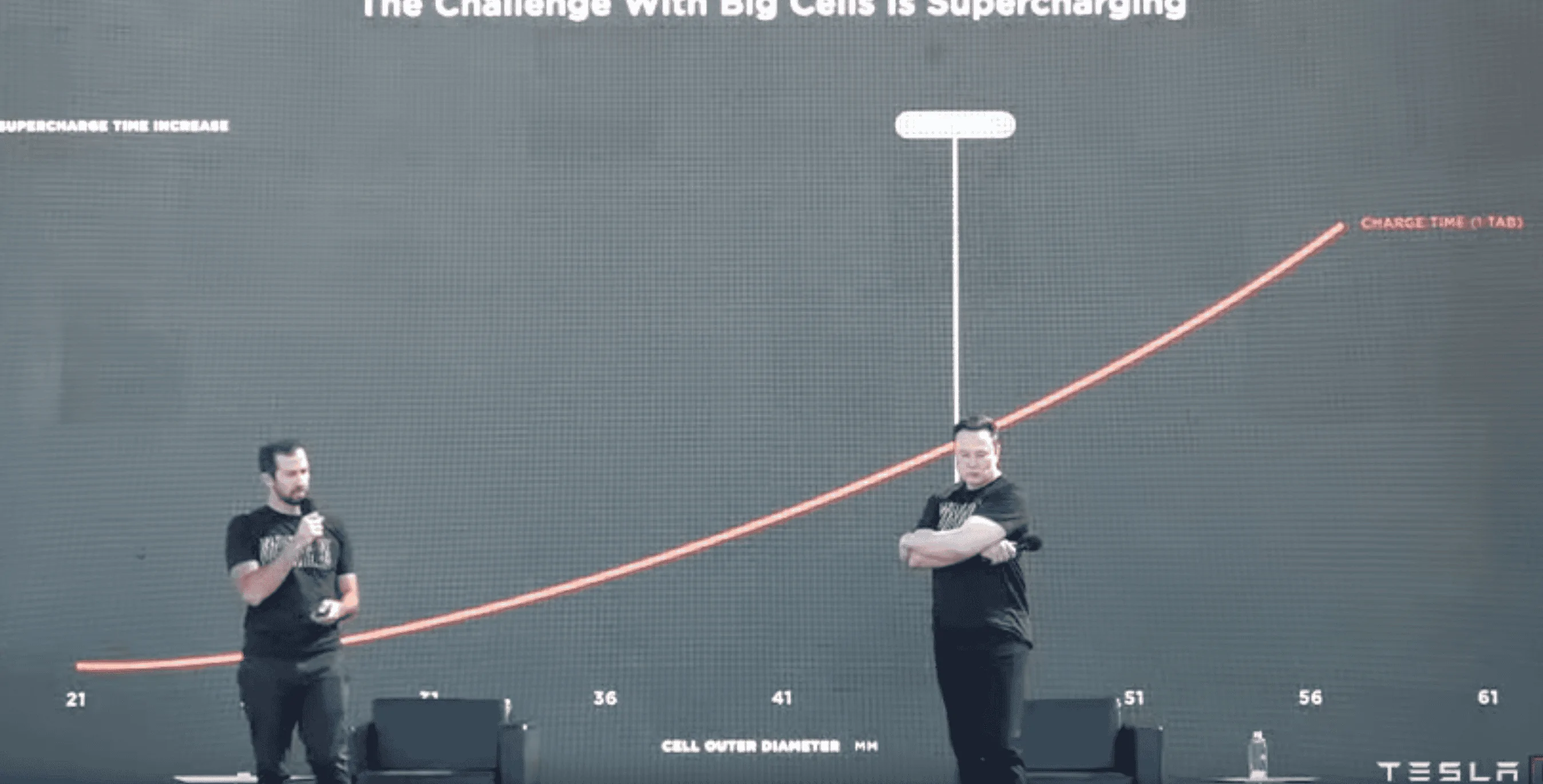

No, you have completely misunderstood the point of this chart. The 2170 cells are not the baseline, they are the dashed red line that grows significantly ("1 TAB"), showing that they have a much longer charge time than the tabless design.
The purpose of this entire presentation was to tout the features of the new cell.
That's not correct, the dashed line does not represent the 2170 cell. The dashed and solid lines only represent "1 tab" and "tabless", they're not specific to any single cell diameter, that is determined by the value on the x axis.
What the graph indicates is that a 4680 cell with a single tab charges significantly slower than a single tab 2170 cell and a tabless 4680 cell charges slightly slower than a single tab 2170 cell. We just can't quantify it given the lack of labeling on the y axis.
Which is not to say that Tesla cannot decrease 4680 supercharging time by improving other aspects at pack or cell level. However all else being equal a tabless 4680 will charge slightly slower than a single tab 2170. Also, just to clarify, I'm not saying the 10min difference (10-80%) we're seeing in the above videos can be entirely attributed to this. There could be, and likely are, other factors at play but it may, at least partly, explain why we're seeing a worse charging curve.

I’m sorry but you’re completely wrong on this.
  1. The dashed line shows an INCREASE in charge times as cell diameter increases for SINGLE TAB cells
  2. The solid line shows the charge times DO NOT INCREASE with diameter for the TABLESS cells
  3. ALL previous cells were SINGLE TAB
  4. ALL 4680 cells are TABLESS
  5. A RISE on the Y axis is WORSE since it correlates to a LONGER charge time
Can you please explain to me which of the above statements is incorrect?

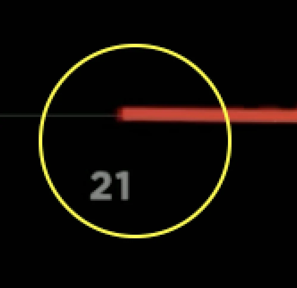

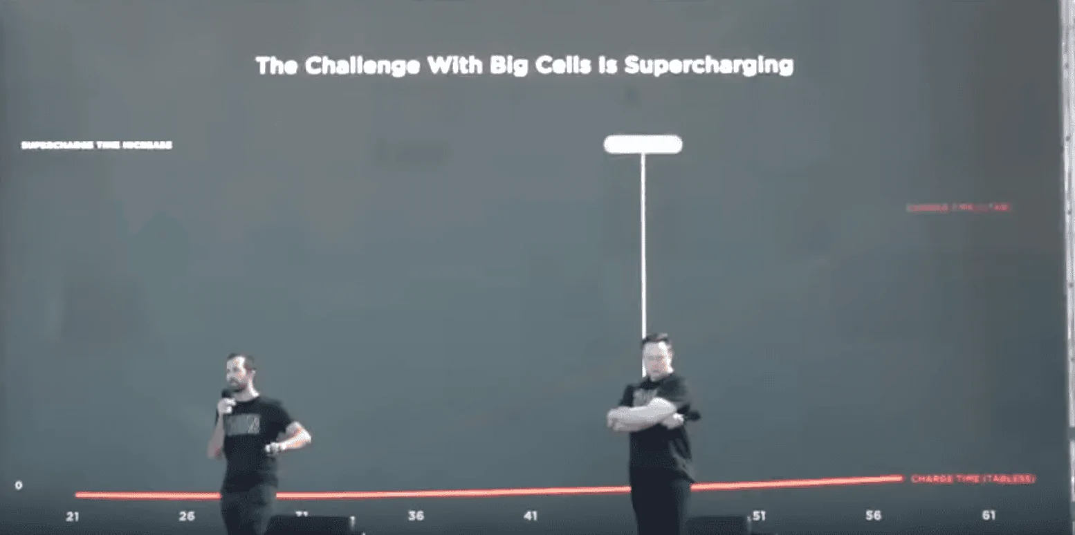

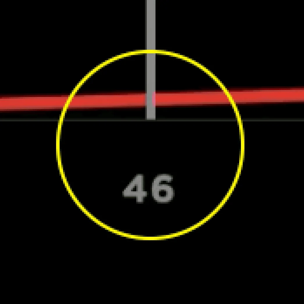

I'll try with images since words aren't working:
The graph is not really representative of much without charge time values, and shouldn't be considered evidence of the 4680 being slower at charging.
There are two factors here, one is that the max charge rate is limited by cell temperature, because making the cells hot causes irreparable degradation, and two; cell temperature whilst charging is created through a combination of conductor and chemical heating that is commonly expressed as battery resistance.
The tabless design lowers the resistance by offering much shorter conductor length, in that every layer of the cell jelly roll has at least its own tab. A tabbed cell only has one at either end of the roll making the conductor much longer, and therefore has more resistance that increases heat generation.
Because of this a tabless battery doesn't create as much heat as a tabbed cell. Meaning, that technically it shouldn't degrade with temperature as fast as a tabbed cell. It also means that it should be able to sustain a higher charge rate for longer. But, because the 4680 is also bigger, it also has less exterior surface area compared to its volume than a smaller cell like the 2170. This means that the 4680 surface has less capacity to remove heat from the cell.
Luckily, the tabbed design doesn't create as much heat in the first place, which is also better for efficiency, and cooling loads, and therefore doesn't need much cooling over the whole pack. This reduces energy loss and means the cars HVAC can cool the battery with less power and avoid thermal throttling of the max charge rate. (Hence the battery preconditioning before arriving at a SC). Unlike the tabbed cell, the tabless design also provides a highly conductive path for heat to escape directly from the interior of the cell to the outside where it can be cooled which helps significantly.
The net effect of the design is that they can do what they previously couldn't, because of thermal issues with tabbed cells, and that is build a larger diameter cell, which performed the same, but was significantly higher capacity, but at much lower overall pack cost.
There needs to be distinction here, in that a single 4680 cell has some 5.5 times the energy capacity of a 2170 but is expected to be less than double the cost per cell. That's a huge cost improvement per cell.
For the customer this means that they can also afford to have more battery cells for the same money, and therefore a larger pack with more range. The CT will likely have double the MY 4680 pack to achieve even 350miles. It's likely though that the CT will only use 50% more or so than a MY per mile.
A larger pack also means faster MPH charge times, and less charge ramp down on high battery levels, resulting in overall faster travel times when you include charging times, from point A to point B. Even if the 4680 cell charges at the same rate as a 2170., like some claim. This is not self evident in the graph or release literature, but the net effect for the CT should be better travel times when including charging stops.
10,271
34,013
Thank you for proving my point! Charge time for a tabless cell increases negligibly as diameter increases from 21mm to 46mm.
Note the dashed red line, representing a tabbed cell, increases significantly over that same span.
