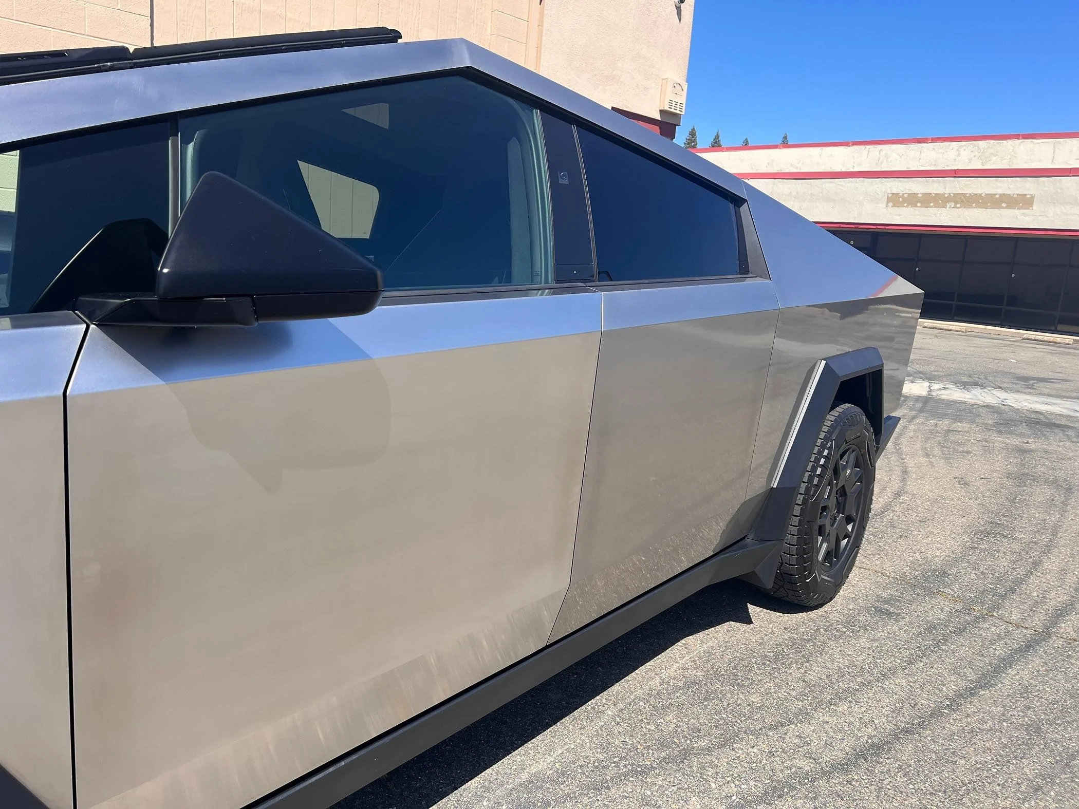

I would love to see some before and after photos. Curious if the SS sheen changes after the application.
Here is a picture where we had to remove the ProtectaClear from the front door so Tesla could repair some factory issues, but the rear door and panel is still coated with PC. You can see it is slightly darker. The rear panel is completely cured so this is the final finish.
