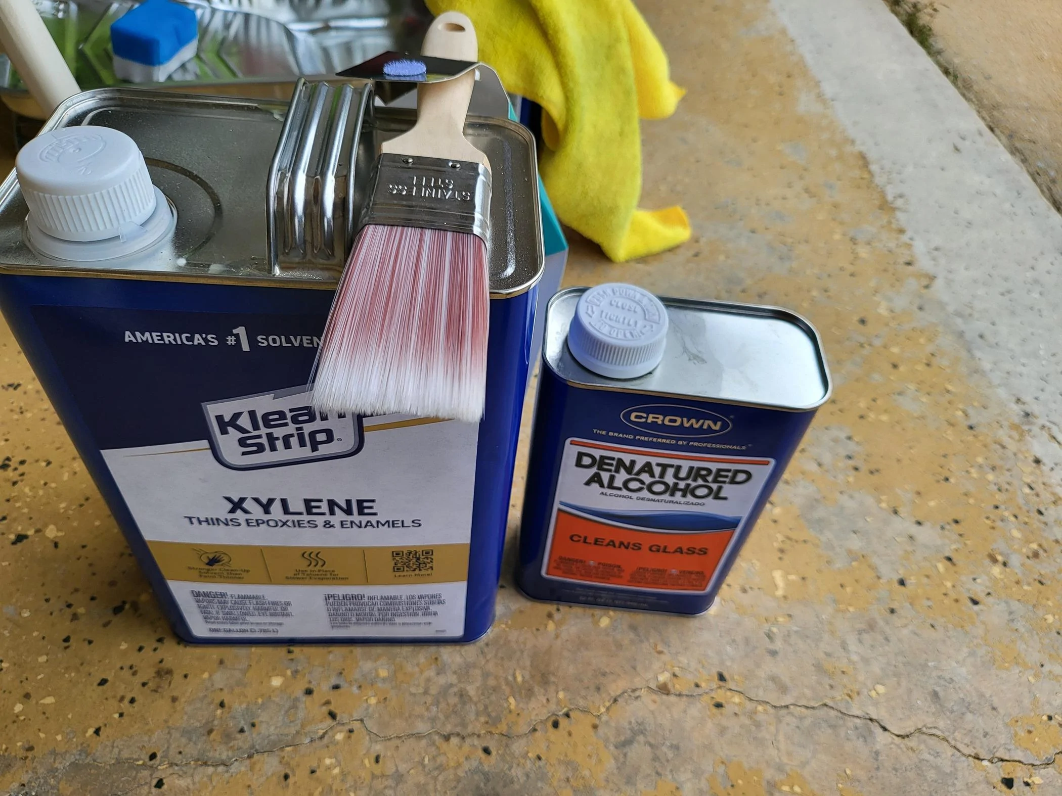

Thank you for reaching out to me personally regarding my issues and your solutions, suggestions and ideas. As I told you by phone, I have purchased my Xylene and brush. I'll take your advice and just cut down the places I applied too much or messed the finish and reapply. Thank you for your time and help.
