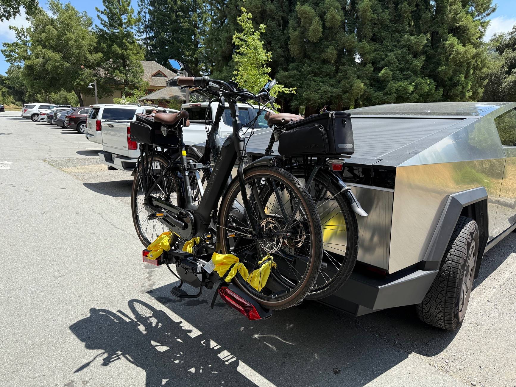

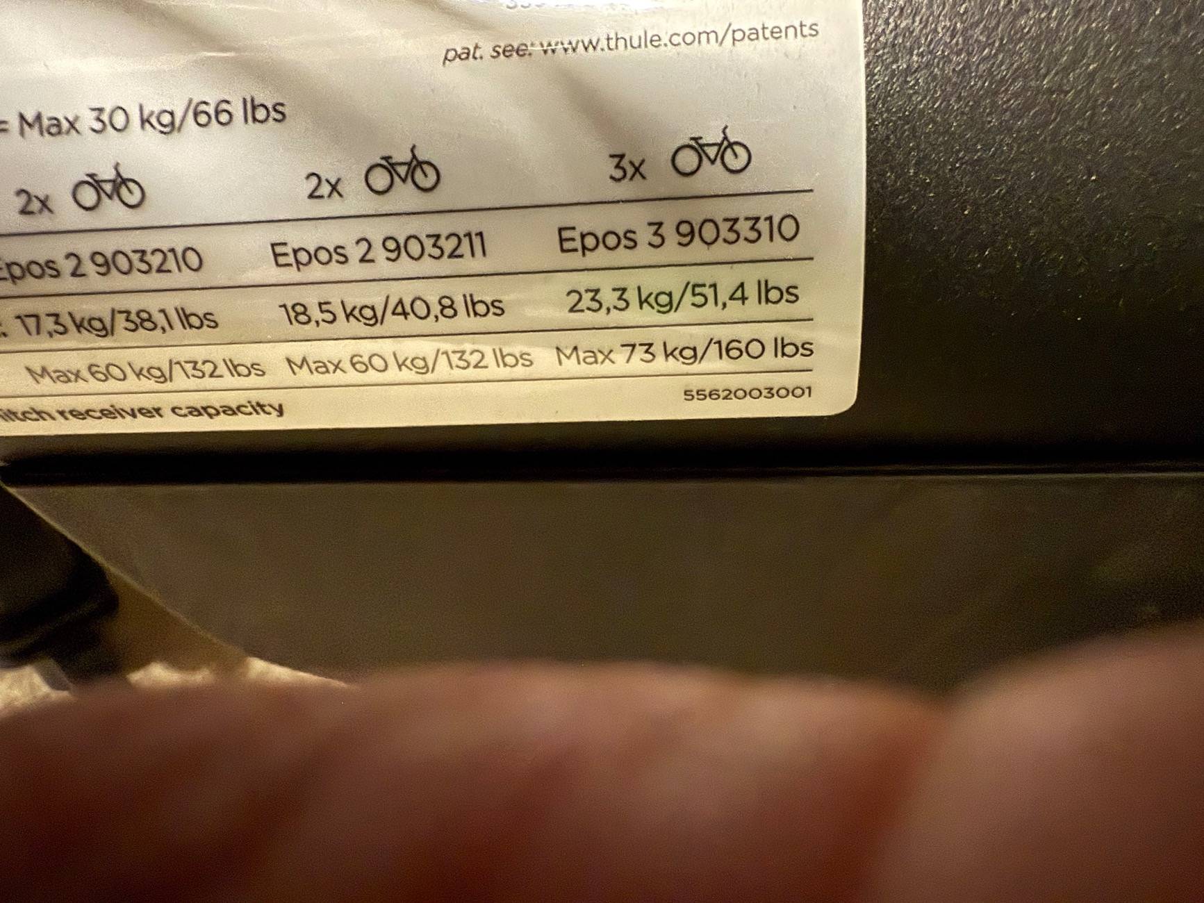

I use a Thule (Epos 2 903211) 2-bike rack, with two e-bikes. Rack is 40lbs, bikes max 60lbs each. When checking in the “mirror” it wobbles a little bit, but feels very stable.
