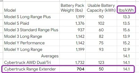

What if that additional 700 lbs in weight for the extended battery (if made permanent when the truck was delivered) made the truck cross the boundary into a class 3 vehicle? Maybe Tesla is trying to avoid that...
The AWD and CyberBeast both have a GVWR of 9,169 lbs, which puts them in the Class 2b category (8,501 to 10,000 lbs). The GVWR is the maximum weight that would be OK if the truck was driven onto a scale; it includes the weight of the vehicle itself plus the weight of any passengers and cargo.
If you added a 700 lb range extender to a Cybertruck, the GVWR would still be 9,169 lbs. But the vehicle weight would increase by 700 lbs, and the available capacity for other cargo and passengers would decrease by 700 lbs.
In theory, Tesla could offer a Cybertruck package with stronger components and 700 lbs of additional GVWR (similar to the "Heavy-Duty Payload Package" that Ford formerly offered to boost the GVWR of the ICE F-150). If you combined a range extender with that package, then you could still have the same passenger/cargo capacity as a regular Cybertruck. And the 700 lbs of extra GVWR would only bring the GVWR up to 9,869 lbs, which would still be below the Class 3 threshold (of 10,001 lbs).
Of course, this is totally hypothetical. The point is simply that the range extender is not going to turn the Cybertruck into a Class 3 vehicle.

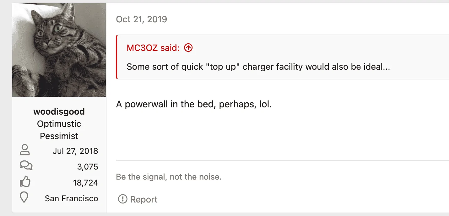

As predicted on TMC, before the launch:
Tesla Cybertruck Range extender upgrade Screenshot 2024-01-04 at 12.11.55 PM
