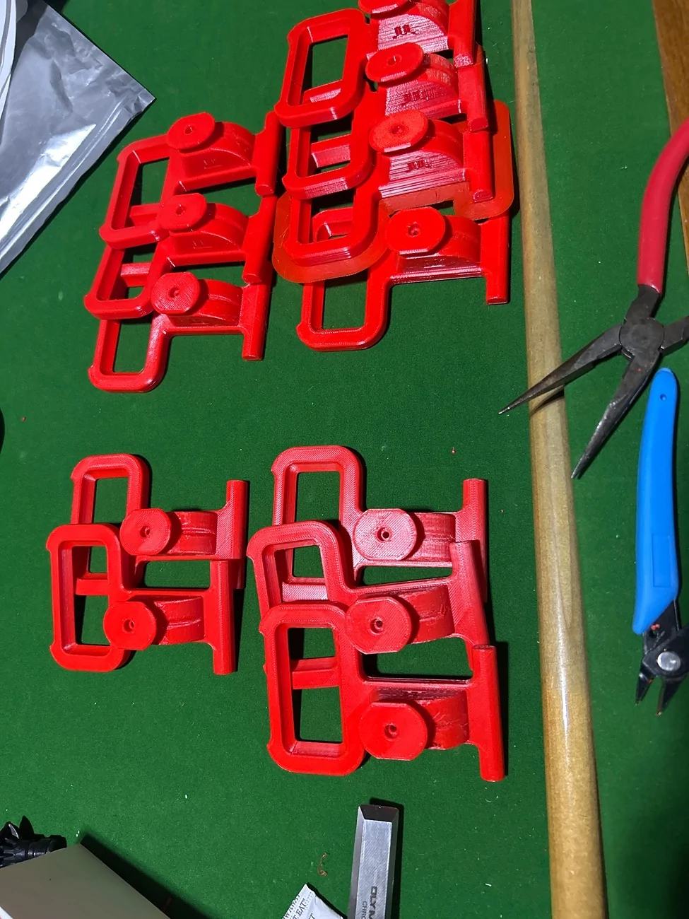

To all the people that asked me to make these, I am making progress. Learned some good lessons in last 48 hours of “mass” production vs knickknacks for the hobby. Anyways, Friday I will be shipping out the first few.
And yes my pool table has now become the assembly and QC floor 😂

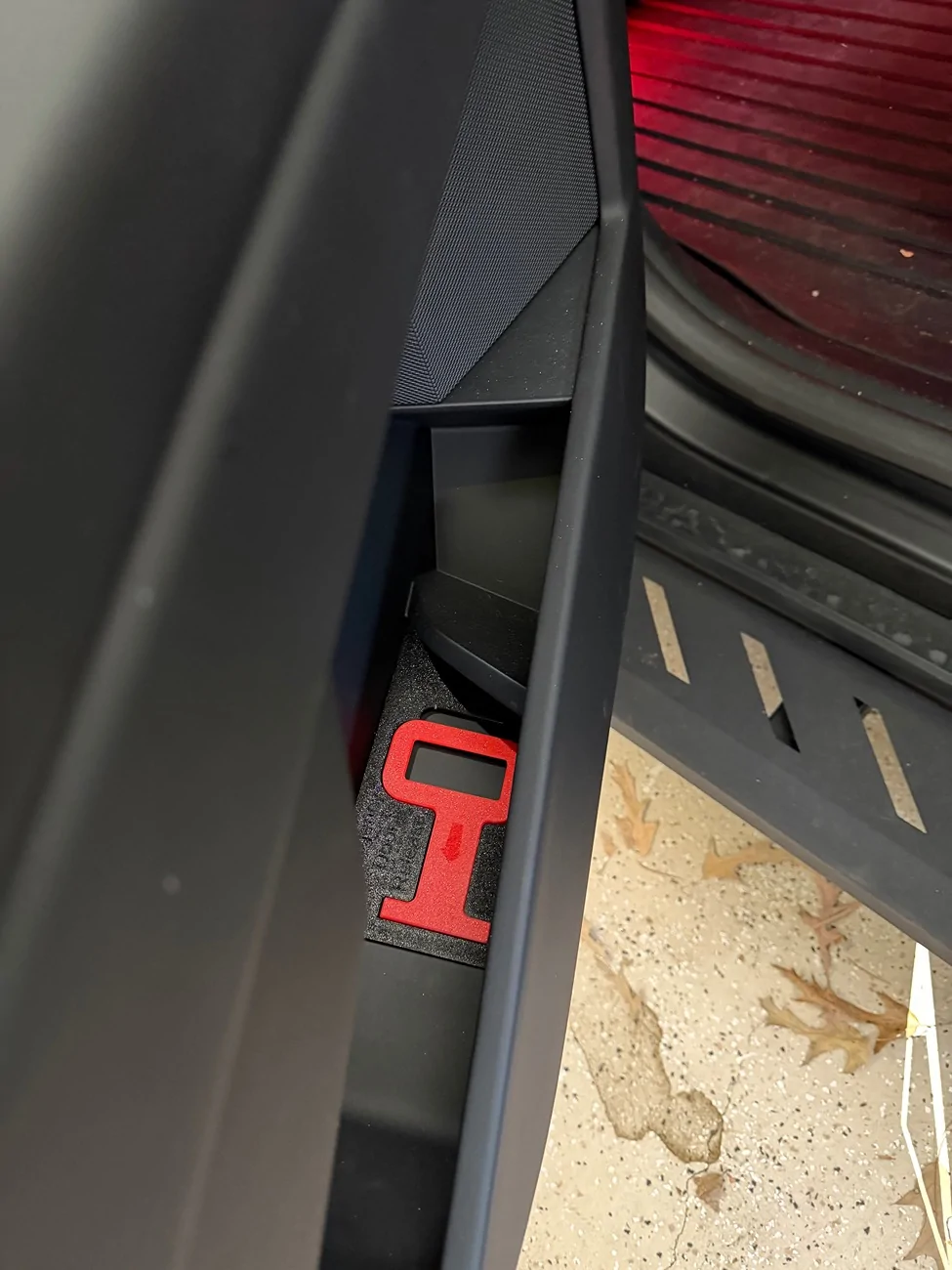

Decided to try out PCTG on one side of my truck. It is supposed to offer superior impact strength, higher heat resistance, and better chemical resistance (although I do not anticipate any issue with PETG either - it has been my go-to material for a long time). While I was at it I thought I would try glow-in-the-dark filament for the text. Works but only for a few seconds after energizing. Was just barely visible after the footwell lights went out. The shot below was taken shortly after energizing with a UV flashlight. Somewhat disappointed - was hoping it would last a bit longer.

@TickTock - thanks for putting this design out for us. I've printed a dozen or so for people now.
I'm going to try printing in PC, just ordered a couple rolls. I have an Ender 3 v3 plus - I just need to do some venting and make an enclosure so the family isn't breathing in the fumes. I tried printing in ABS, but my printer did a poor job since it's not enclosed.
I have some glow in the dark petg - and was very disappointed with how long it lasts as well. It is pretty cool to show it off to people, but needs a lot of light to "charge" it.

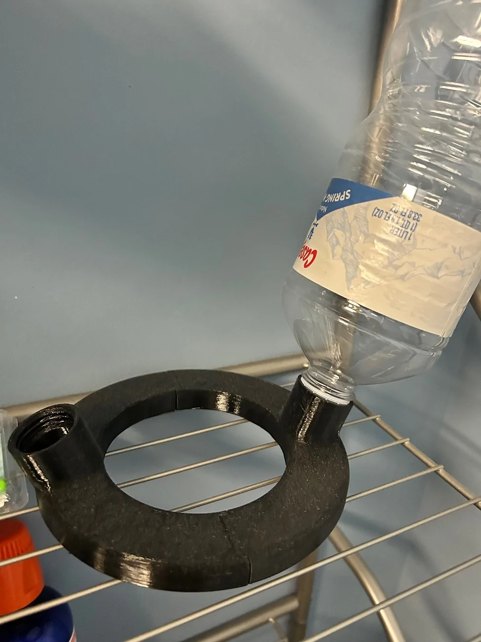

I also printed your water trickle design, came out great:

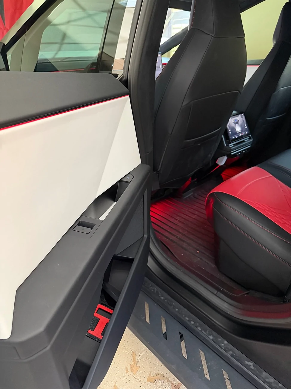

Just got my prints from @CTOmaha (thanks!), they took about 2 minutes to install and work incredibly well. Easily visible to rear seat passengers in an emergency, and they click in place solidly using the existing slots in the door. Plus they match my interior nicely 😊
