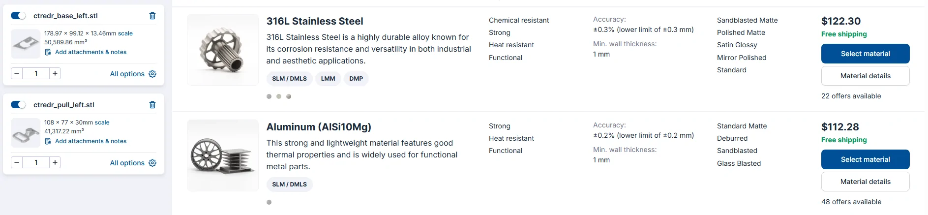

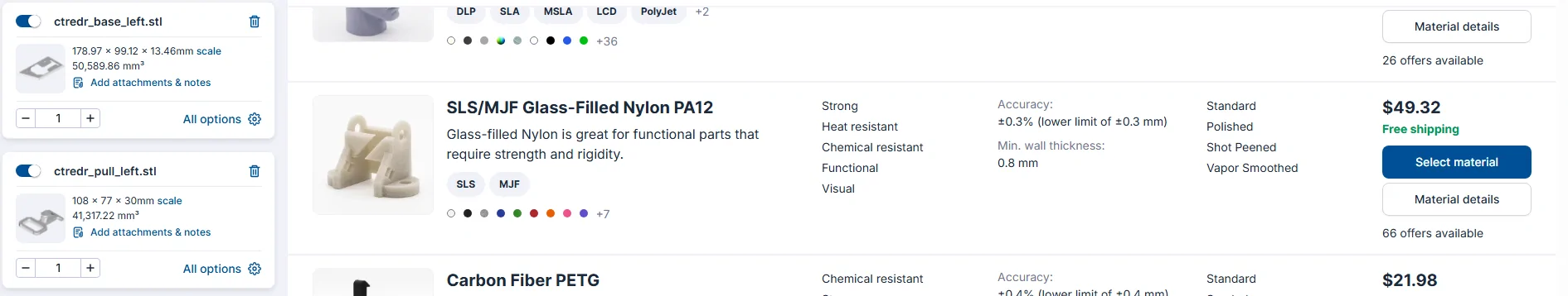

I've been looking around at options for manufacturing method and material on Craftcloud. My go-to for durable parts for automotive use has been SLS Nylon GF, but a few years ago I started using MJF Nylon. Recently they even added glass fill as an option for MFJ, but the issue is the lack of cheap multi-color printing and bad dye coloring on MJF.
If you didn't care about color and just wanted thermally stable and strong parts, I'd print it in glass filled nylon (probably MJF since it has tighter tolerances than SLS) for probably under $100 for everything. However there is always the baller option of sintered aluminum or stainless from China for around $70-100 per handle. I was shocked that it was this cheap to get metal 3d printed parts tbh, but I keep most of my orders US based for speed. Imagine polishing some SS or finishing it to match the exterior of the CT??? 🤑. At that point is probably cheaper to use 2 sheet metal parts from SCS and bolt on the contoured piece that engages the yellow door release loop.
I agree with @eswimm about using PC as being better, though I trust that PETG (especially with that bolt/nut reinforcement) is fine and probably much easier for most to print with. Even though I love the quality of prints of my X1C and the great surface finish that chop filled carbon fiber nylon filament can make, I still prefer SLS/MJF for their more isotropic like performance and more uniform surface finish.
