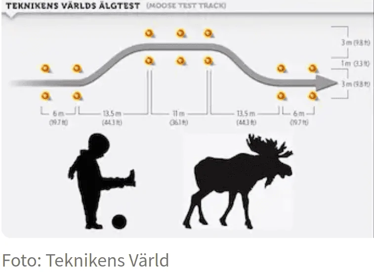

Haha, no, sadly it doesn't have to do with moose per capita. Otherwise we would have to do a (Canada) Goose Avoidance Test here!
Decoding The Moose Test: The Biggest Winners And Losers
Very interesting.
Moose Test
The evasive manoeuvre test (Swedish: Undanmanöverprov; colloquial: moose test or elk test; Swedish: Älgtest, German: Elchtest) is performed to determine how well a certain vehicle evades a suddenly appearing obstacle. This test has been standardized in ISO 3888-2.[1]
Forms of the test have been performed in Sweden since the 1970s.
https://en.wikipedia.org/wiki/Moose_test
Ongoing testing
Swedish automotive magazine Teknikens Värld tests "hundreds of cars every year".[2] with the moose test. It publishes test results since 1983 on their website (http://www.teknikensvarld.se/ ).
Actual moose collision testing
Although the moose test itself is based on the avoidance of hitting an obstruction in the road, testing is also carried out on actual collision with animals in the road. Both Volvo and Saab have a tradition of taking moose crashes into account when building cars.[20]
The Swedish National Road and Transport Research Institute has developed a moose crash test dummy called "Mooses". The dummy (which is made with similar weight, centre of gravity and dimensions to a live moose) is used to simulate realistic moose collisions.
Australian car manufacturers use crash test kangaroo dummies for similar reasons.[21]
Resultat i Teknikens Världs älgtest
Hur klarar din bil en kraftig undanmanöver? Ta del av Teknikens Världs lista över i vilken hastighet hundratals olika bilar klarar älgtestet.
(Results in Teknikens Värld's moose test How does your car cope with a sharp evasive maneuver? Take part in Teknikens Värld's list of the speed at which hundreds of different cars pass the moose test.
Moose test - list of the fastest and slowest cars)
By Mattias Rabe of Teknikens Värld magazine
http://www.teknikensvarld.se/algtest/
