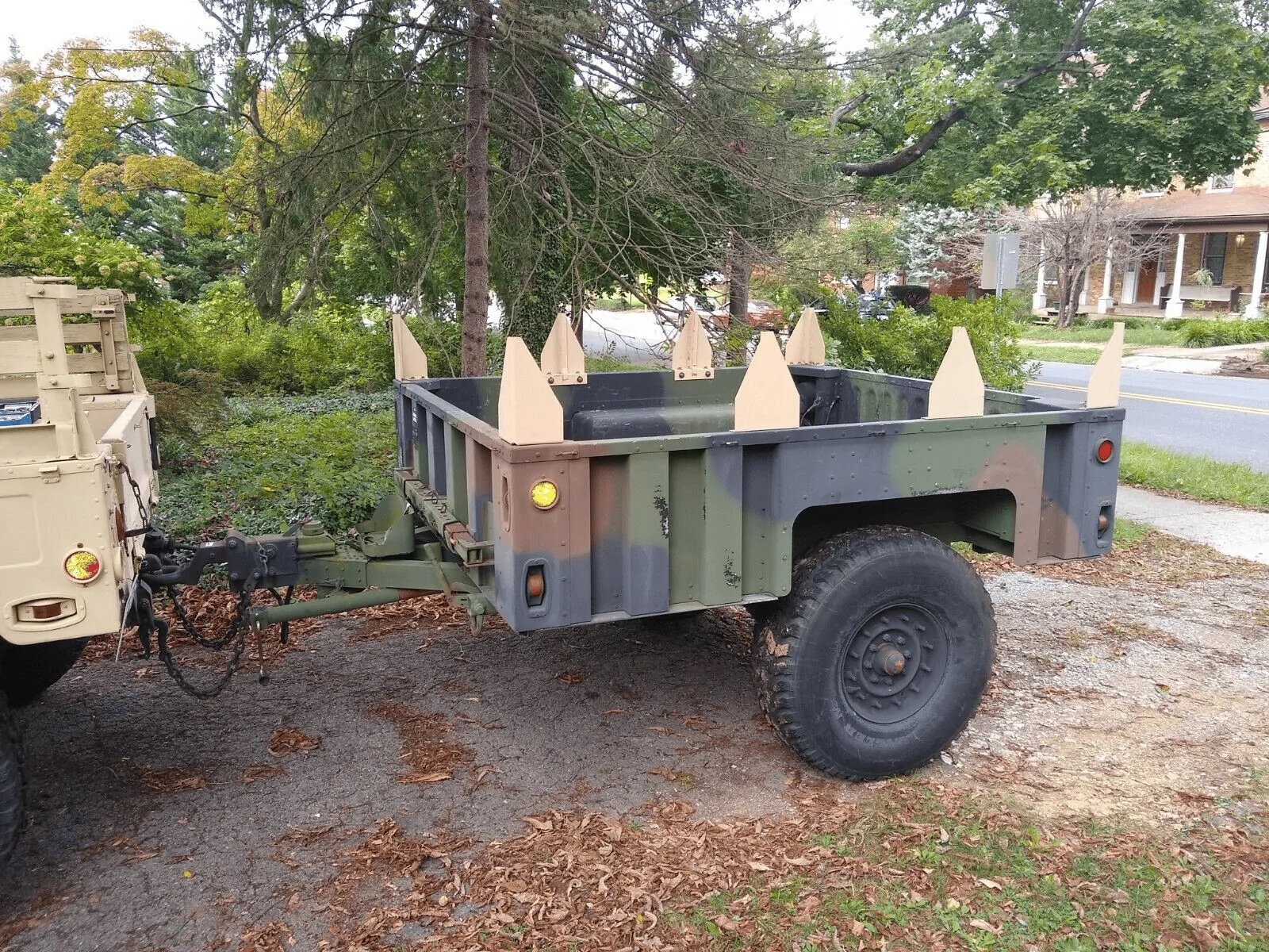

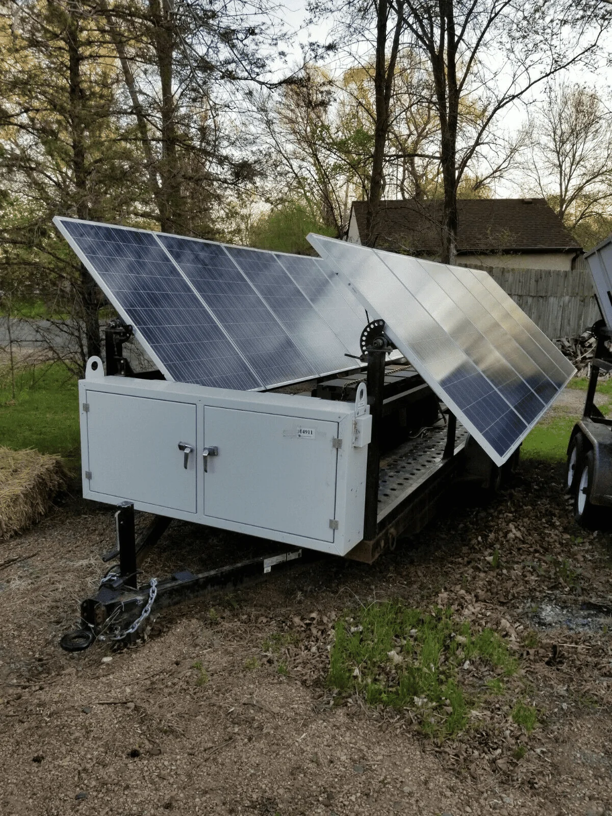

Quick Google search comes up with some builds that I would have to dig into deeper. Here's a 2.5 kW rig that could likely be optimized. Firstly, the trailer is too long for my purposes (overlanding), so I would have to build it in a way that it either fits in the bed of the CT, or on an overland/offroad trailer (think: military M1101/1102 aluminum trailers).
Tesla Cybertruck Remote solar recharging 1609526075136
I've owned an M1101/2 before. They are extremely lightweight (1500 lbs.) and maneuverable. This would be the platform for the solar array build.
Tesla Cybertruck Remote solar recharging 1609526379749
