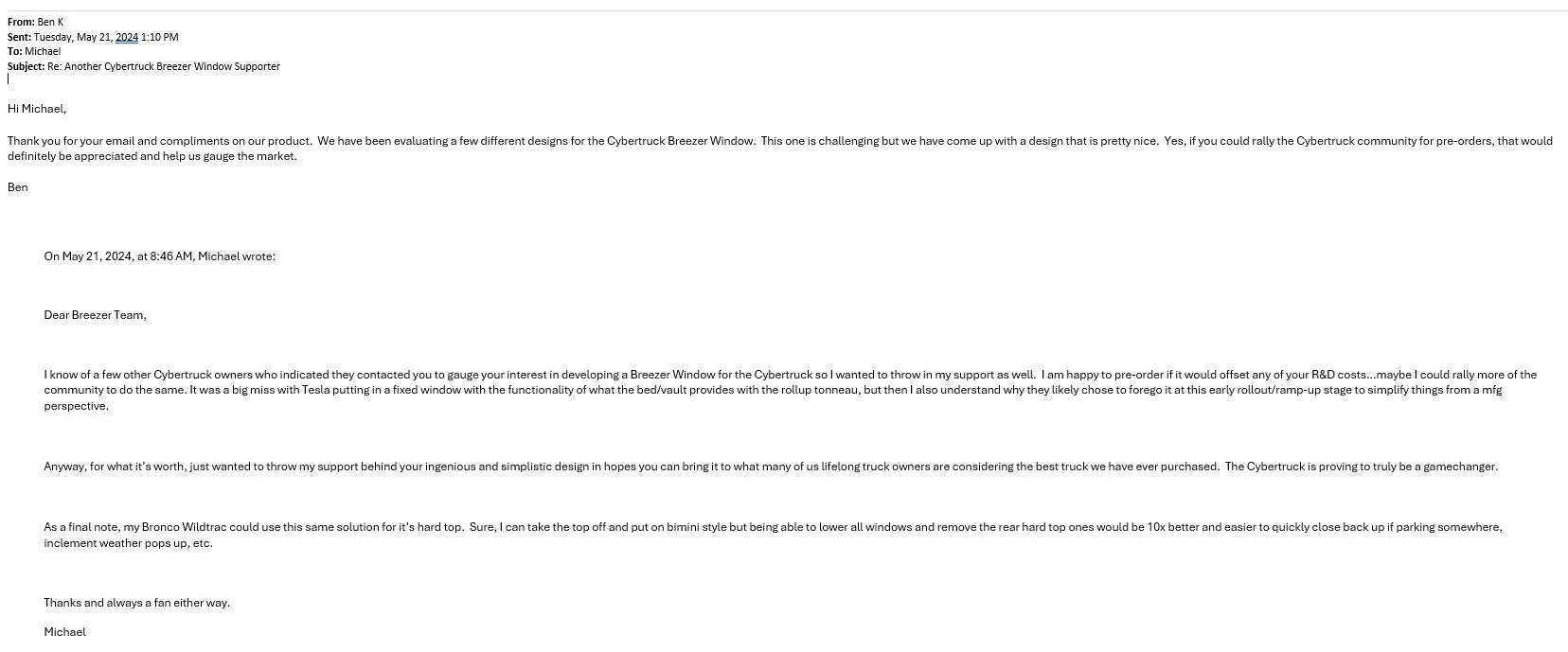

I shot Breezer Windows an email to further our combined interest in them bringing a alternative Cybertruck rear window to market and they have asked if we possibly support them with pre-orders it would help them gauge the market to produce it (they already have design of it ironed out it seems). Attached is my email with them today for reference.

How much to preorder? How much is the product? When will it be ready? Is a reservation refundable?
I followed up with an email of support as well.
