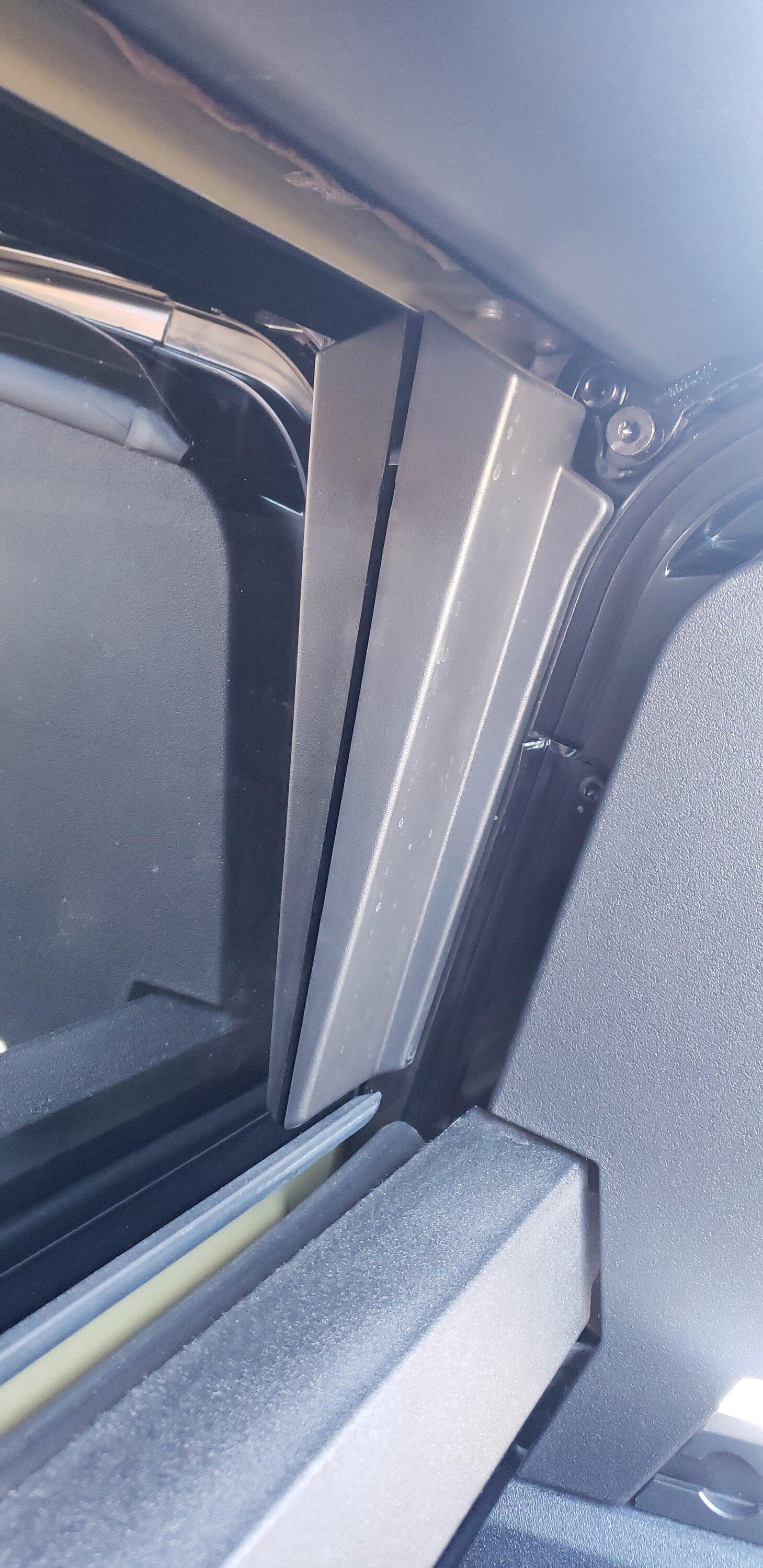

I want to remove the rear window on my Cybertruck so that there's a way to cool the vault from the cabin HVAC (Camping Mode). It would also provide a pass-through from the vault to the cabin that would be useful when sleeping in the vault. I examined the way Tesla mounted the glass panel and it looks like it can be removed from the vault side with not much trouble. It involves removing the plastic applique (photo) to expose the confinement elements. It also appears that the glass panel is not a structural component (it does not appear to be supporting the glass roof).
It looks to me like an aftermarket slider replacement window could easily be designed to replace the fixed glass panel. I'll follow up when I have more information on the removal.

I removed one of the plastic appliques and discovered that the backlite glass is held in place with an adhesive at each end. I'm not sure how to break the adhesive bond. Anyone have

I removed one of the plastic appliques (it's held in place with double sided tape), and discovered that the backlite glass is attached to the steel frame with an adhesive at both ends. The bottom of the glass is inserted into a rubber seal, and the top there's a paper thin gap between the glass and the steel frame, and I don't think the top is glued. I'm not sure how to break the adhesive bond. Anyone have a suggestion (without breaking the glass).
With plastic applique:
Tesla Cybertruck Removing / venting rear window to cool/heat vault for DIY camp mode? Backlite Applique
With plastic applique removed:
Tesla Cybertruck Removing / venting rear window to cool/heat vault for DIY camp mode? Backlite Glued
