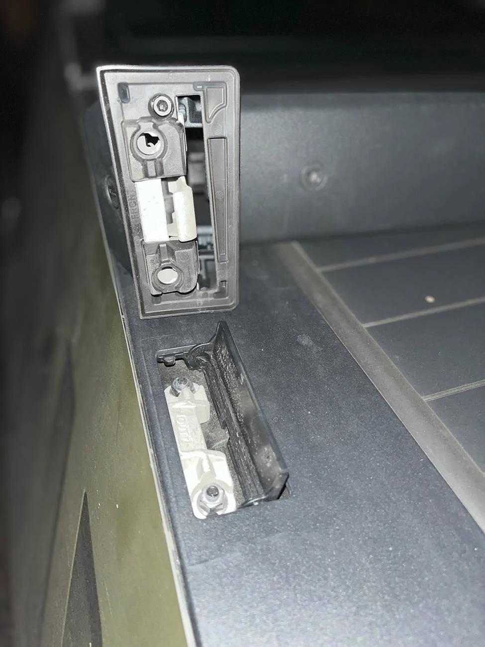

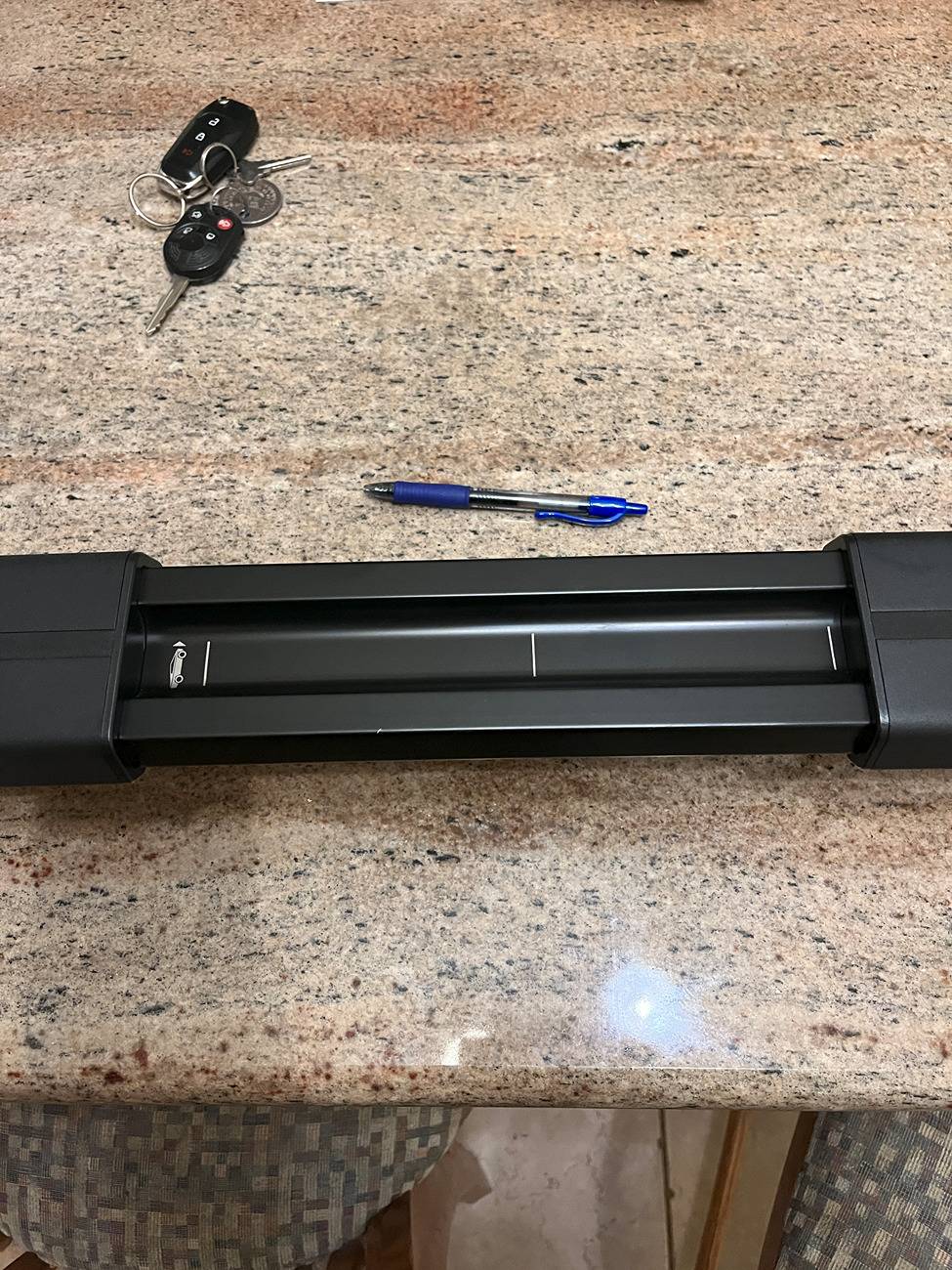

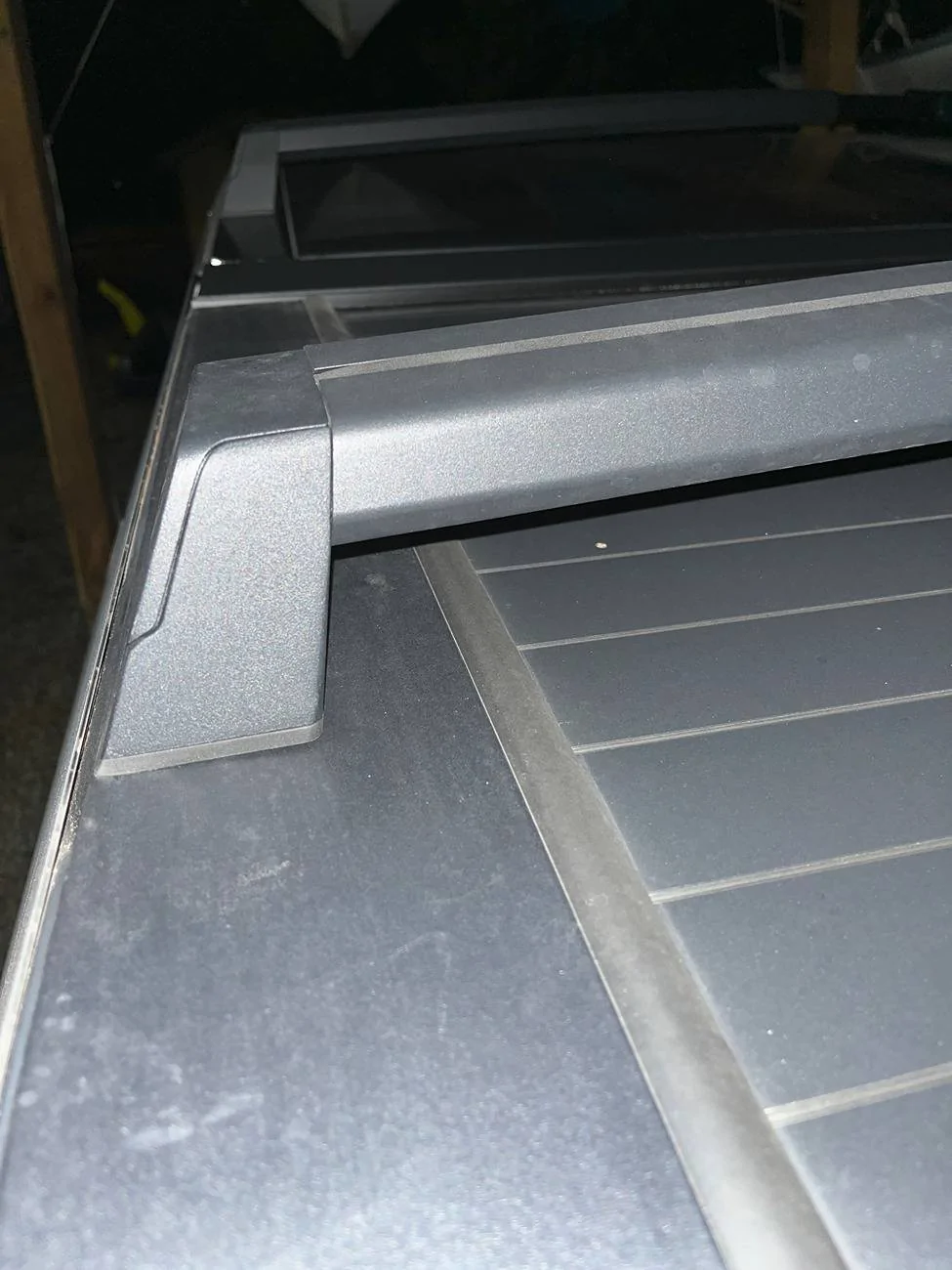

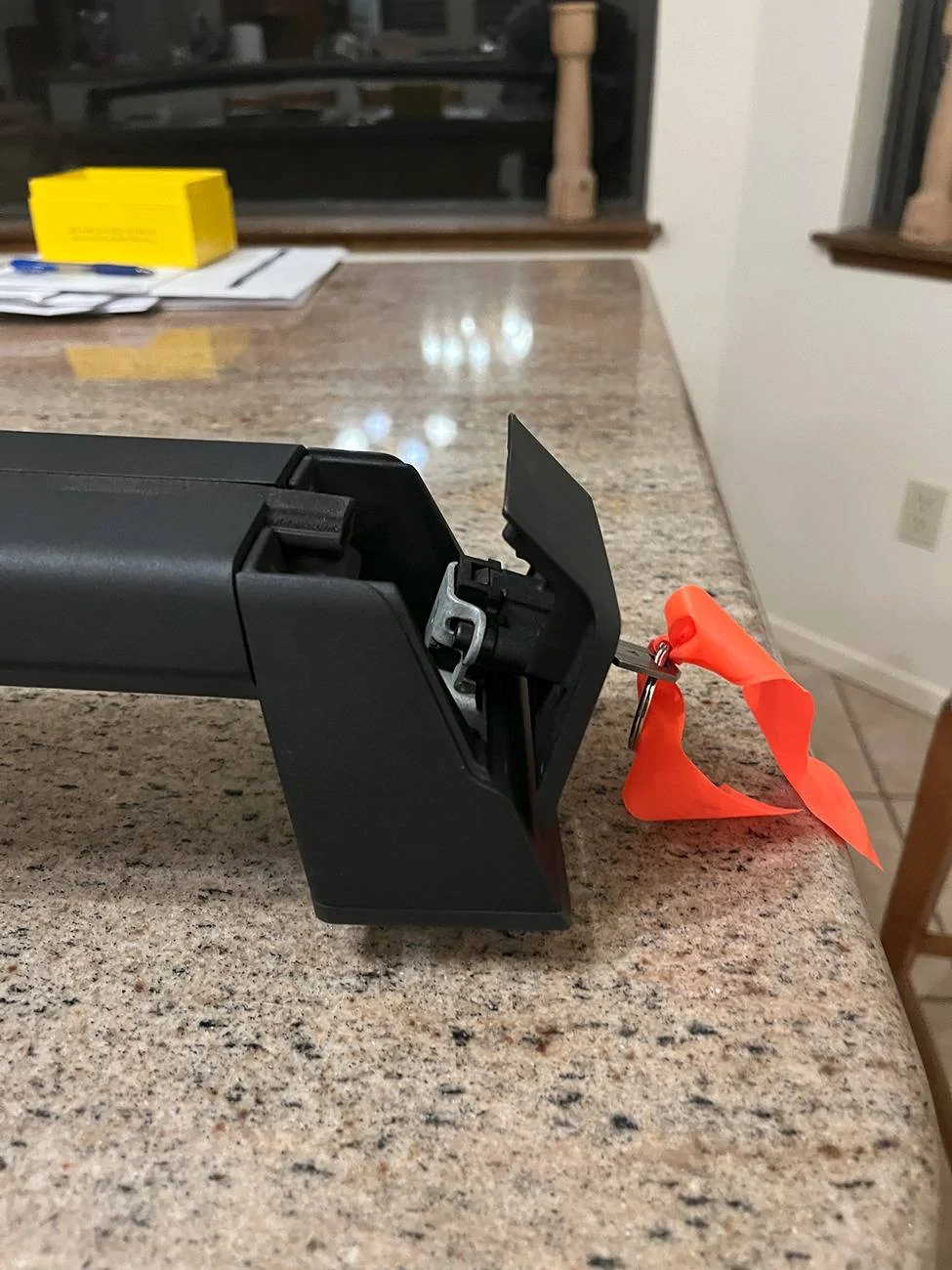

I don't suppose that anyone has closeup pix of the OEM crossbars: mounts, mounting, rails near mounts, rails at adjustments, etc.
Here you go:
1. Rack attached to CT
2. Rack unlatched and rolled forward 90 degrees. Note that the slot cover is folded up to attach rack.
3. Mechanism to attach rack. Turn key, fold side plate back, slip rack end in slot on CT, close side plate. Super easy.
4. Sliding mechanism. Friction fit, no bolts or tools required. Super smooth.
Rack on-and-off is easy, with only the key required. The rack mounts fit easily in their receptors. Closing the key-lid locks the rack down to the car. The width changes by sliding the rack wider or narrower to fit each of the four rack positions. No tools required.
The aluminum mount pieces are bolted into the slots on the truck; two nuts each, with a torque wrench included; took 20 minutes in cold weather and this task is only done once. Four mounts are included, so the 2 racks can be used in any position. Each rack is pretty heavy, about 20 lbs or more.

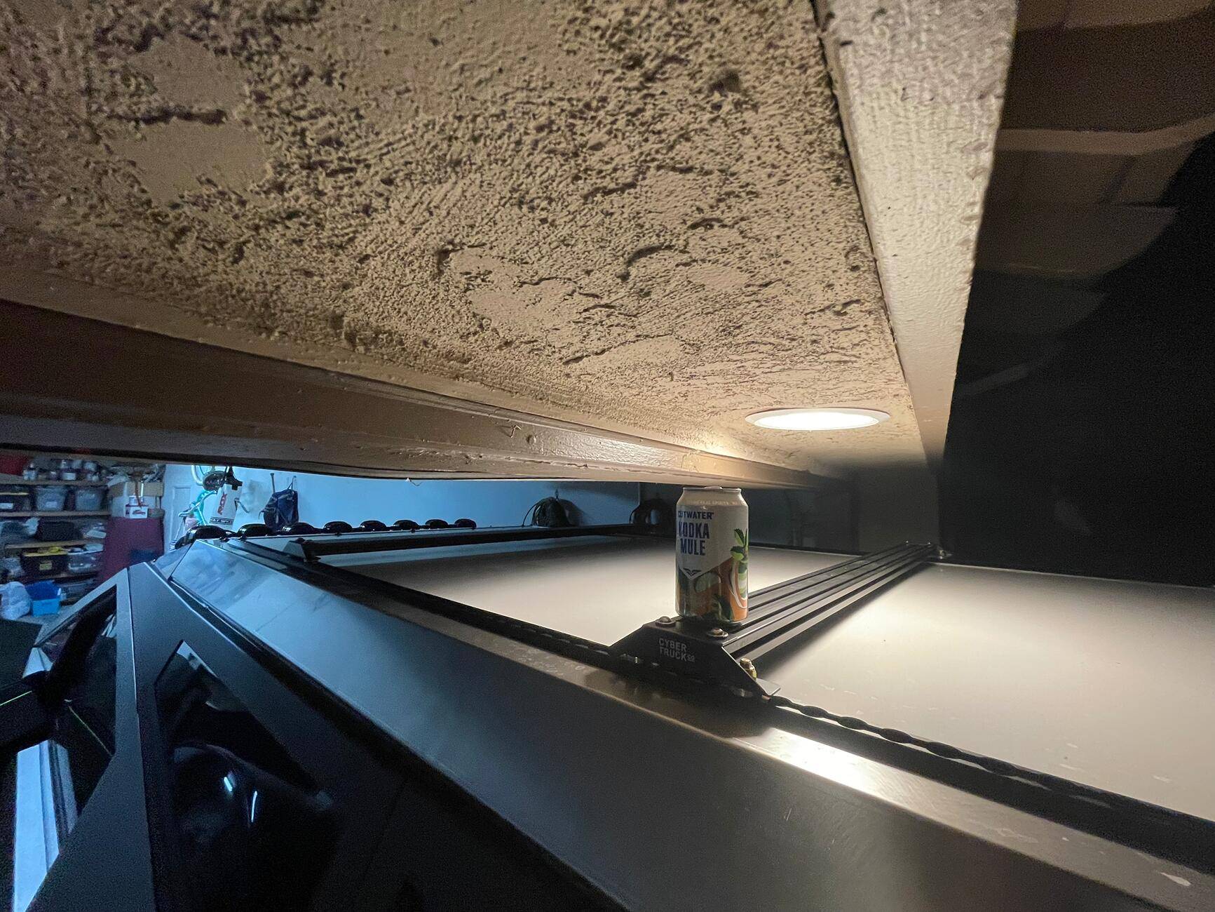

Hello,
Could you tell me what is the height clearance after you mount the spare as you have shown in the picture? Want to see if would meet clearance for parking garages and the home garage. Thank you.
probably about 6", we don't have that setup[ any longer, but it went in the garage no problem. Same with our Topper w/ Camper and top crossbars on it and our 1" lift.

Here is a photo of the CyberCamper with the top crossbars and in entry mode with our 1" lift rods you have approximately 5" clearance in a standard height garage door.
