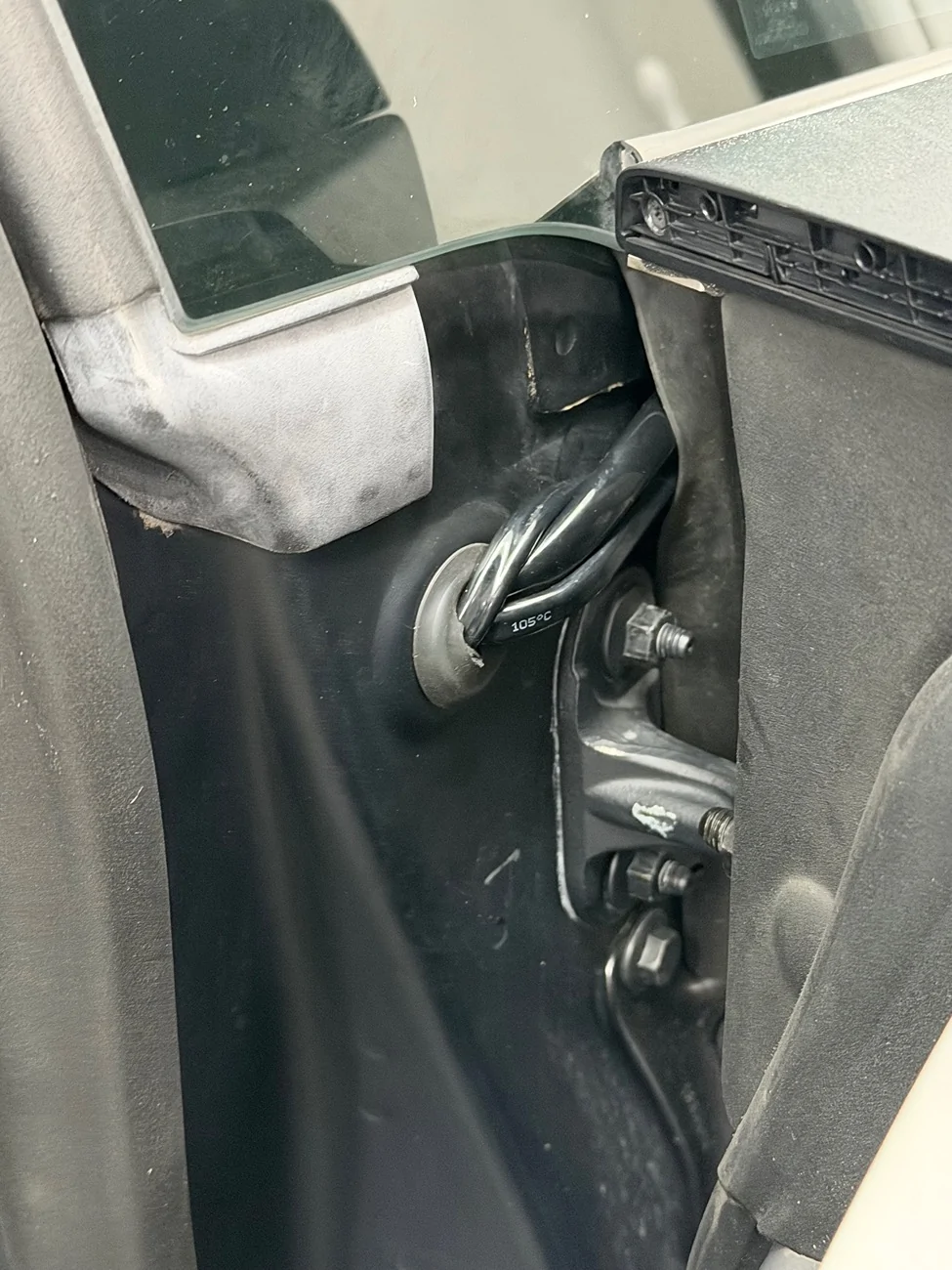

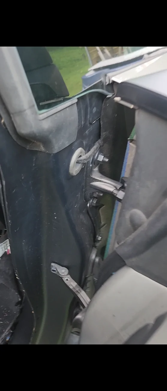

Many threads on this mostly about fridge power. The route I used was behind frunk=>behind passenger fender=>through rubber grommet into passenger side floor board
Use a wire fisher or long zip tie/coat hanger etc

I just did an install of the Auxbeam and fridge not long ago and this seemed to be the best route and the one almost everyone else took. Doesn't require any modification other than punching a hole through the rubber grommet shown in the pic above. I took the added step of adding some silicone around the hole where the wire passes through, but I don't know if thats even necessary.

Mine follows the same Route. Not too hard to do.

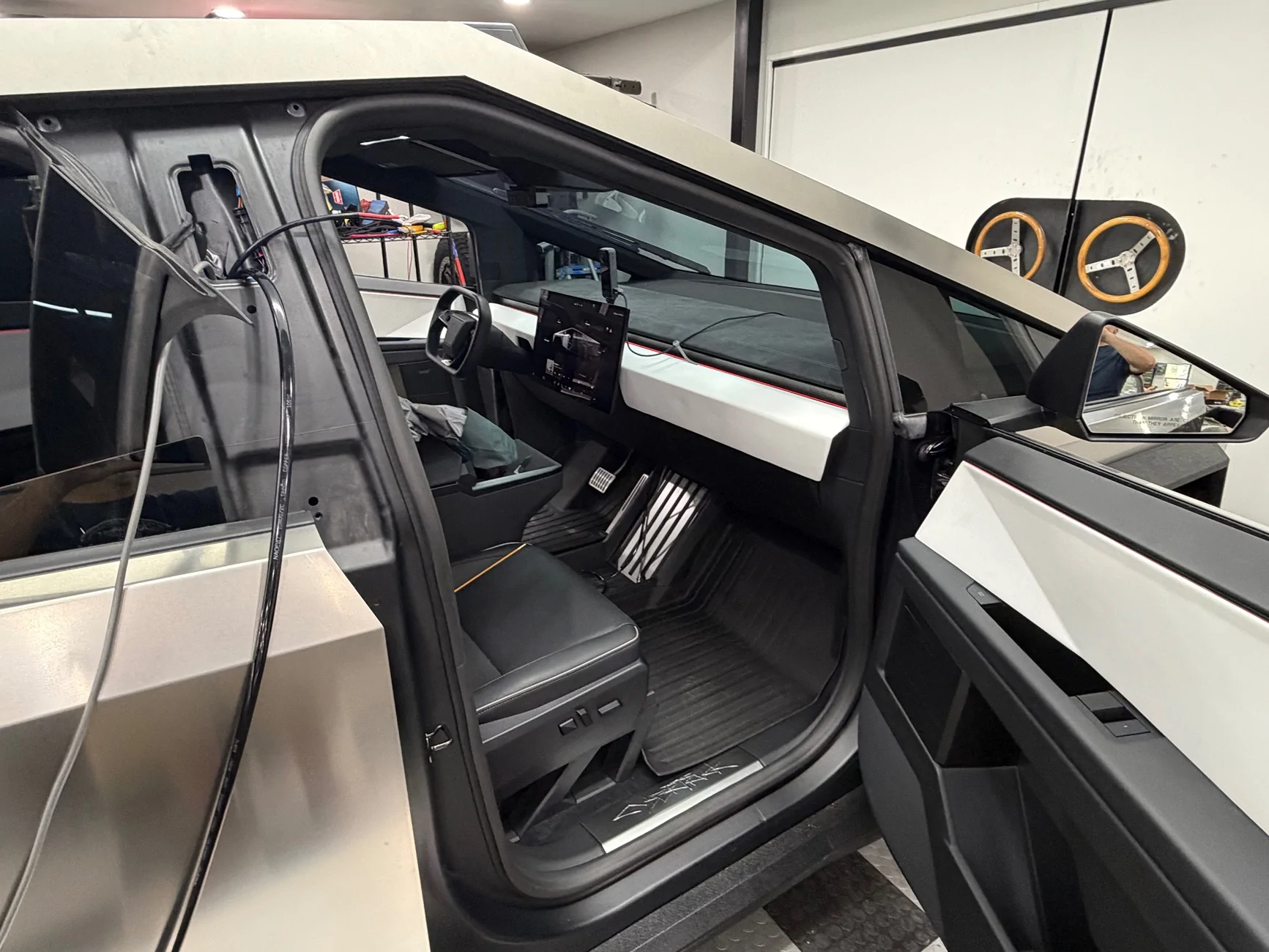

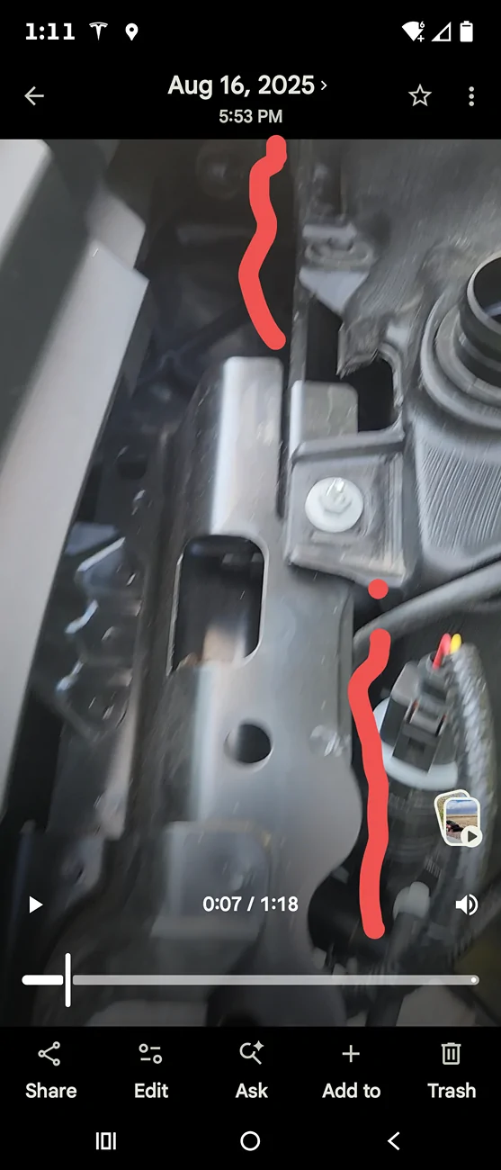

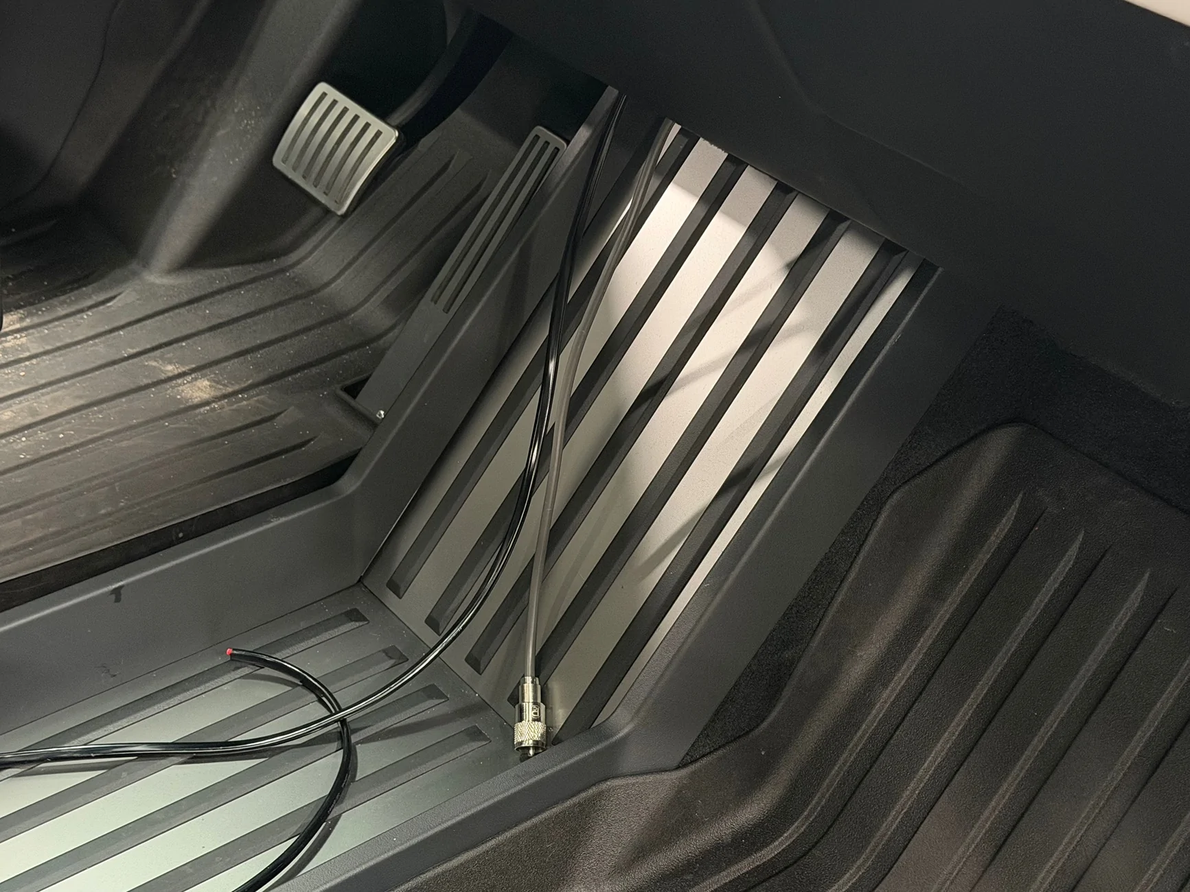

Mine were run the same route, definitely the easiest. I did 3 runs through it from my 12VDC high current winch battery (mounted in the frunk): cabin power (CB), power to my second light bar, and a 30 amp run all the way to a sub panel that I had put in the very rear compartment of my gen 2 Urander top (for 12VDC camp lighting, the bumper reverse light bar, and some auxiliary 12VDC and USB camp outlets).
